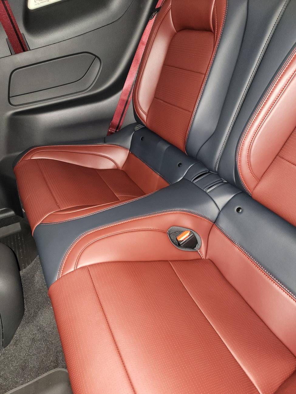

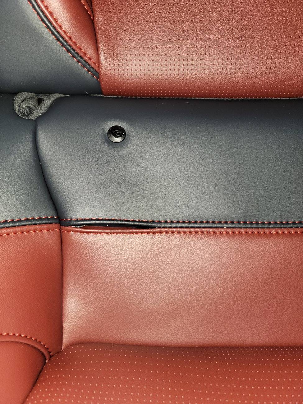

Make sure the backseat does not have a small rip between the seat cushion and back rest. I found this a month later since the back seat is so small I never was back there
till I cleaned it yesterday. Good luck, and congrats on your new stang!
Just a heads up, that split isn’t a defect. Its for the LATCH car seat installation. There’s a metal hook inside that slit. Take a look at the black dot, there will be a slit beneath each of those black dots.
Awsome! I can let the dealer know it's not an issue. He offered to make it right from the start. Thank uou. You saved us a lot of time.

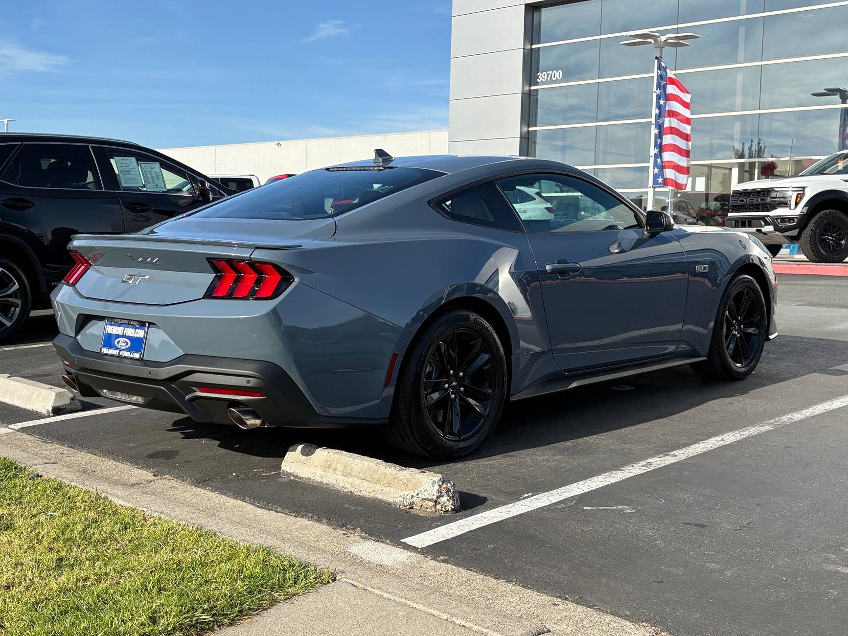

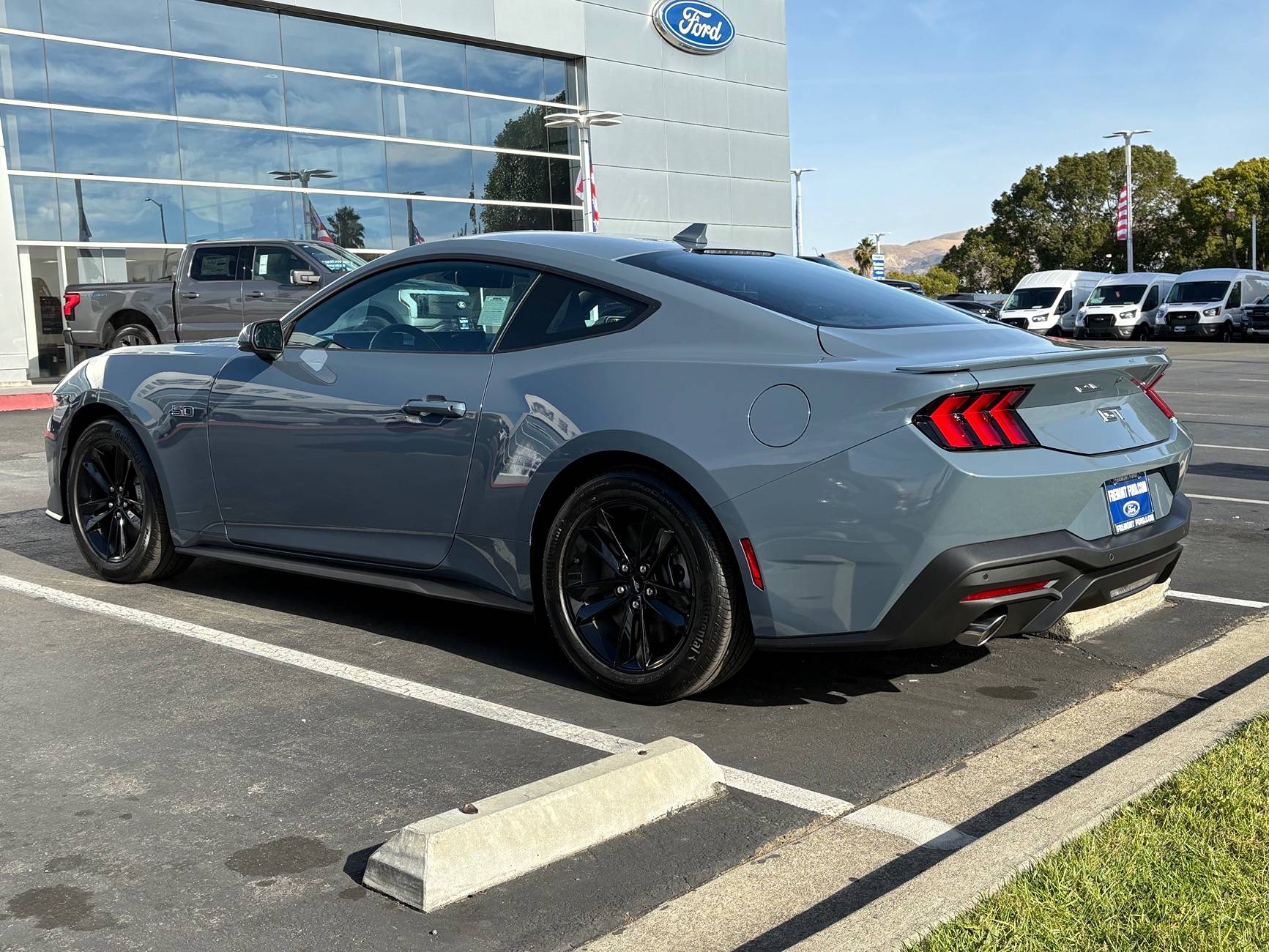

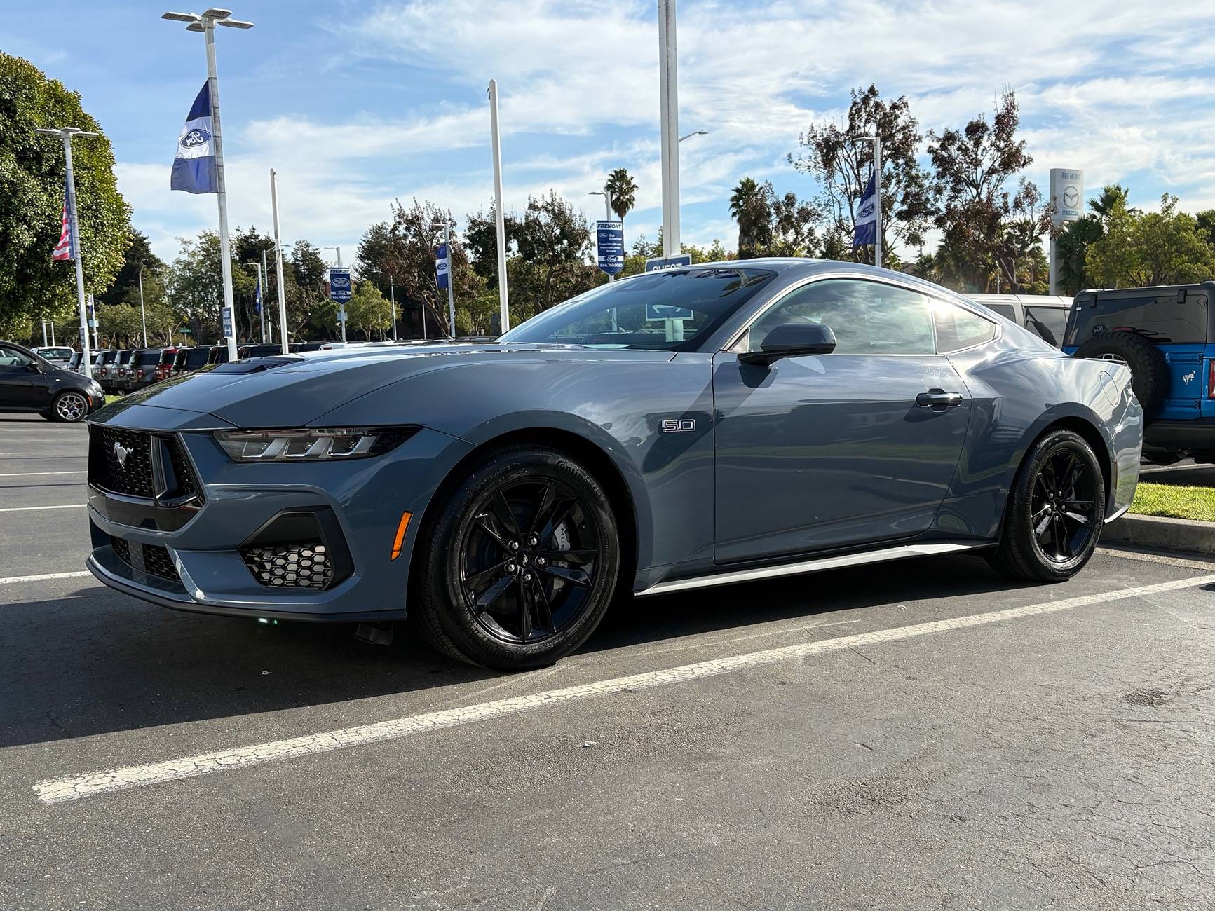

Folks, the car delivered today. All points you made were addressed. I appreciate it.
Some pictures of delivered car as promised.
Those are not rips. There are 4 of them. They are anchor points for child seats.
