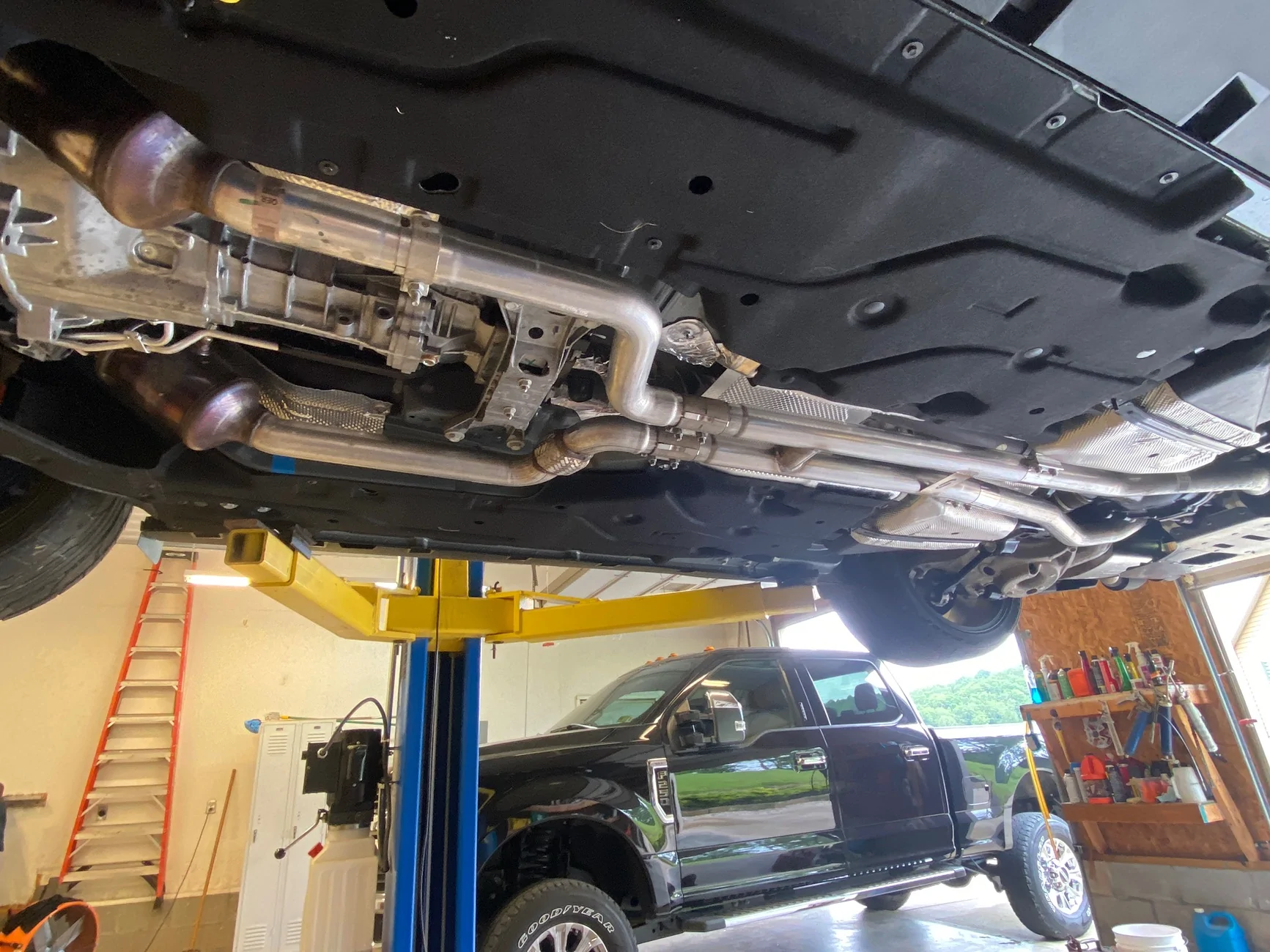

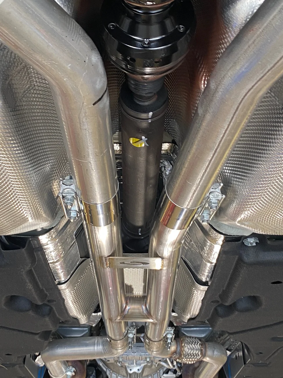

Mine is 2024 Blue Ember appearance and handling package, 700A with the tremec. Car was made in 9/24, stickered 76,705 I paid 72,810 in 4/2025. I added the Steeda H-pipe (used the standard clamps with no issues in more than 2500 miles). It sounds great in every exhaust mode. I also have the SOLER throttle controller. I may remove the carbon traps next and add stop the hop. And then long tube headers and whipple by spring. It’s a pleasure to drive — is on a rail and is fast and comfortable. I like the recaros A lot. Badass hotrod.
If you are going to add headers, get rid of that 2.25" reduced pipe diameter right ahead of the H pipe. No reason to add free flowing headers but keep that pinch in the exhaust pipe.
