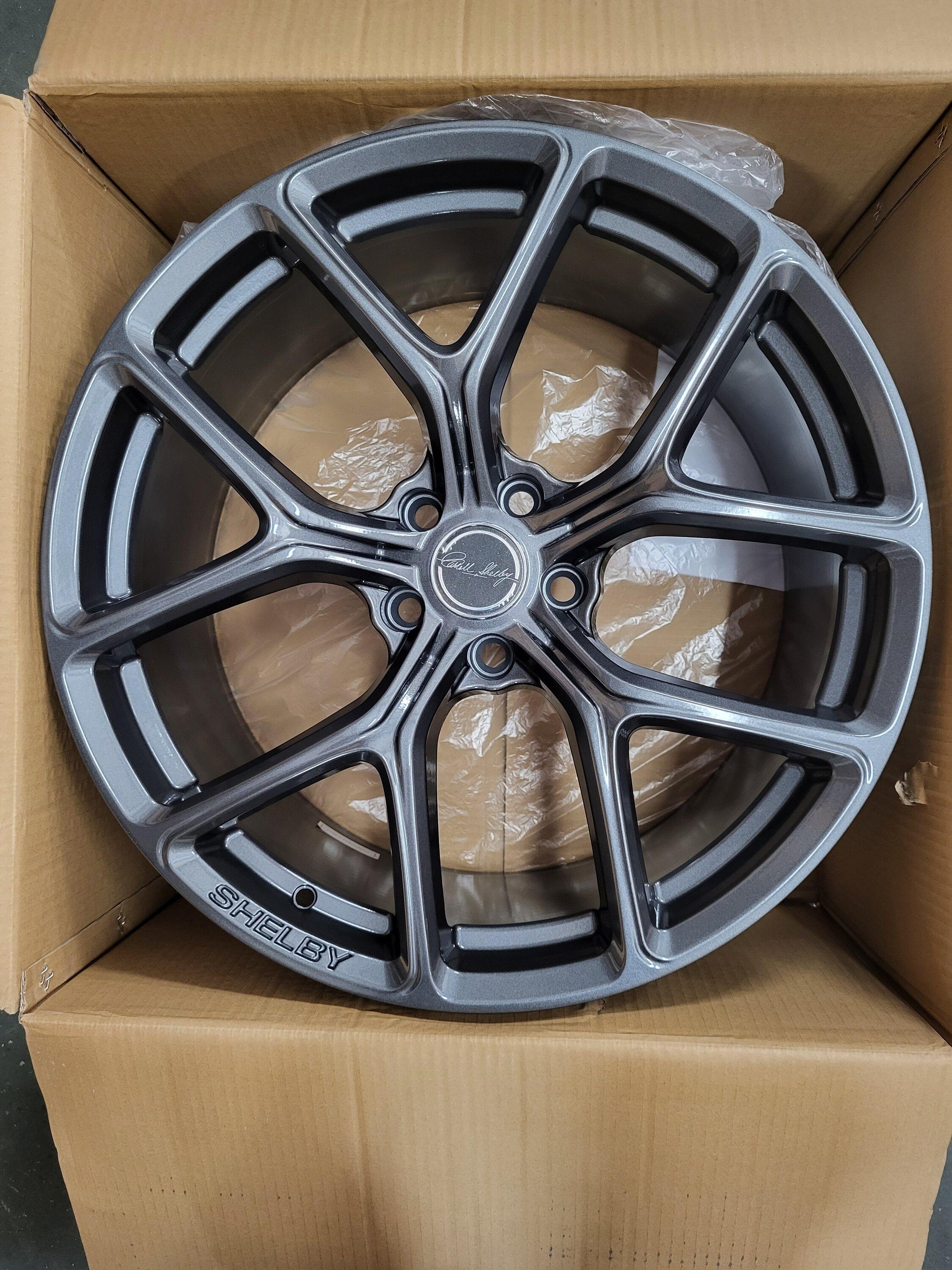

Got these Carroll Shelby CS-3 wheels 20x9.5 F and 20x11 R. Now I just need to decide on tires.

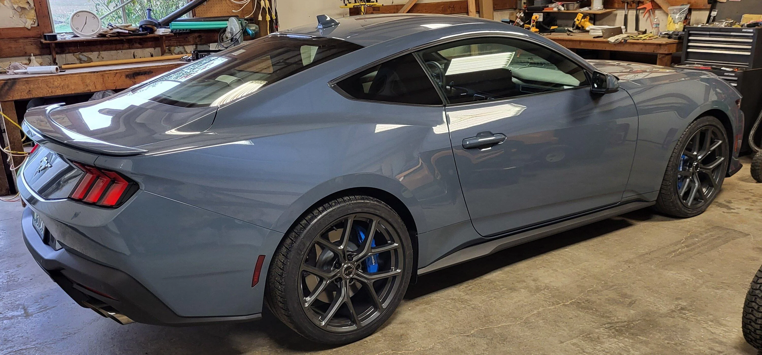

I ordered Continental DWS06 tires in 265/35-20 F and 305/30-20 R... but the rears were on backorder and not expected for two months. I can't be driving on the summer only tires in December, so I got some Pilot sport all season 4 tires instead.
Might be a little more expensive than the Continentals? But well worth it, IMO. They stick very well and run very quiet. I've been impressed with treadwear too. I wondered how they can be stickier than Pirelli summer tires, but also last longer. Michelin just has a great compound.

The milage warranty is a bit less on the Michelin. I had the PS AS3+ on the S550 and they were great... currently trying the DWS06 on S550 to see if they get a little longer life on the wife's daily driver. I am sure I will be happy with these as they are supposed to be an improvement over the AS3+.
