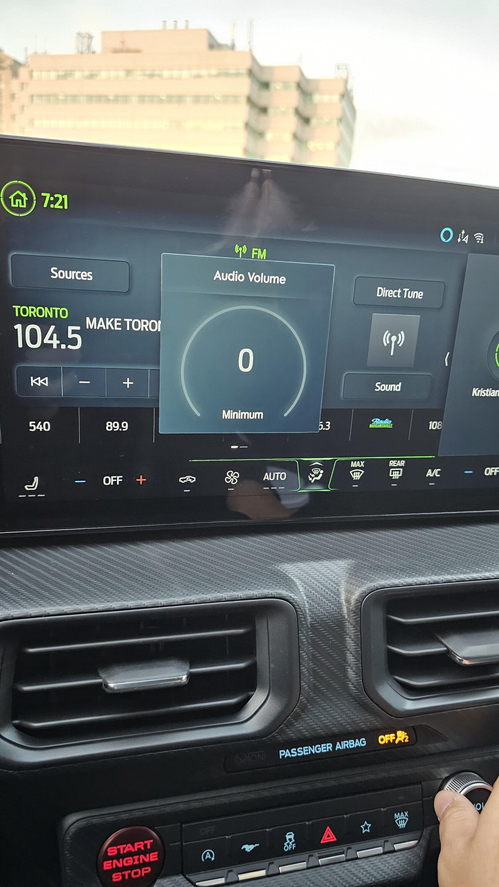

Hello everyone, I recently got my s650 ecoboost 3 weeks ago. There are some times that my audio/volume will be totally gone. The music/radio is playing or working but when I turn the knob on, the volume stays on 0. I called the dealer and they told me to bring it in. But sometimes the audio comes back before the appointment. Any thoughts on why is this happening? Has this been an issue even with previous generation? Thanks alot!

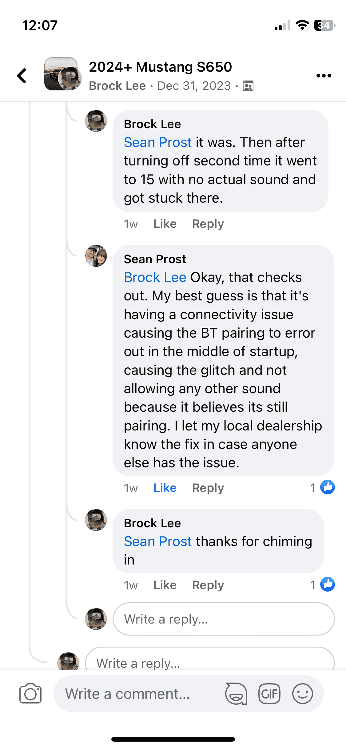

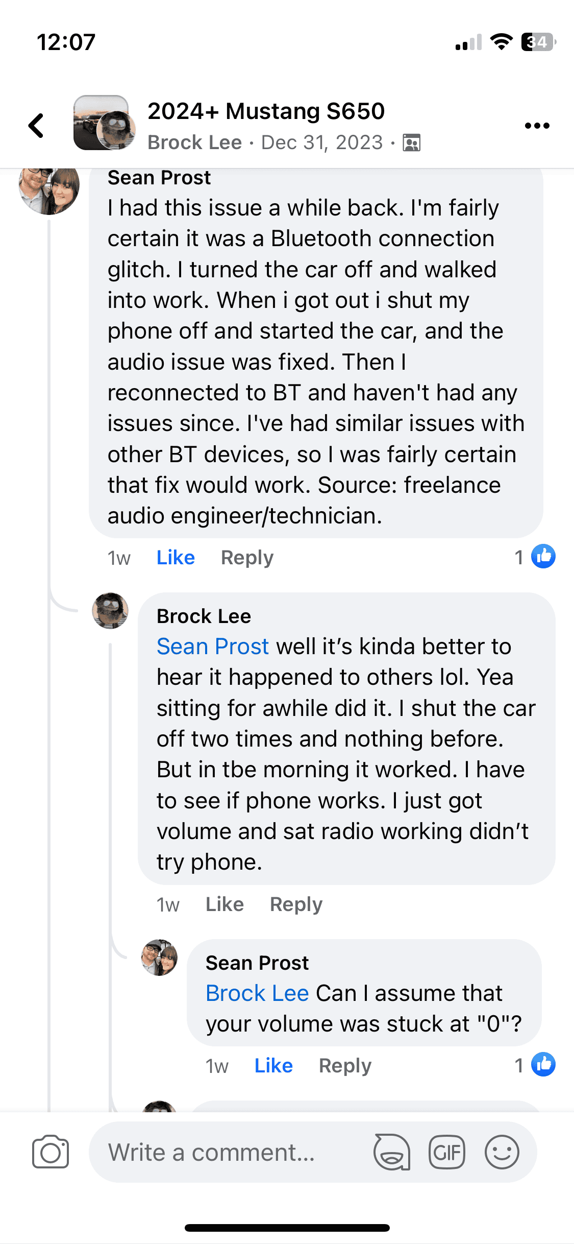

Happened to me. I had a loud beeping sound then a pop sound first though. It didn’t start working until the next morning. Haven’t had an issue since. Someone posted in my post about it on FB on one of the S650 pages and believes it was something to do with the Bluetooth connection. I reset it all even though things came back. Maybe worth a shot.
highvoltage
Jan 4, 2016
706
325
NorCal to SoCal
2024 Mustang GT 6spd
Here is the convo

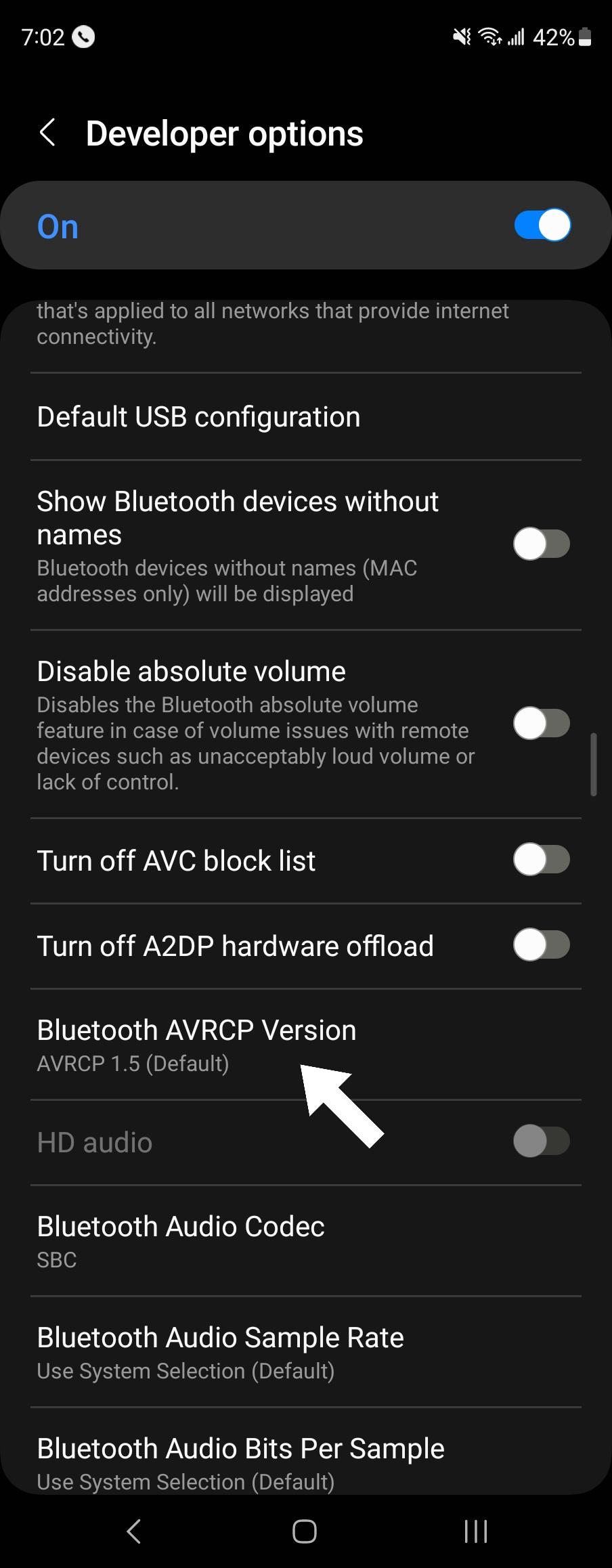

I had this issue because i had bluetooth AVRCP version set to 1.6 instead of 1.5
