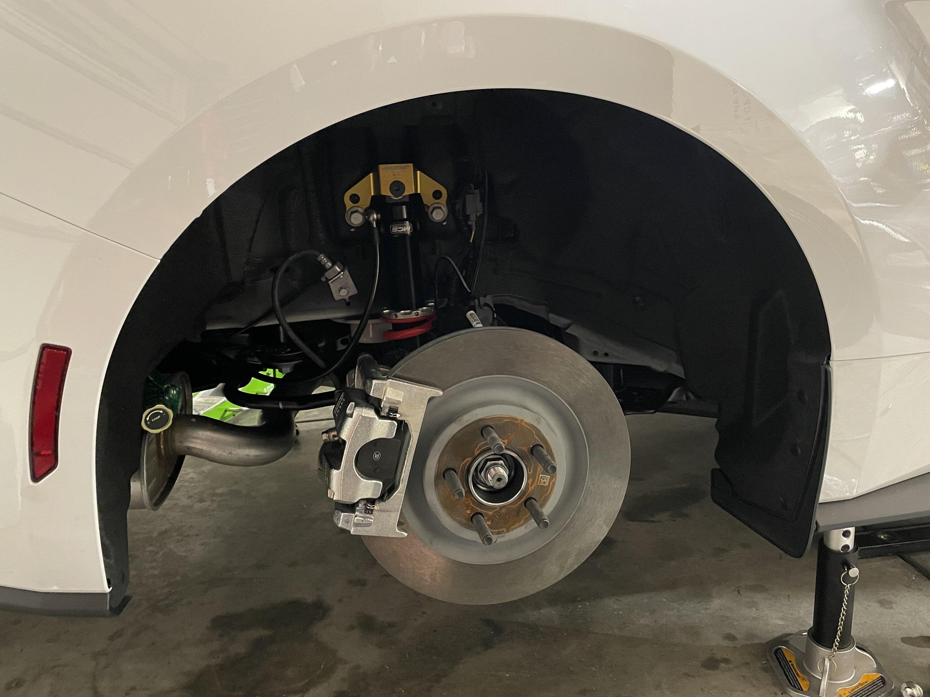

In preparation for Track use MMR installed the new MMR/MCS 2 Way Adjustable Coil over kit. This kit features full ride height adjustability along with adjustable dampening. These Kits are available from MMR now in 1-4 way adjustable options. This is a Base GT, so keep in mind Magneride options will require the Magneride delete modules (also in stock).
We also added the MMR Adjustable Toe Arms and Camber Plates to give some additional adjustability.

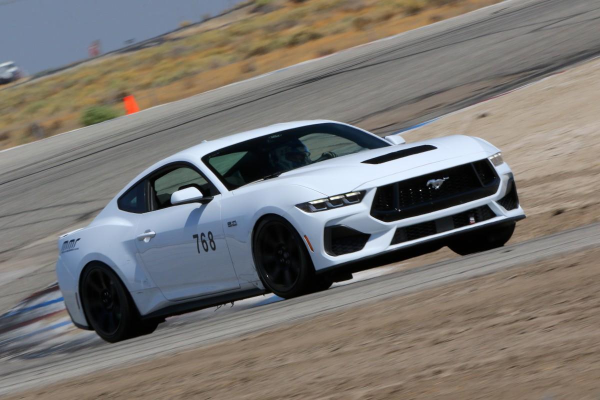

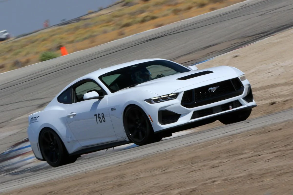

Our review: We took the 24' to Buttonwillow Raceway for the Mustang Drivers challenge (Time Trial) where we were able to get some laps in. First impressions are greatly improved handling (primarily due to the lower ride height/center of gravity and adjustable dampers) The ride while firmer was much more predictable.
For those wondering the wheels are Factory GT350R (Carbon Fiber) - no spacers. We have Installed MMR Extended rear studs and GT350R extended Front studs to make them fit due to the thick hubs.
Unfortunately the car suffered from overheating issues so we were unable to really push it. We are working on a oil cooler kit now which should be available shortly.
