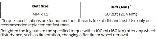

I used 170 ft lbs because it was suggested by a Service guy at my local Ford dealership. However, just last week I had new wheels/tires installed by Discount Tires. I had asked what torque rating they use, One counter guy and one installer both told me 150. What is it supposed to be?

150.

Thanks for posting. I had a screw patched up last week and just saw it was torqued to 110 when reinstalled at a local tire shop. I'll get that remedied today.
S650 Mustang Lug Nut Torque Setting 1753701970555-gn

When Ford went M14 x 1.5 torque changed to 150ftlbs. Before the change the studs were smallar torque was 100ftlbs. For all those who don't use a torque wrench its not smart no matter how great you think you are.
