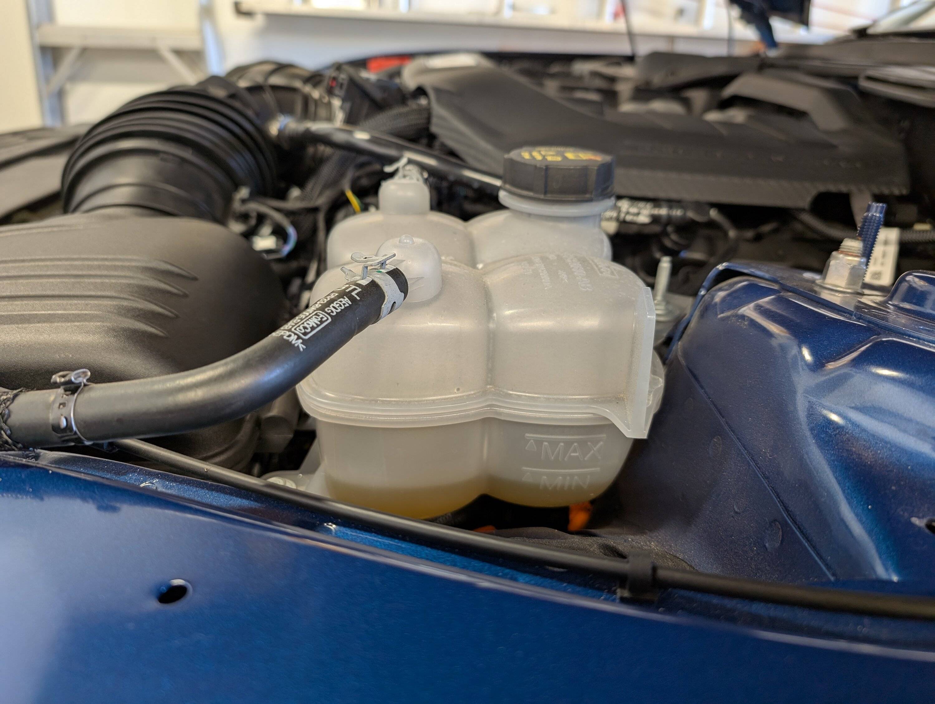

The owners manual sez, 1qt coolant loss a month is Normal..
--If you have to add more than 1.1 qt (1 L) of engine coolant per month, have your vehicle checked as soon as possible.--
I don't agree loosing 1qt a month is acceptable either, there's leak IMVHO.

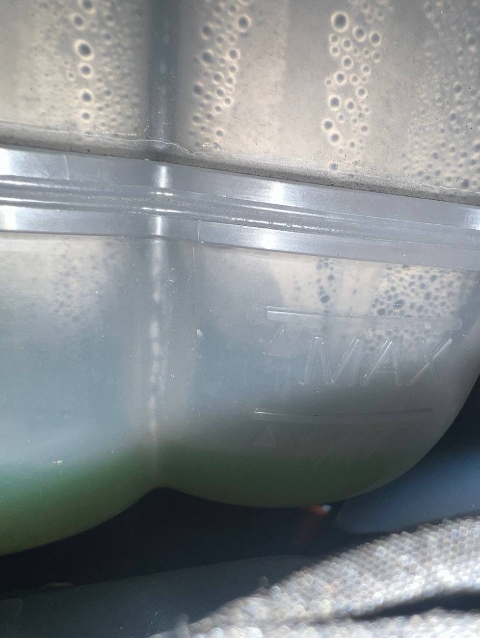

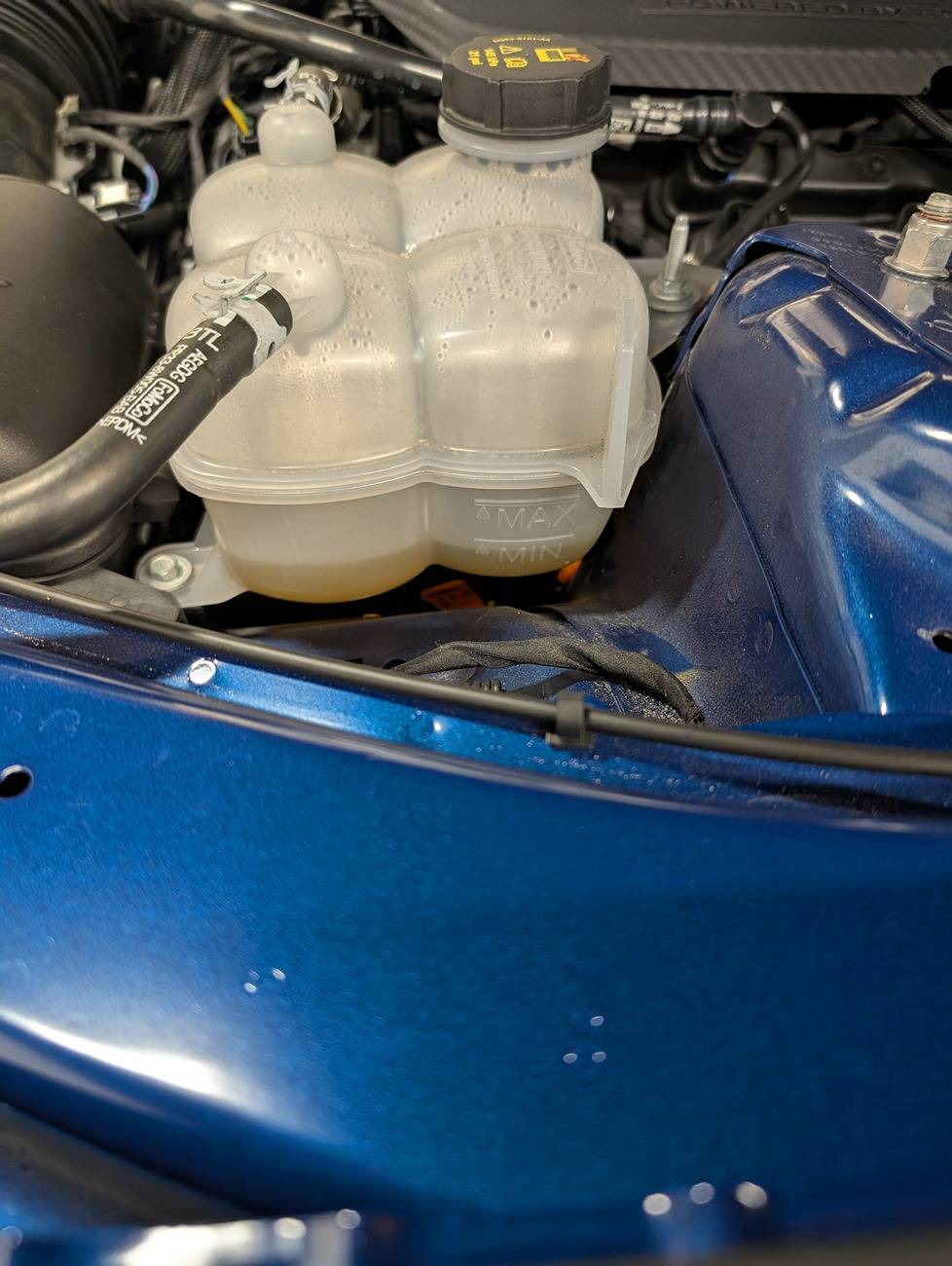

I've got 20K miles on mine and the coolant level was right on the min line when I bought it and has dropped about 1 finger width below the minimum level line over the past year,
I have gotten a whiff of coolant occasionally but haven't seen any signs of a leak, with that small of a loss it'll be hard to find a leak, it's most likely evaporation from the reservoir.
Wow I haven't seen that in the manual about 1qt of coolant loss in a month being normal and I agree that seems crazy. I am going to keep an eye on my coolant level like a hawk for sure. I wonder if it's ok to keep driving it where the level is at on mine (in the pics above)? It seems to have stabilized at that level and I have just under 6K on the vehicle now coming up on (1) year of ownership next month. I'm hoping the coolant level comes back up on it's own with the arrival of the warmer weather here but I guess we'll see.
