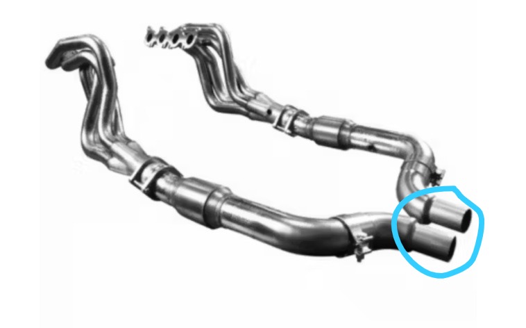

I´m running the AWE catback (3" all the way down") and the LTH comes with connection to the OEM catback.
Do anyone sells a connection pipe to a 3" catback?
