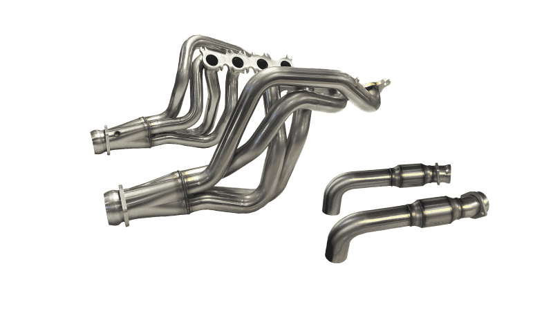

You want the bottleneck eliminator or 3" connection (each vendor calls it something else). Or have the exhaust shop modify it

I want to connect the header to the 3" catback so I guess the same pipe as on the picture but without the bottleneck part?
