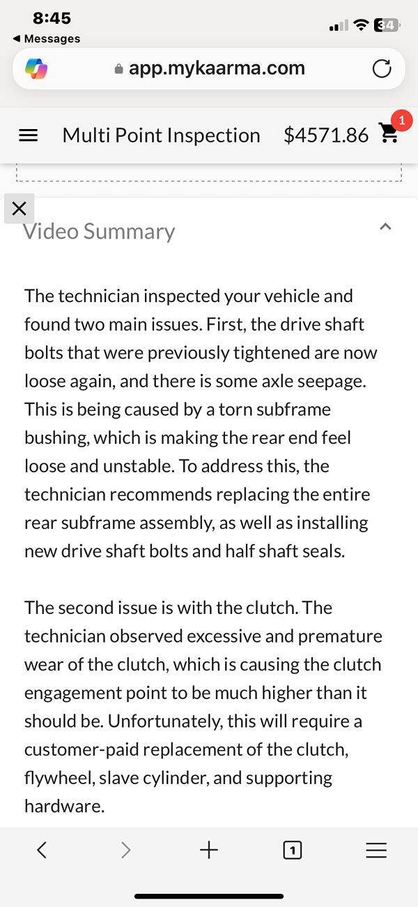

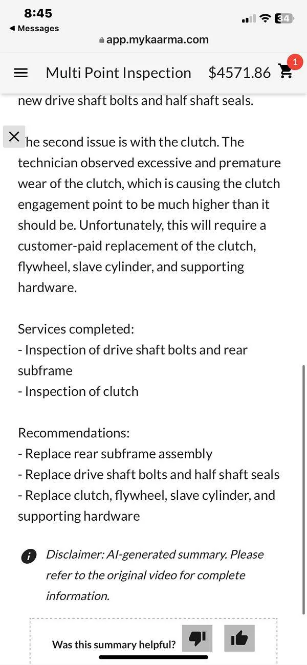

Issue after getting rear axel and hub replaced. Dealer refuses to diagnose.
n_123
Jun 11, 2024
75
55
2024 GT
So a couple weeks back I posted this thread about excessive play in the rear wheel along with a clicking from the rear end. Come to find out there has been a TSB out for quite some time on this and they replaced the rear axel and wheel bearing free of charge. I pick the car up and the noise is gone, great!
A few days later I finally get the chance to hammer the throttle a little bit. As soon as I accelerate, the cars rear end feels completely disconnected, it feels like the subframe is moving side to side independent of the body. Mind you this only happened AFTER the dealer replaced that side. It was very unsettling.
I take it back to the dealer to which they tell me they can’t replicate it because they can’t drive it like that (understandable) and they insist that they rechecked torque and everything was good. They also ended up replacing the other side’s wheel bearing and axel as that was making noise too.
Obviously, since they didn’t do anything the car is still doing it. My question to all of you is what could be causing this? Alignment get screwed up somehow (I asked this and they insisted it wasn’t possible)? Should I go under there and check torque myself? At a loss.
