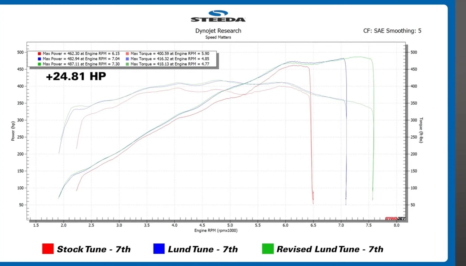

That steeda vid they just posted should frame it all up…
Ported heads, ported intake, longtube headers, steeda CAI on full E85 …. Gained 25/20ish over stock tune.
YMMV as they say.
Link please, is that peak or median. Improving peak isn’t the point, making fat the curve is the desire
