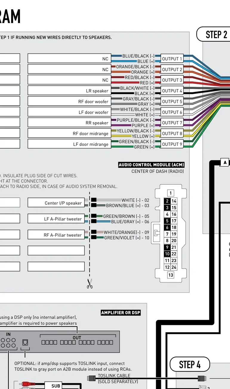

I found this but cant get clarification.
Are the door mids wired in parallel with the A Pillar tweeters, as indicated here?

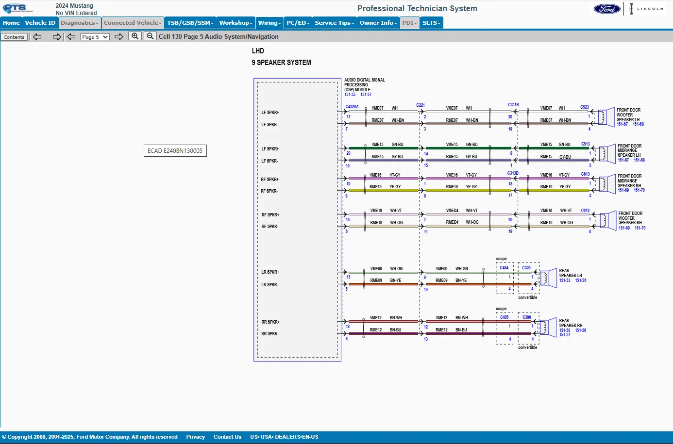

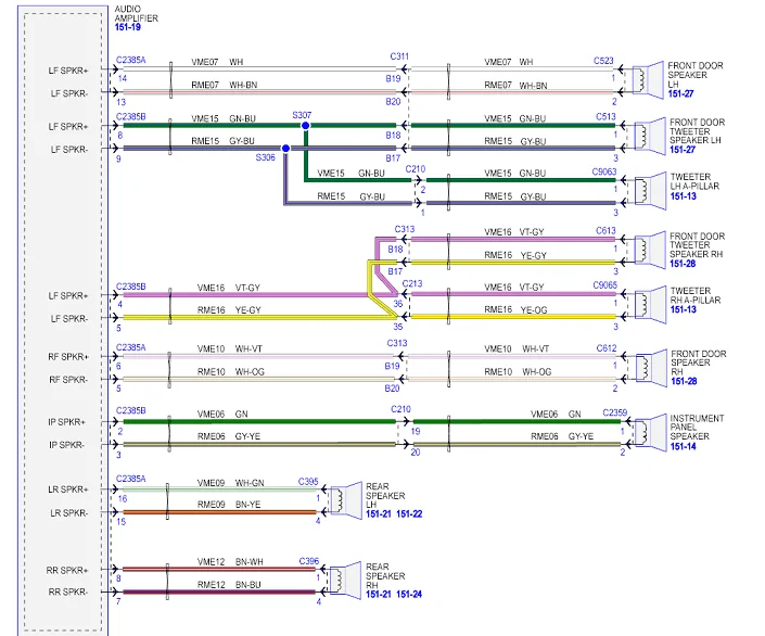

This is what PTS shows for the 9-speaker left-hand drive config. I assume that some of these are 2-way speakers where Ford counts them as two speakers instead of one, because it only shows a total of 6 speakers wired to the DSP.

Interesting. On the 9 speaker, in my car, i have 9 distinct drivers.
1 - Center Dash (IP)
2 - L and R A Pillar Tweeters
2 - L and R Upper Door 3.5” Midranges
2 - L and R Lower Door 6.5” Woofers
2 - L and R Rear Quarter Pannel 6.5” Full Range (non 2-way)
From what I understand the B&O has 2-Way speakers (Woofer with separate tweeter) in the rear, plus a Subwoofer, making 12 speakers.
I just bought the Maestro A2B amplifier replacement inteface + AR-FO5 for 18 UP Ford Vehicles. It’s wiring guide confuses the issue for me.

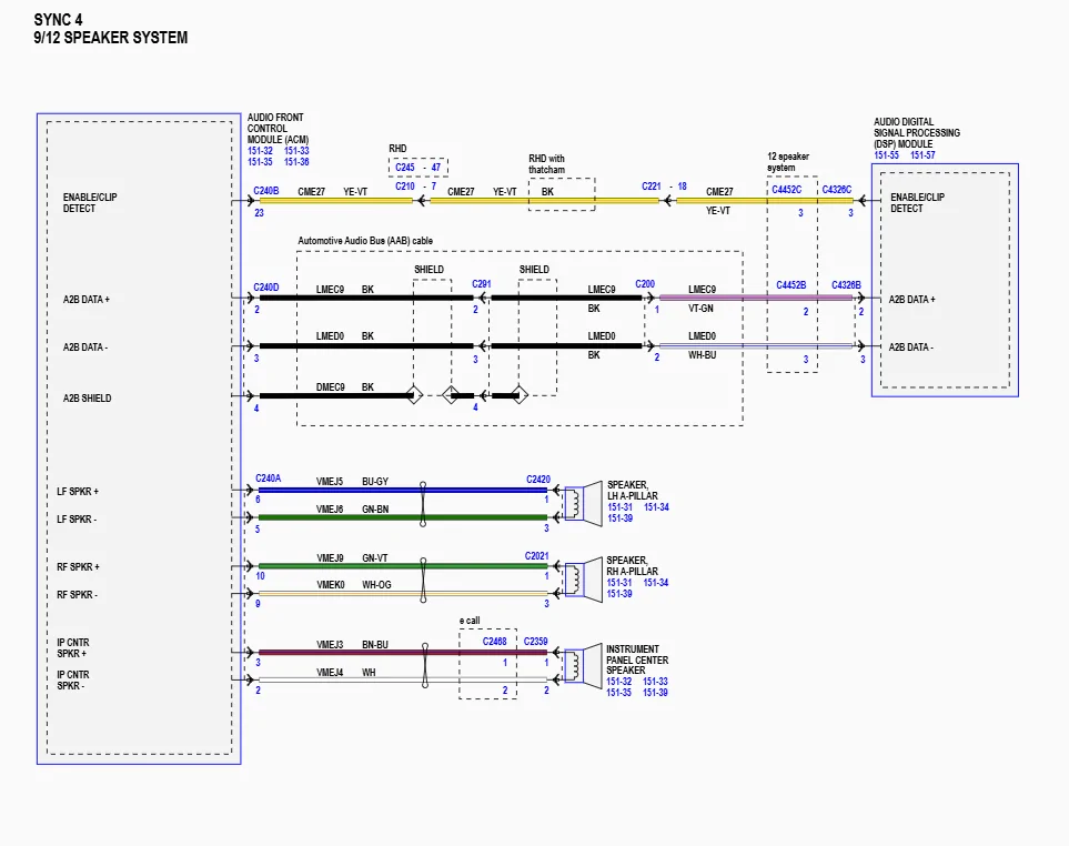

I think I found it. The other 3 speakers in the 9 speaker system are powered by the ACM.

Ah, now that makes some sense. That means the tweeters and center will have to have new wiring run from the amplifier I am installing in the trunk. The ACM, that is built into the head unit of the car, correct? it does not run to the amplifier in the rear of the vehicle?

Thank you so much for all of this information. Very helpful.
i am going to bypass the ACM for those speakers and run new cable. I have an 8 channel amp with full DSP so I can just “roll my own”.
