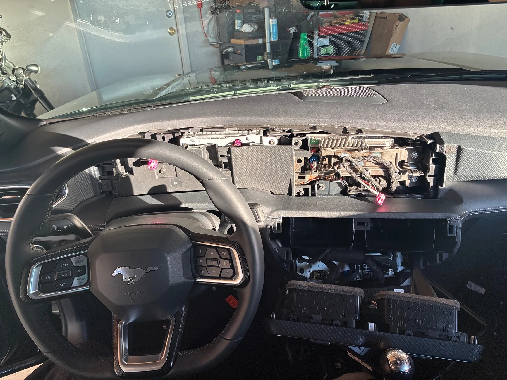

This video is inaccurate for the 2025 S650…. I am literally in the middle of installation and the center stack is different.

Does anyone know how to remove the center stack on a premium?
Not sure what to tell you about that, aside from mine being a manual vs the car in the video being auto, the video was 100% accurate for my installation of the perimeter plus module.

Ok that is strange. I have a premium with the 400A package. What’s your trim level?

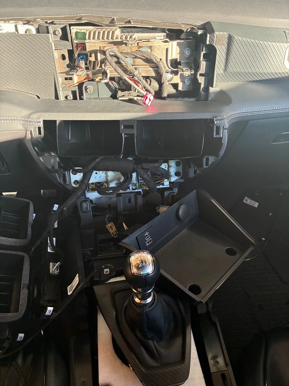

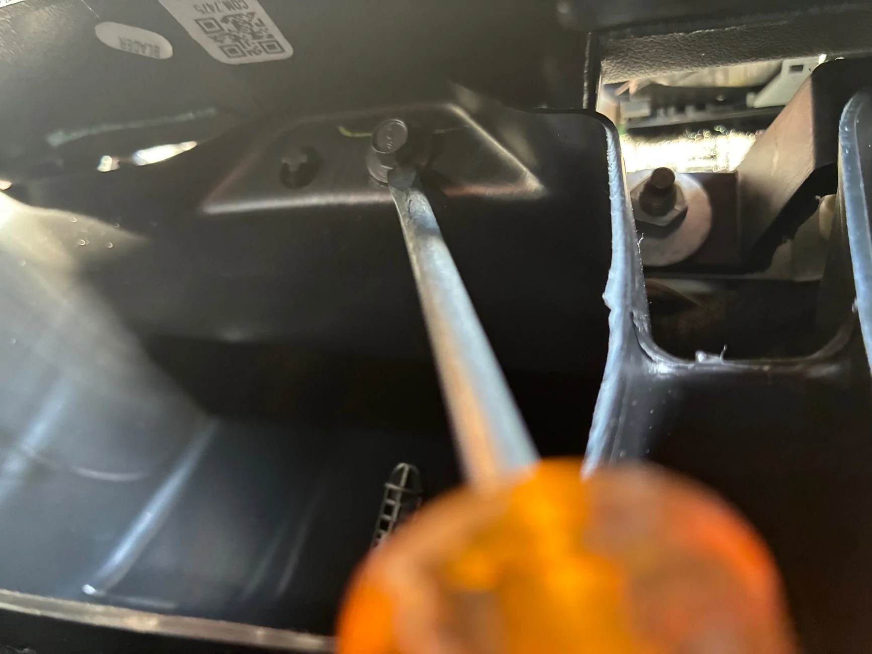

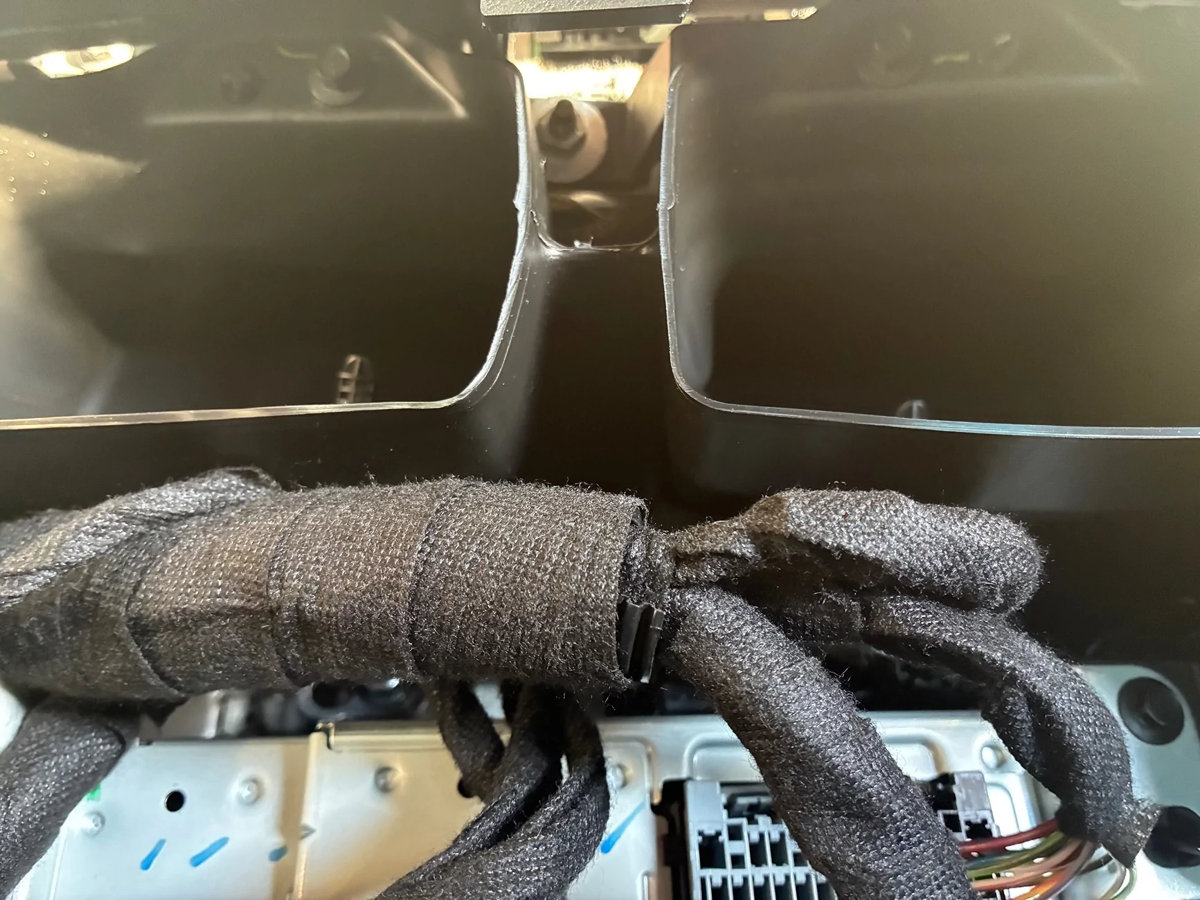

Not sure if you can see it in the pics but the center stack was held in with clips vs. the two screws at the top, per the video and the a/c ducts have male fasteners stick up from the bottom which secures a wire cluster beneath the ducts. However, I examined a 301A same year and it appears to be the same as the video so again, the 2025 with the 400A package seems to be a bit different but the video claims to be accurate for ALL Mustangs. 2024+ so I’m a bit lost and frustrated…

You still have to remove the two screws (one of which you are pointing to with your screwdriver in the first photo) holding the A/C ducting (behind the vents), and pull the duct out, to access the wire connector that the perimeter plus wiring hooks to.

Oh yeah! i see what you're talking about now. The dash is actually a little different than that from the video. Yours goes all the way across right above where the vents are, whereas the video and mine did not.
