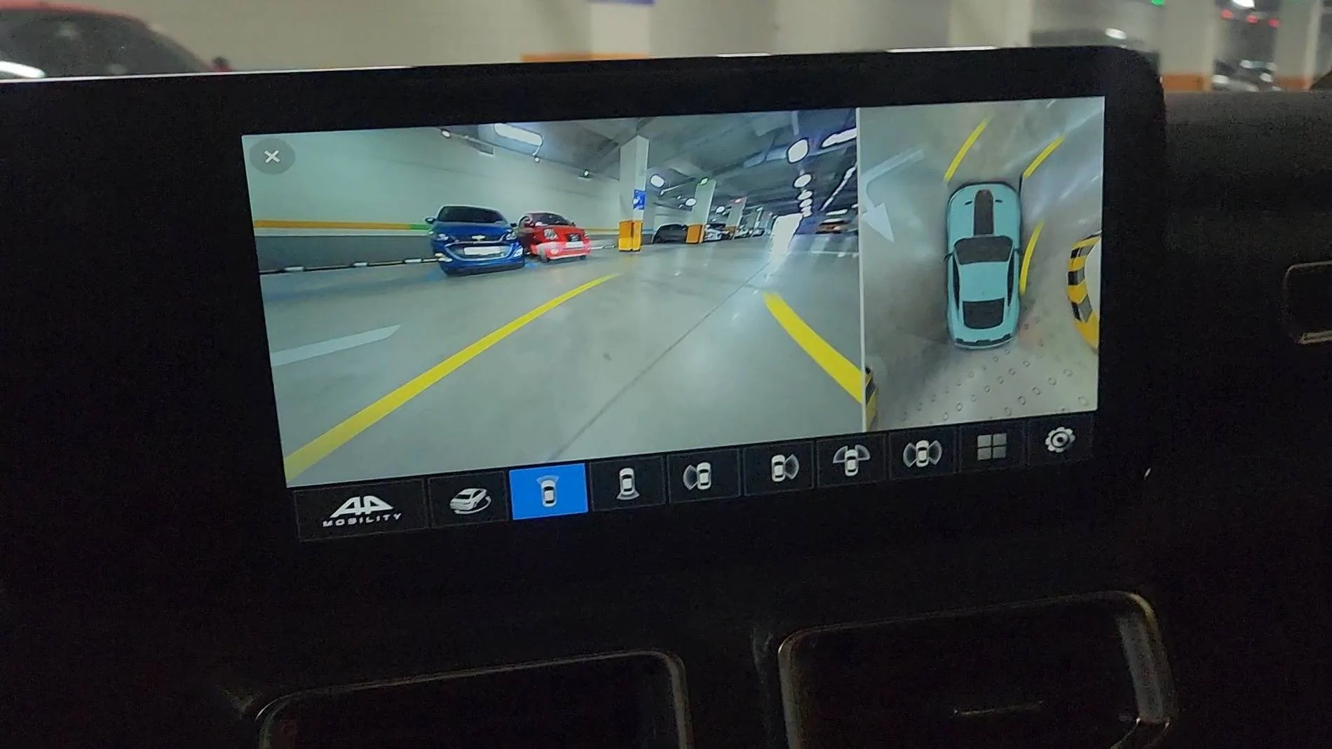

if you really want to , i might get one for you, if you can install it
I tried to translate the website and it did a good job. But I have no clue how the install look like, so I'm really interested but is there more information about how it is installed and how it works with the screen?

The Korean website prevents Google auto-translation, and has a left and right-click disable.
Can't be bothered with it. :curse:

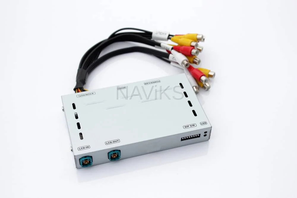

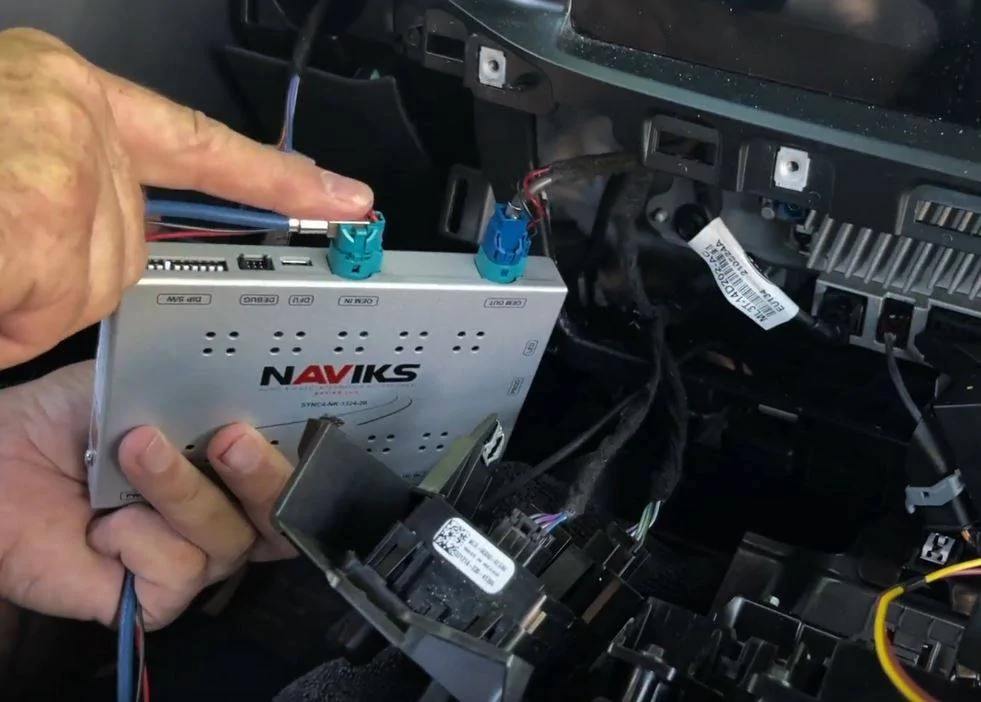

One thing that is evident from NAViK'S F-150 install video, is the Sync 4 screen connectivity is not straight HDMI (which would make it a piece of cake to tinker with).

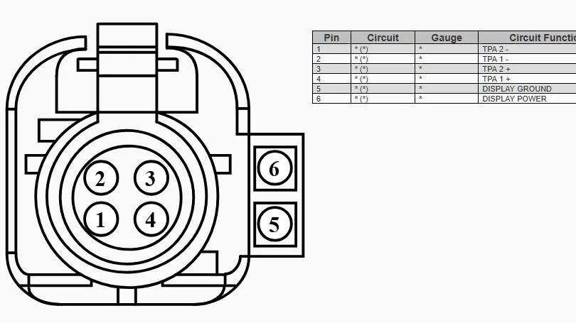

@roket can you see from what documentation you have access to, how the 2024+ Mustang's screen connects? Is it the same as the F-150 Sync 4? It should be, but!
2,681
4,067
...@roket can you see from what documentation you have access to, how the 2024+ Mustang's screen connects? Is it the same as the F-150 Sync 4? It should be, but!
2024 Mustang connector for the center screen, the same connector is also used for the instrument cluster screen

looks like the 2024 F-150 uses the exact same connector with the exact same pinning for "Display Unit"
