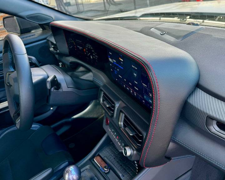

Saleen has a cover which surrounds top and sides of the infotainment and helps guard them from the blazing hot sun šŸŒž. Maybe they're available. If not they'd definitely make a mint off of them.
Deleted member 63380
Guest
Saleen cover. Available in with just about any color stitching your heart desires. Mustangs should come with these. They're a no brainer.
I wonder if that will hold the heat and not allow for the electronics to cool. I would be wary if something went wrong if the warranty would be voided. I checked it out its over $1000 I think I would ask the dealership before buying it at that cost but it is a great idea if it doesn't harm the infotainment center.
One penny under one thousand dollars at Saleen. Seems an addiction of little fans, like they use for car amplifier boxes, would be a great idea. The dash does get extremely hot. Which makes me wonder how long the S650s will hold up. I left my phone in the sun once and the thing went blank. It worked on e it cooled off. Maybe a little A/C piped into the cover would help keep them cool at least while driving.
First of all, that cover is hideous and obscenely expensive. Second, it won't do anything that a quality sun shade can't do for direct sun exposure while the car is parked. Thirdly, it will do absolutely nothing to keep the temperature down inside the car, which is the concern here.
