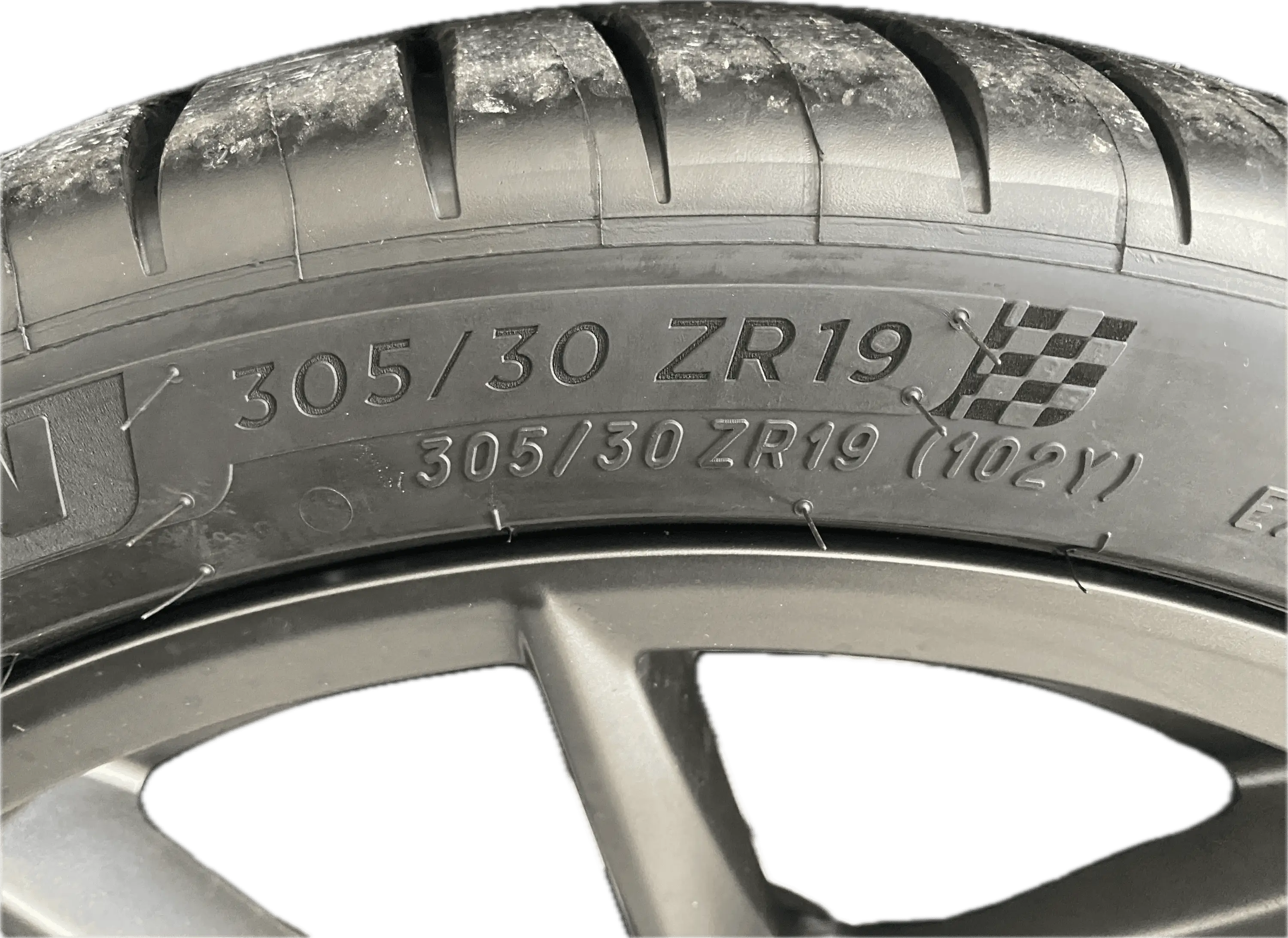

It is the correct size for the front!! So what could be wrong???

turned each lug 13 times for front wheels,
that's fine. Absolute minimum engagement is 6 turns - not that I would ever go that low for WHEEL nuts - other far less critical fasteners, sure. The non-nailbiting lower bound for wheel nuts is 9 turns. Optimal is 12-14.
305/30 is also correct.

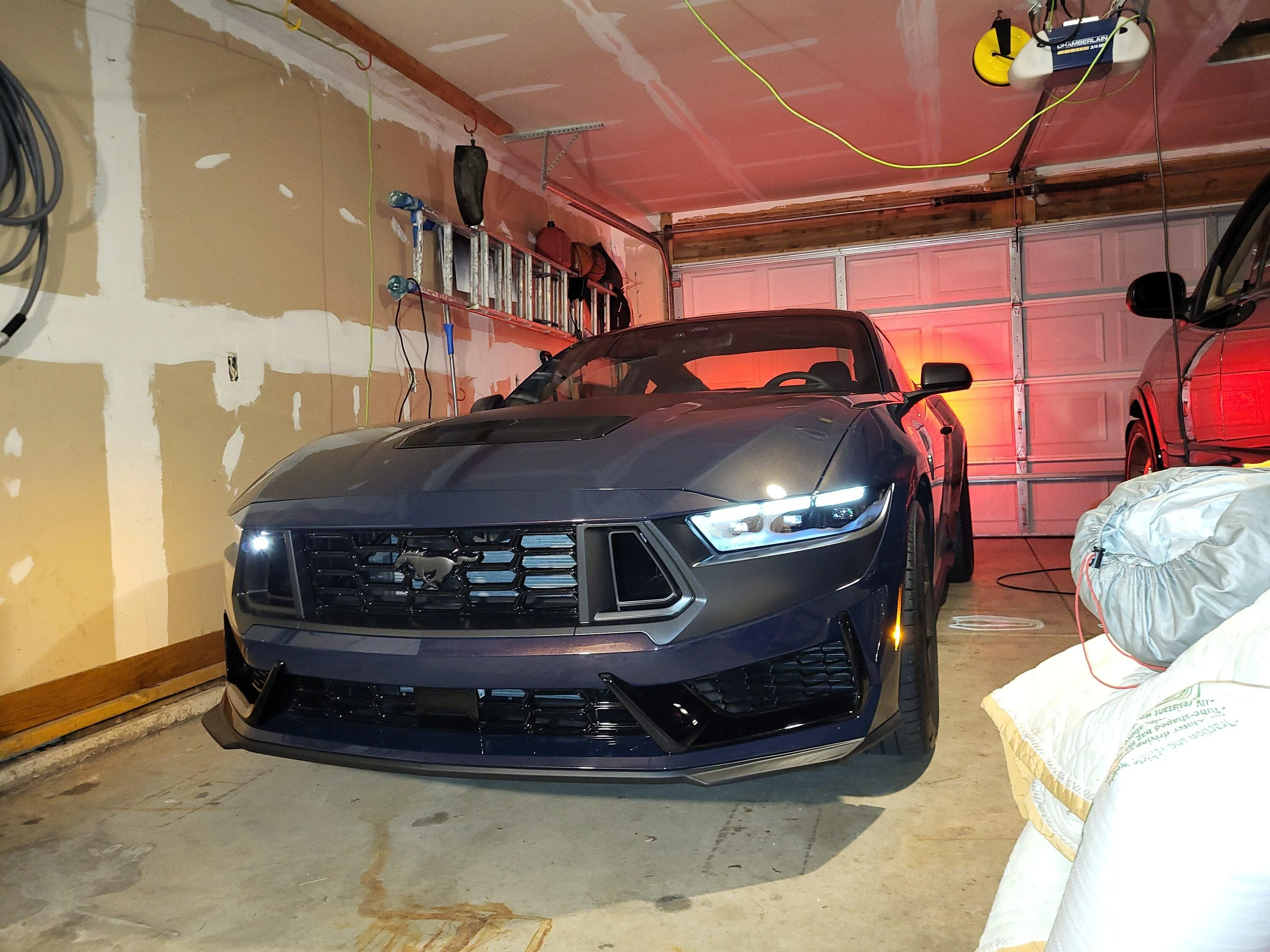

that looks like a lot of extra poke. what's the ET on those wheels?
S650 Mustang HP Darkhorse Wheels installed on Base Darkhorse 1708464700881
Same as the advertised tires shows poked out at the front wheels and seems to be normal!

@MyDarkhorse79 You're stressing yourself out here. You haven't done anything wrong, your car isn't going to explode, and yes you should be seeing poke.
The S650 GT and DH share the same body other than the front bumper. Front wheels that are 10.5" wide with tires that are 305s are going to poke. That's why the Handling Pack comes with the front wheel well liner/protecter. Your studs are fine. Any 10.5" wheel is going to poke on a Mustang without wider fenders.
Stop stressing
