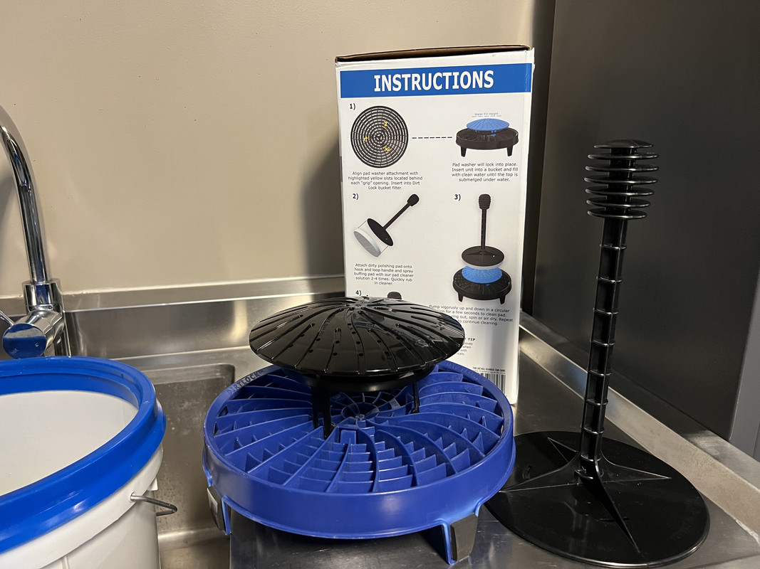

There are many ways to wash pads with varying degrees of effort, time and investment required. Companies like Lake Country and Detail Guardz sell specialised pad washing systems, generally paired with specific cleaning chemicals.
The Lake Country Pad Washer is geared towards high-volume detail shops and probably not worth the $350 for the occasional user. A great setup though.
https://www.waxit.com.au/products/l...sq=pad+washer&_ss=e&_v=1.0&variant=1202289632
The Detail Guardz version retails for about $140, which you pair with an existing bucket. I have one and………………….never use it.
https://detailingshed.com.au/product...m-attachment-1
https://detailingshed.com.au/products/dirt-lock-filter

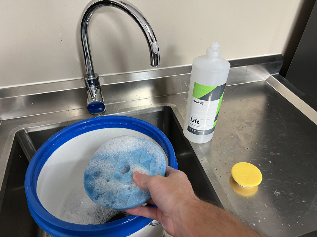

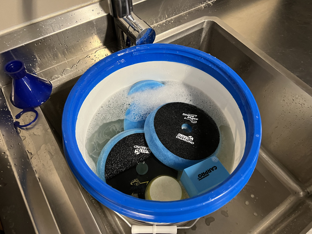

1. Fill a clean bucket ½ to ¾ full with water. Warm water is nice but not essential.
2. Add a generous amount of APC, or Microfiber Detergent or High pH soap.
3. As you finish with each pad, plunge the pad into the bucket of water/soap solution. Continue working, adding pads as you go.
At this point, I normally leave pads to soak overnight in this bucket. The idea here is to prevent compound from drying in the pads as you work, allowing you to get to them when you have time.

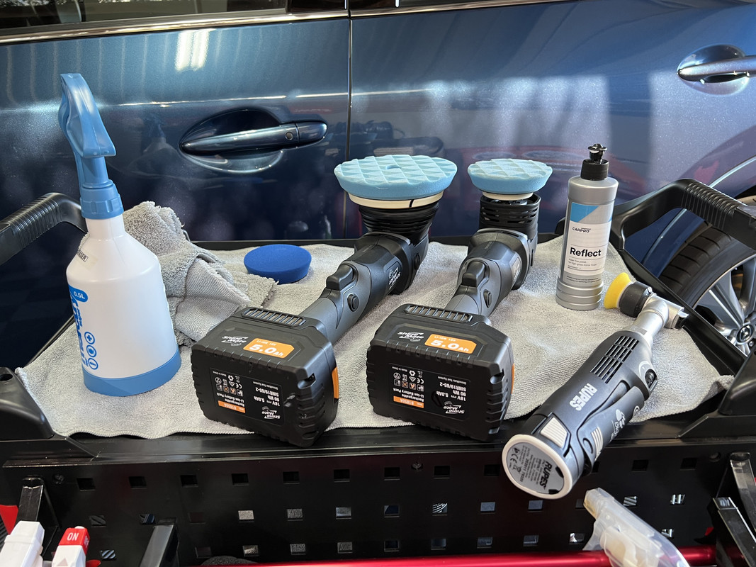

4. Agitate each pad under running water to flush the compound and detergent from the pad by squeezing and releasing until the water runs clear.

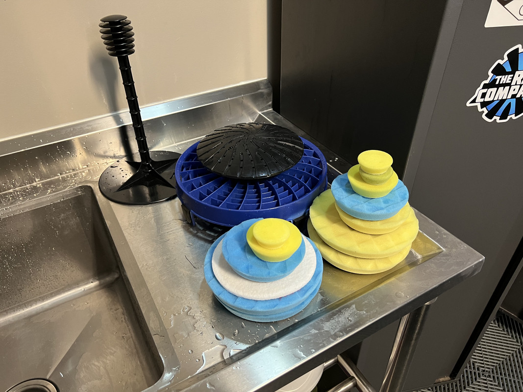

7. From the machine, air dry pads indoors.

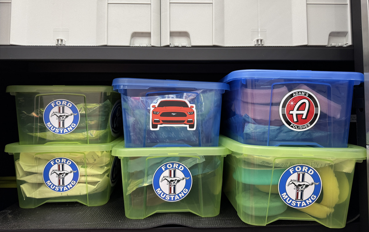

8. Store away your now clean and dry pads. If you store in sealed containers like I do, they must be FULLY dry beforehand to prevent mould.
