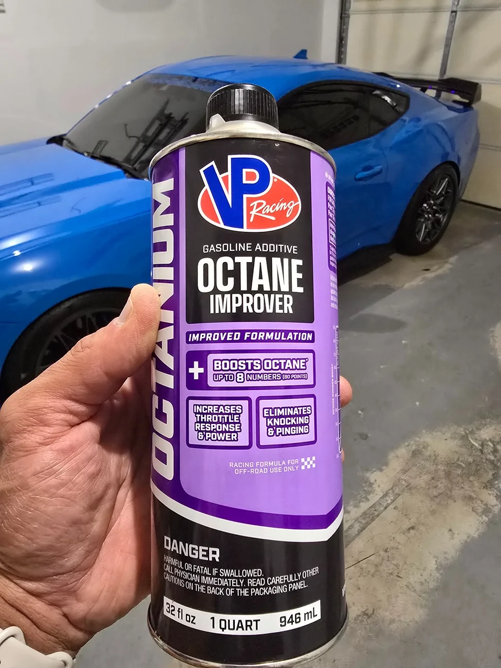

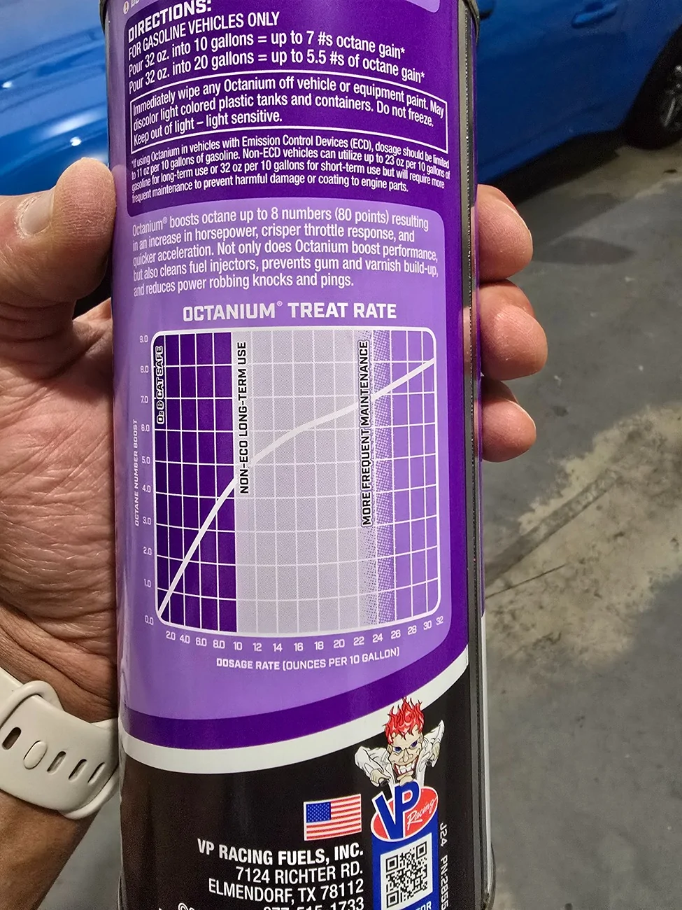

No cats, I run 93 with 1 can of boostane added to 10 gallons of gas. Can't really say on oil temps. My car (performance pack) came with the oil cooler so dont think there is much of a difference
So one can of $12 or $22 or $34?
Because on a 16 gallon tank, and a 2-3 tankful track day, that could definitely add a significant sum to the cost.
I mix a 32oz can with 10 gallons of 93. I run the car down to just below the halfway point between 1/2 and 1/4 tank and that allows me to put in the can and 10 gallons and yes the shit ain't cheap. I buy the 8pk of cans for like $150.
