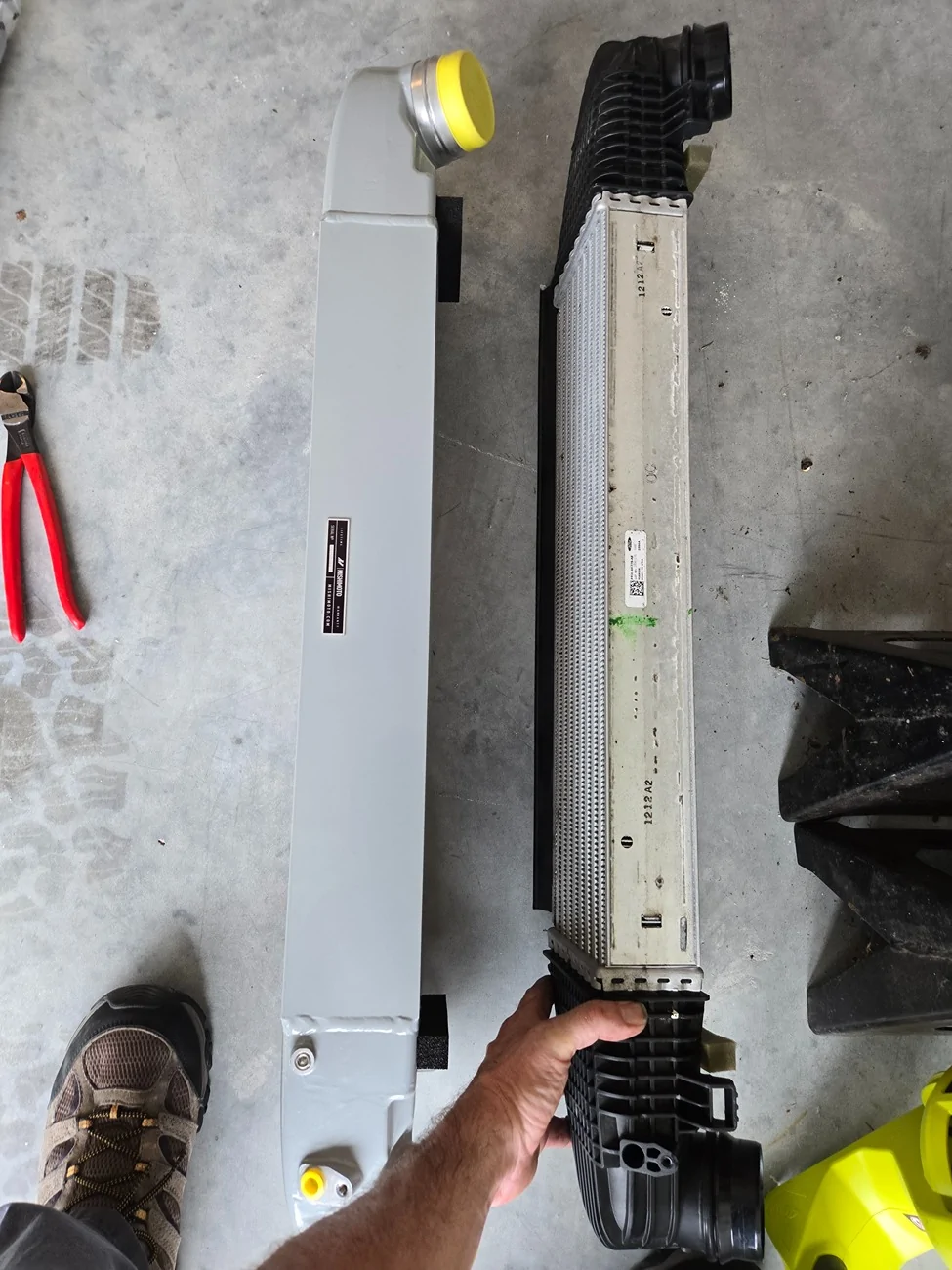

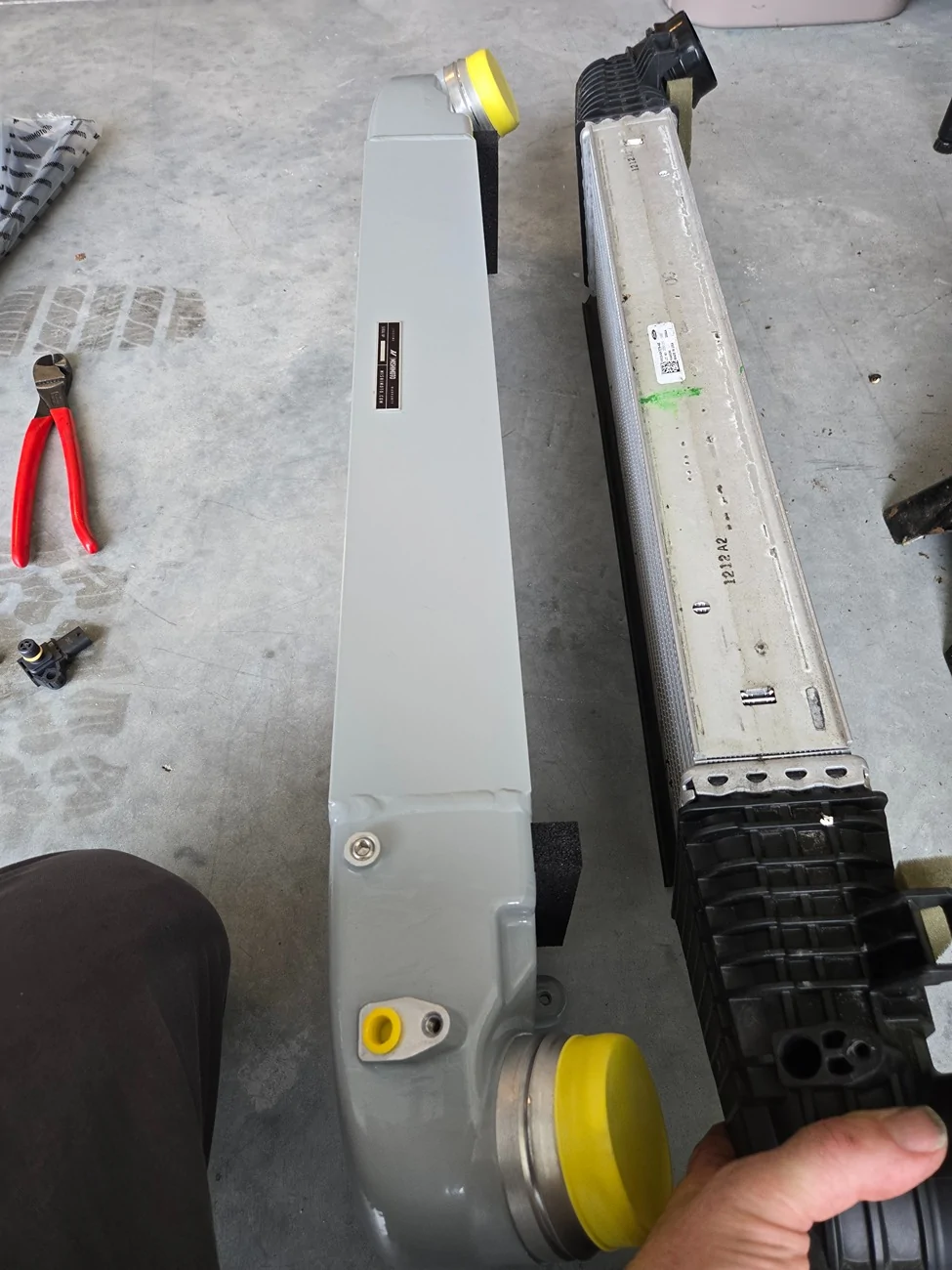

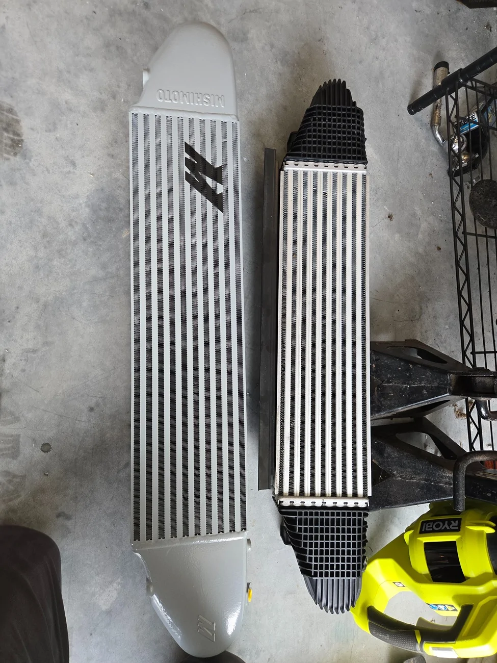

I've got it on mine. I was tired of waiting for anyone else to come up with a better option for the stock location. It's not much of an upgrade for the price. It does help, and I can tell a difference, but there's no comparison to a race intercooler. There is a volume increase (even though it doesn't look it) because I can feel the extra turbo lag. Power does feel better, but I have no real before and after comparison. I did run a 12.8@106 at the track last week with this and a EMS conservative tune with a DA of about 1900ft.
