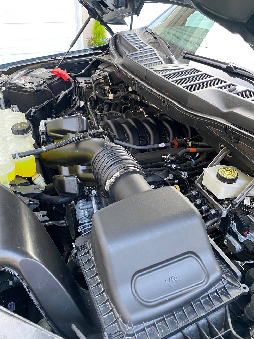

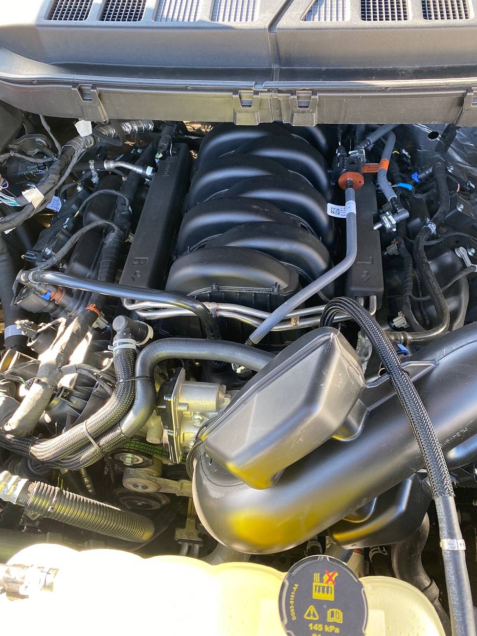

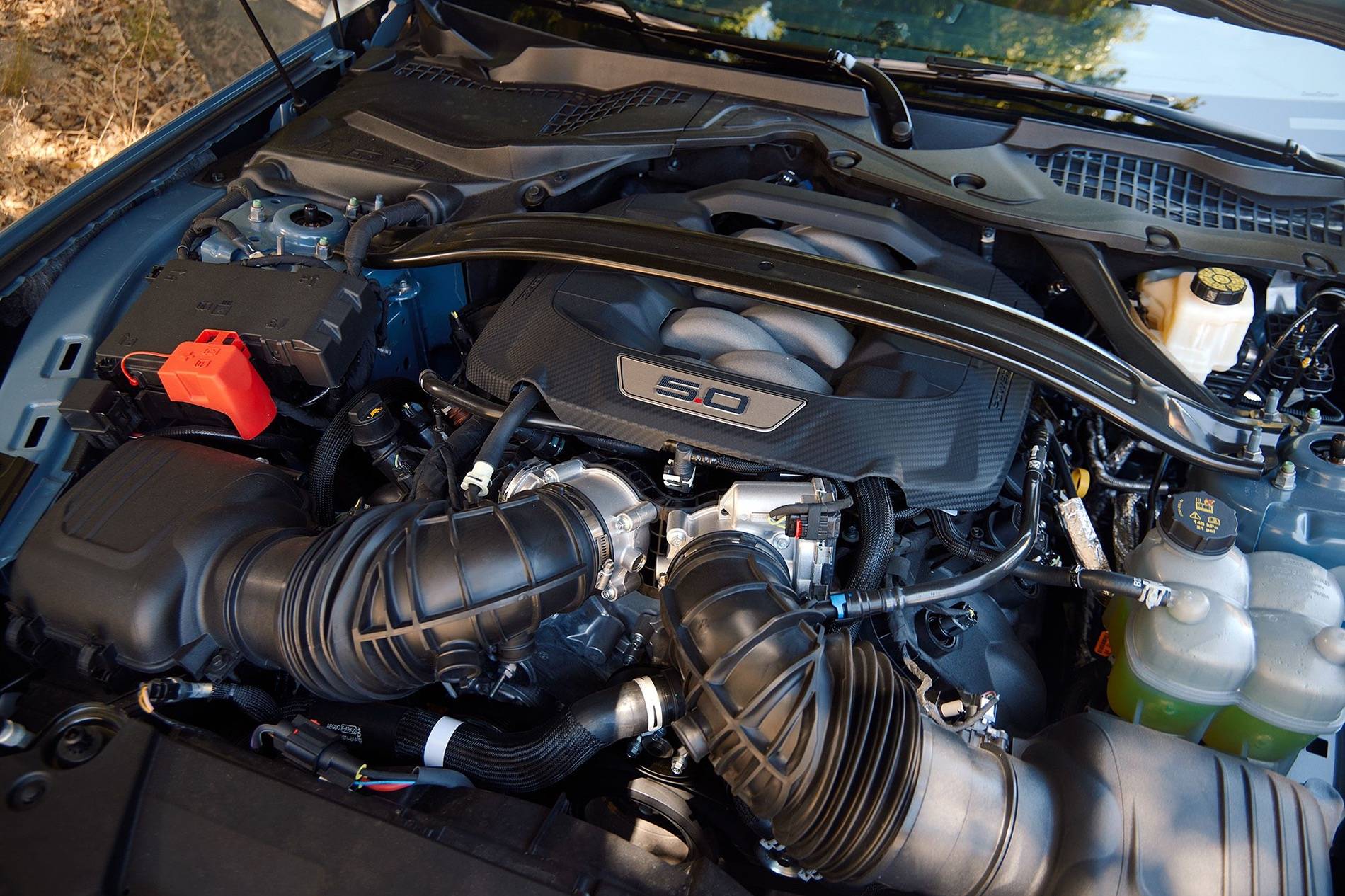

The current F-150 5.0L runs an 87 mm throttle body like the S550 GT-350 and Mach 1 so likely would need to cobble some parts together to feed the larger throttle body. The S550 GT throttle body is significantly smaller than the F-150 at 80 mm. I’d bet you’d gain a fat chunk of low end torque and lose a good chunk of top end. The trucks intake camshaft is where a lot of the extra torque comes from, the lift is 11.5 mm on the truck cam.
What’s confusing is why the truck was running more throttle body than the Mustang for a few years. Perhaps the larger throttle body and runner bore was to help eke out more top end power with the not so great for top end camshaft grind? My guess.

I'm sure there would be hood clearance issues with the truck piece on a Mustang, but as long as we are what if ing.

The intake in my truck is quite a bit taller, feeding it would be interesting too
