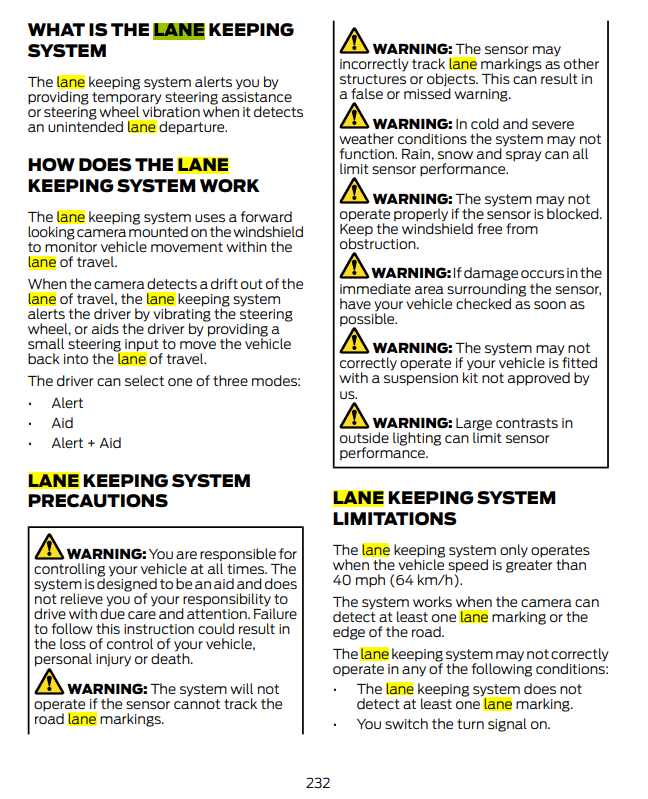

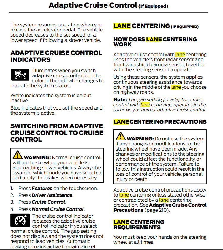

Lane keep and lane centering are two different things in this vehicle. double check Pg.218 and Pg. 232 of your owner's manual and please verify both systems are indeed turned off along with adaptive cruise control (and probably any driver assistances settings for the time being). I would post a picture of your dash currently and a short video of the symptoms experienced in an unoccupied road or lot for your safety. It sounds like improper workmanship upon first diagnosis but more information is needed, I believe.

Owners manual clearly says: The lane assist may not correctly operate if you have aftermarket suspension.
Sounds like installing that wasnā€™t the best idea, you basically lose a car feature.
