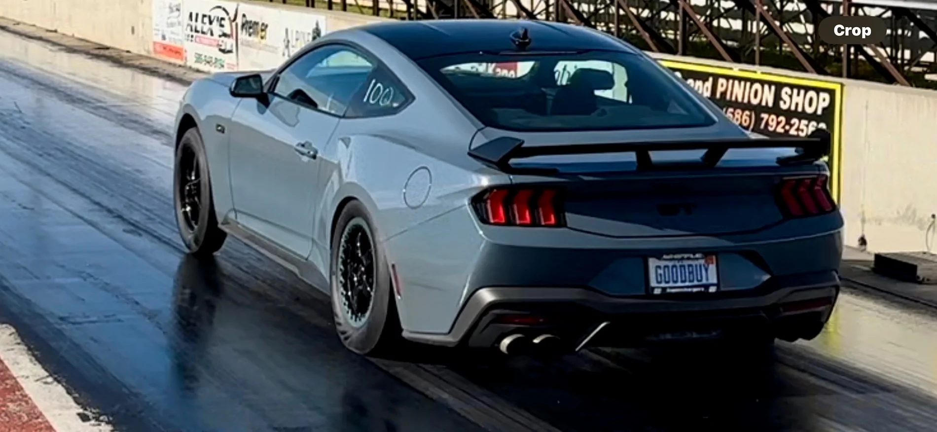

That is exactly what I did, put a GT350 axle in the driver side. I keep the spare GT350 axle and stock axle as extras in the garage, car makes over 800 wheel, never had a problem (but I don’t race as often)
Do you have a automatic or manual?
Also, how many passes have you ran on those 350 axles? I have read that in 2020 Ford upgraded the manual Mustangs with a driver side axle with a 350 axle as stock which means I could buy one from Ford a lot cheaper than going to Ford racing since I can just buy the driver side only. Man, your car looks cool squatting in the back and launching like that. I love that spoiler that really is a cool color on these Mustangs.

Automatic, as far as I know, only the GT350 has these axles, GT500s are even beefier but different length.
I got mine for $399 iirc, was worth it, if I snap one it’s not a big deal, been breaking axles since the 90’s 28 spline sticks.
