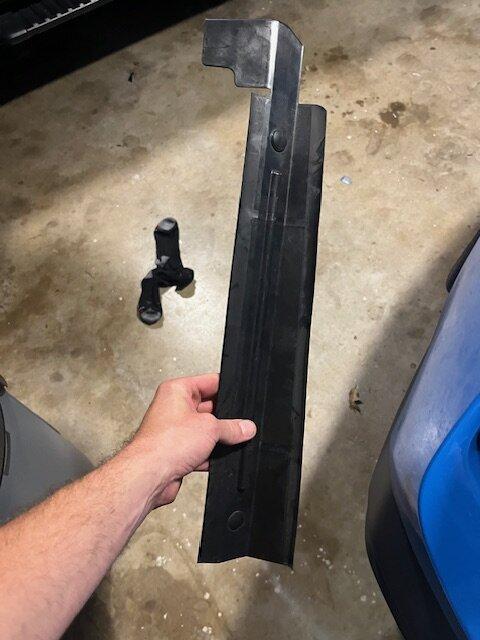

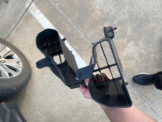

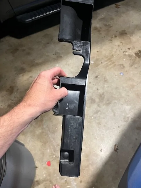

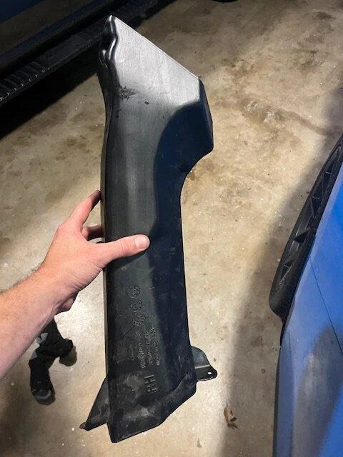

Had the FP branded supercharger installed on the car this week. When I picked the car up from a local installing dealership I had 8 pieces of air flow material returned to me in a box and not on the car. These included:
* Both air ducts that attach to the grill and connect to the stock air box.
* Both air deflectors that go below these
* Both Break cooling air ducts
* Both radiator side deflectors
I know for a fact that both the grill to air box ducts need to be reinstalled.
I think everything else can be and should also be reinstalled.
I expected to recieve the strut brace, manifold, Manifold cover, and intake tubes back......but nothing else.
Dealer seemed to disagree with me, but after a meeting yesterday they seem to agree. Going back Monday. Am I correct that all the items below should remain on the car. In installers defense the instructions do not address reinstall of these items specifically.

I did my own install on my Dark Horse and I only had to omit the radiator side deflectors. They don't fit with the new Whipple radiator. Everything goes right back in place.

Yes, the first 2 pictures.
OK, so the radiator defectors and the lower air deflectors are out. The grill ducts and break cooling ducts are in. Kind of what I figured. Thank you for your help. If need be I shot this and forward, but I'm pretty sure they are going to take care of me.

I had to trim the bottom of that piece on the driver side to get it to fit.
I got all the other parts back in with the exception of the first piece in your original post.
