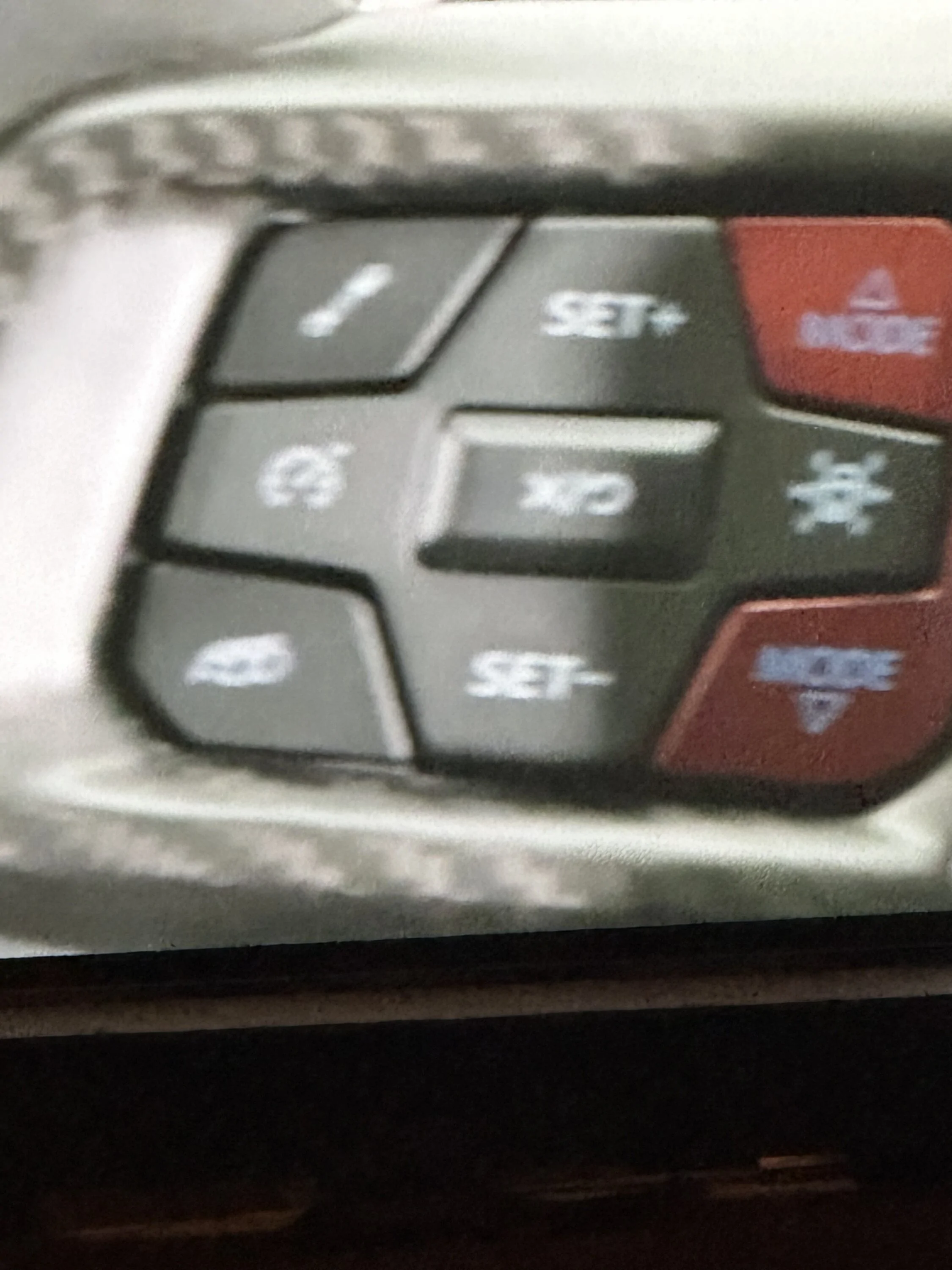

I watched the Jay Leno GTD video and saw that on the steering wheel the speed control button lower left and vehicle spacing button upper right or replaced with exhaust mode and suspension mode. I’m guessing buried somewhere in the programming those should be able to be reprogrammed with forscan has anyone dug into this yet?

I suspect (like other GTD features) it will require programming (and maybe even modules) specific to the GTD... which would require FDRS software.
2,716
4,123
i believe the SCCM has a field where it stores what buttons are on the steering wheel, and the button clusters themselves have 3 lines in that go to resistors, then go to one line out. i cant comment on if the GTD's buttons have the same resistors as normal but with new interpretations by the SCCM, but it seems likely. there is a good chance that if you have a 2024 job 2 or later model you may be able to just change the value and have it work, but no promises
