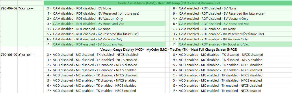

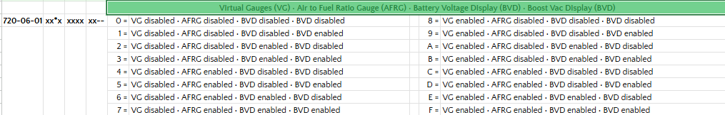

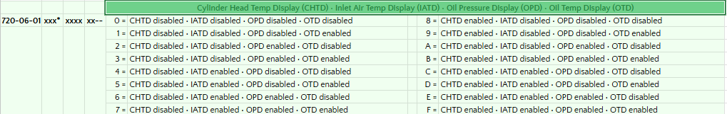

Seems like they can be disabled. Not sure what would happen if you did, but I guess you can just put it back if you don't get the desired result. These settings below would need to be messed with to see what happens.
IPC:
S650 Mustang Edit gauge selection using Forscan? 1764440457172-il
S650 Mustang Edit gauge selection using Forscan? 1764440493321-n8
I would look at the ones above first and then here if needed. Just make a back up of your IPC first jic.
S650 Mustang Edit gauge selection using Forscan? 1764440557109-fv

Yeah, I looked at that spreadsheet and, although I've made a few changes using forscan, I am LOST with out a specific direction - where to start???
I'm a little surprised someone more "tech" oriented than me hasn't edited the gauge selection on an S650 - probably easier than I can comprehend.
This the config in those lines of the IPC from a random 2026 EB Mustang I found at a local dealer:
S650 Mustang Edit gauge selection using Forscan? 1764446730593-8c
06-01: xxFx xxxx xx-- means Boost Vac Display is enabled. So I would change that to an E to disable Boost/Vac and leave everything else as is.
06-01: xxxD xxxx xx-- means IATD is enabled. So I would change that to a D to a 9 do disable IATD and keep everything else the same.
So go there and change that line to xxE9 xxxx xx-- and write it, then go to the wrench icon and reboot the IPC. However, I think all this will do is turn those gauges off in the cluster and replace it with two other gauges. I don't think this will cause the layout of the cluster to change.

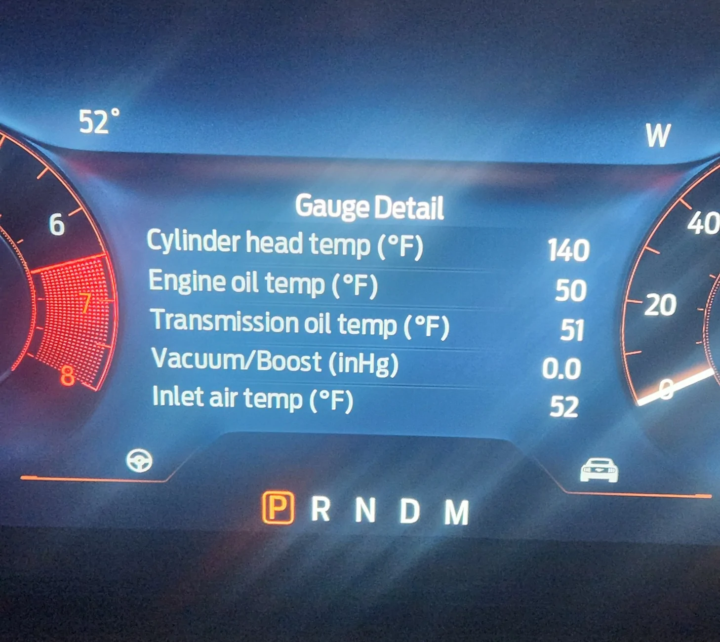

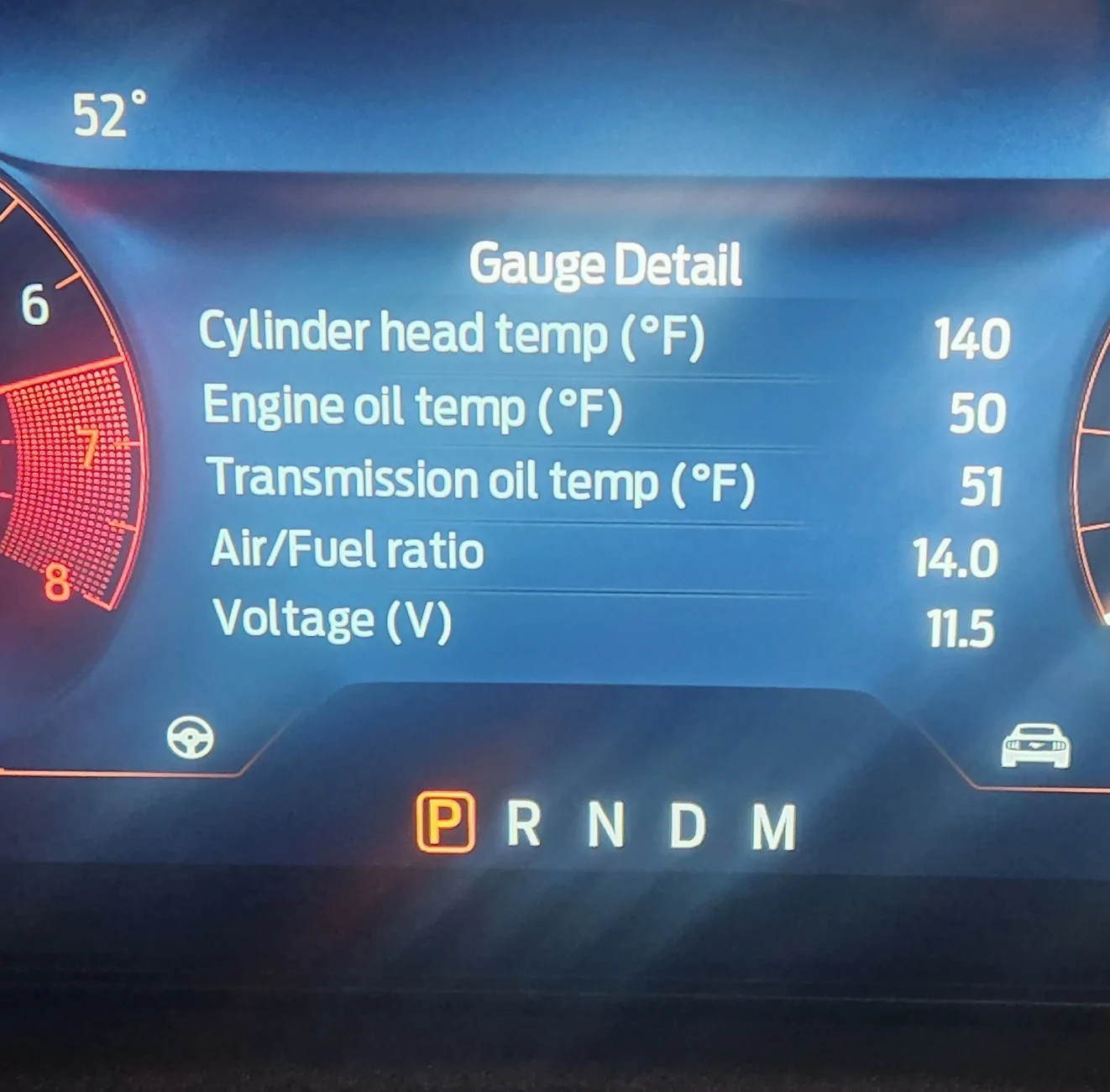

I made the Forscan changes to the IPC on my Mustang posted by @rugedraw and; IT WORKED!! Thanks for figuring out the spread sheet coding and posting it for me .... ( I was sure there had to be a way) - the first pic is the screen with the (as built) vacuum boost and inlet air temps, the coding changes made them disapear ...air fuel and voltage were on a separate screen. After the Forscan change, they are now on a single screen - pic 2. THANKS .......
