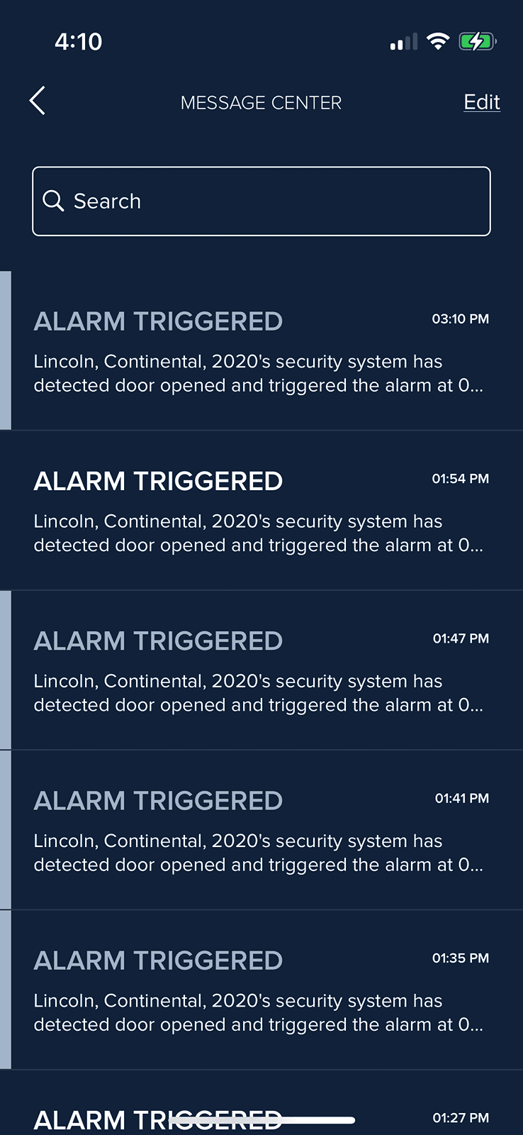

My wife has a 2020 Lincoln Continental. Lately a door alarm has been randomly going off when she locks the car. A few days ago the LincolnWay app registered six separate alerts all at the same time stamp. Today there were eight alerts spread out over a 30 minute period.
When she came home today, I had her lock the car when it was in the garage and walk away with the fob. I then tried to open each door with no alert. I then hit each door handle with my hand. Still no alert. About ten minutes later, the car horn started beeping. Unlock the car and it stops.
I know virtually zip about the ODB II codes but I was wondering if the error messages are stored and in more detail. She has an appointment with the dealer on the 28th. I am hoping they can hook up their ODB II scanner and figure out what the issue is. I know it is NOT the battery. It is fully charged per my NOCO 5 amp maintainer.

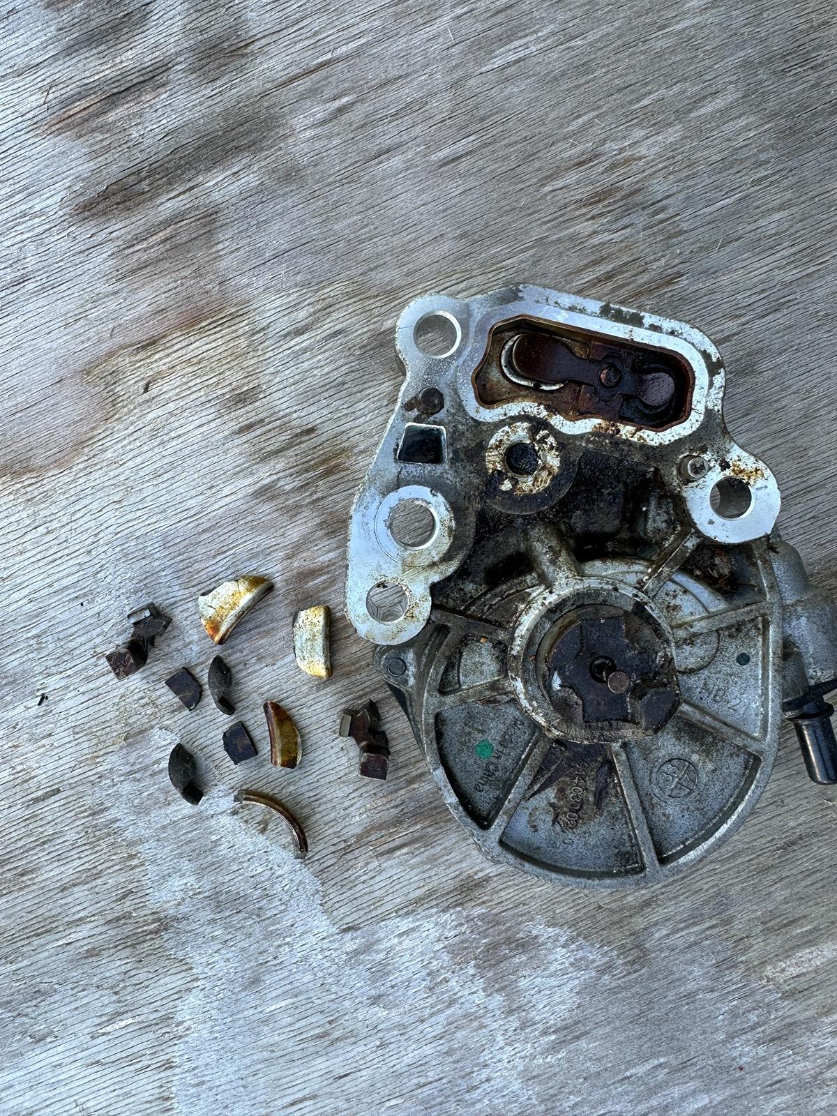

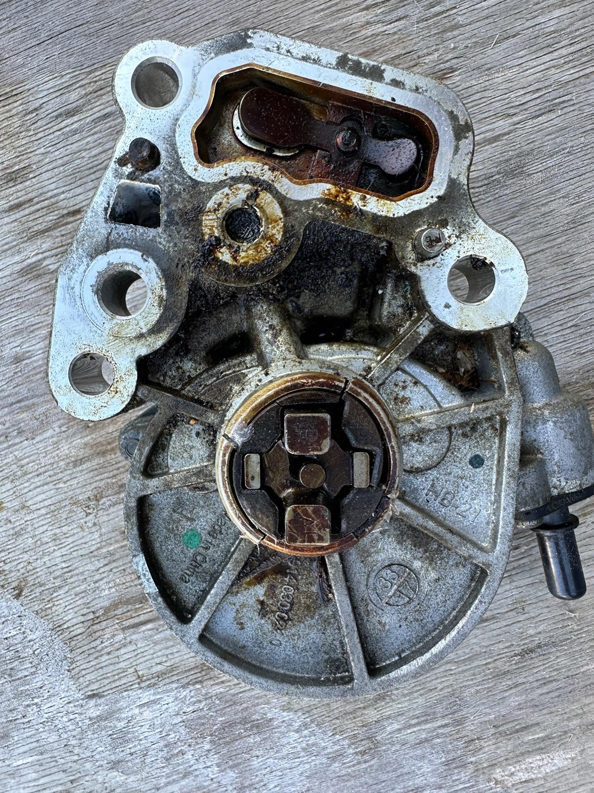

Sorry dcs, malibu (spoken like coach jim mora - playoffs lol) just got done replacing the frigging vacuum pump - heads up not fun when it decides to grenade.

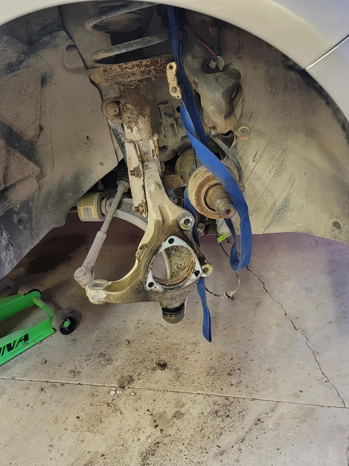

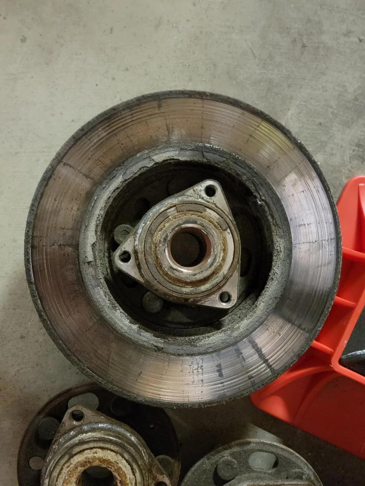

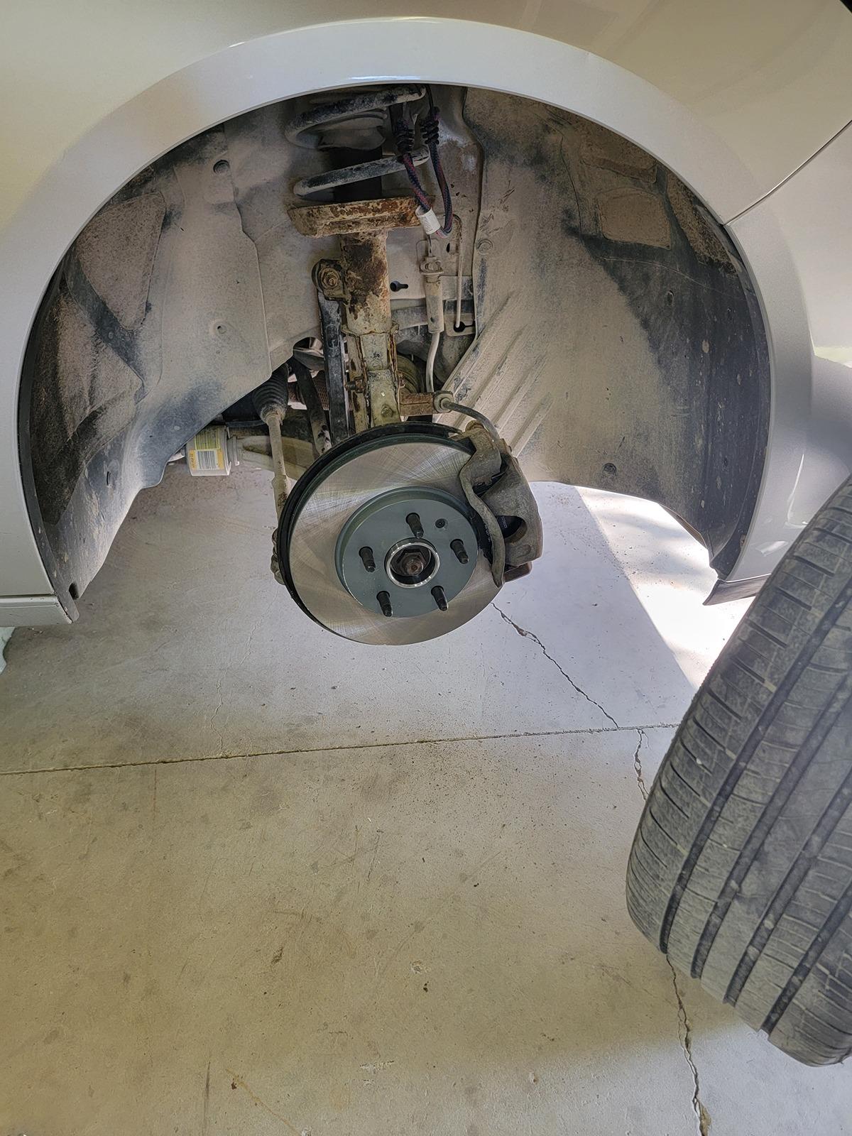

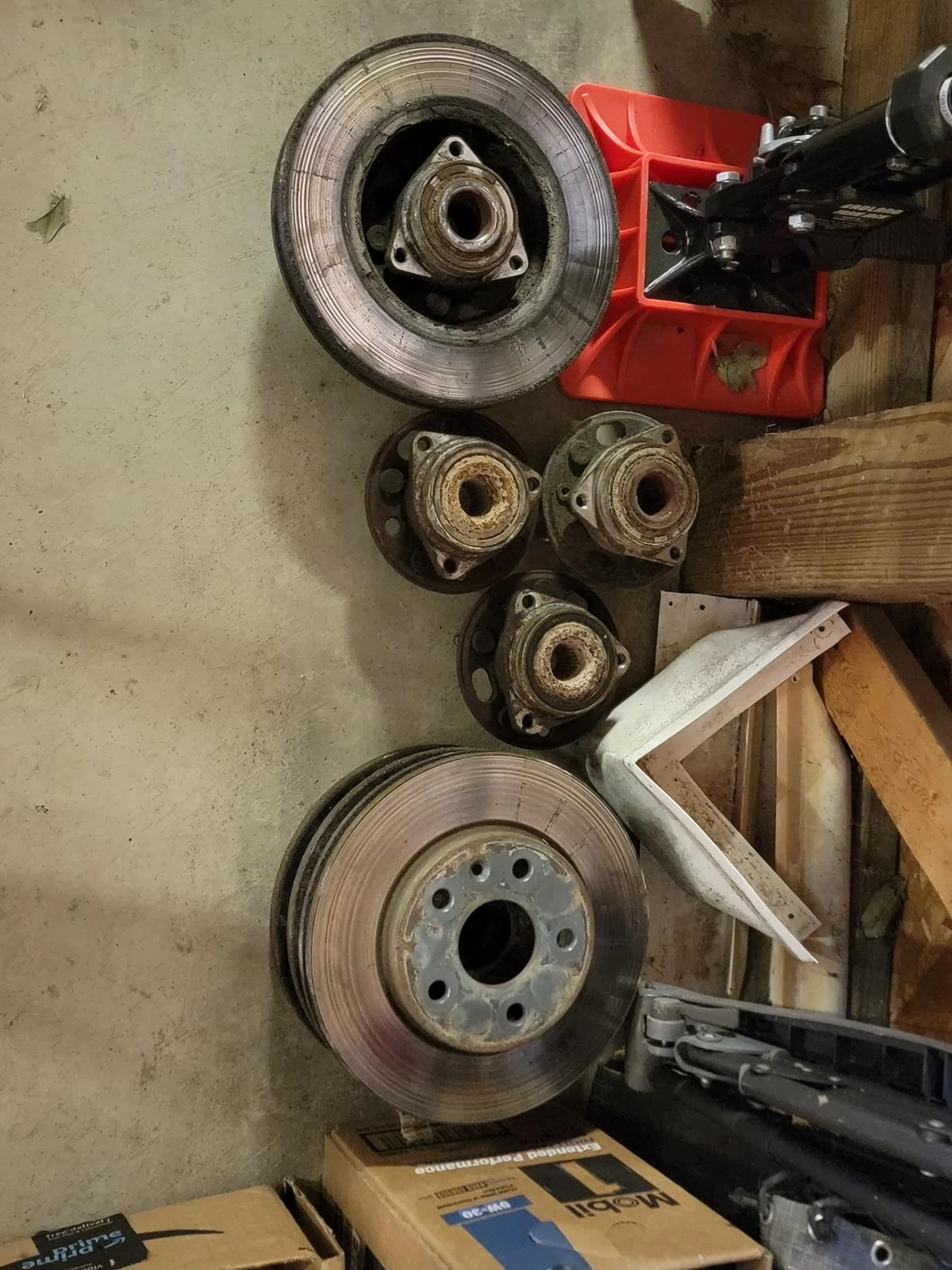

I had to replace the hub bearing assemblies all the way around. "Service AdvanceTrac". The wheel sensors can't pick up the signal from the ring in the hub -- the ring that falls apart and is no longer a complete circle. #$%#@ I spent over 14 hours on that job!
