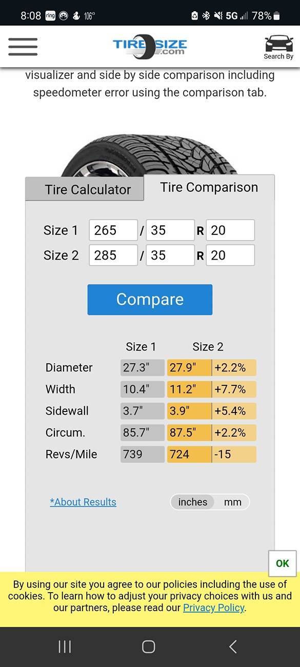

One more question, with 20” x 9” wheel, I can’t add much sidewall bc the wheel is tall and I can’t go much wider bc the wheel isn’t wide enough. So the best I can do is go from 265/35/20 to 285/35/20.
I’m I thinking about that right?

If you're looking for more sidewall, that change is hardly worth it.
S650 Mustang Fitment advice: GT with progressive springs, daily driver with a little road course time Screenshot_20250627_200828_Chrom

On a 20x9 wheel 285/35/20 could be mounted, but it would likely be wider than the recommended by the manufacturer for your wheel width.
You also have to consider if it will fit in the wheel well without rubbing. The OE Ford wheel looks to be a 42.5 offset. Therefore the stock tire is approximately 175mm from the font of the hub to the inside of the tire and 90mm to the outside of the tire (tire width divided by 2 plus offset for inside distance and minus offset for outside distance). If you go to a 285 tire, the inside is now 185mm and the outside is 100mm. Additionally, the tire will be slightly taller which will affect fitment. These numbers are ball park figures because two brands of 285 tires will have slightly different actual dimensions as well as a 285 mounted on a 9” wheel will be narrower than when mounted on a 10.5” wheel.
I don’t know exact numbers of what will fit because it will vary based on the height of the tire, but I did a lot of calculations when I was working on my tire setup. With my setup I have a 295/30/19 on a 19x11 ET52 and run a 28mm spacer up front. I have approximately 8mm of clearance between the inside of the tire and the strut, and it is about 172mm from the hub to the inside of the tire (295/2+52.5-28). If I have 8mm of clearance, then my total hub to inside of the tire clearance is a maximum of 180mm with my 26” tall tire. The tire height really is more of an issue with outside distance from the hub because of having to clear the fender or with scrubbing the inside wheel well at full steering lock, but I mention it just so you know tire height will affect fitment. So I’ve measured about 180mm of inside clearance on my car. If you go to a 285 wide tire you’ll be at 185mm inside. I’m afraid that tire may rub the strut. That said, all of these numbers are approximate, so actual fitment could vary a few mm which can affect fitment, and I also don’t know if the non-PP cars have different clearances which would mean the measurements I’ve taken on my car may be different.
Before you decide to go to a 285 on the OE wheels, you need to either 1. Find if anyone else has used those tires/wheels on a car with the same suspension you have, or 2. Measure the clearance of your current tires to make sure adding the extra 10mm inside and outside as well as some extra height won’t result in contact with the suspension or fender including while turning.

THANKS for your help guys!! I agree AZ_Ryan, it’s not worth making the change. At 275 or 285 I won’t pick up much sidewall. I may just get diff tires, same size. I don’t love the Eagle F1s that came stock. And one day, I can get summer tires on 19” wheels and go bigger. The problem is I love the stock wheels.
