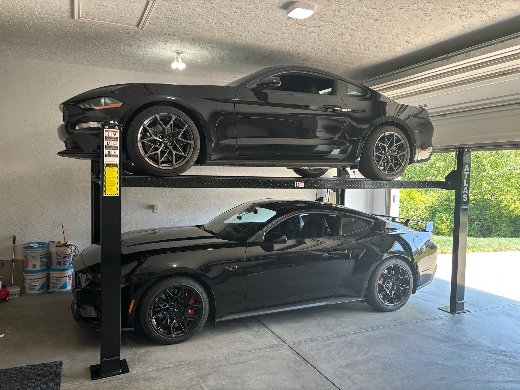

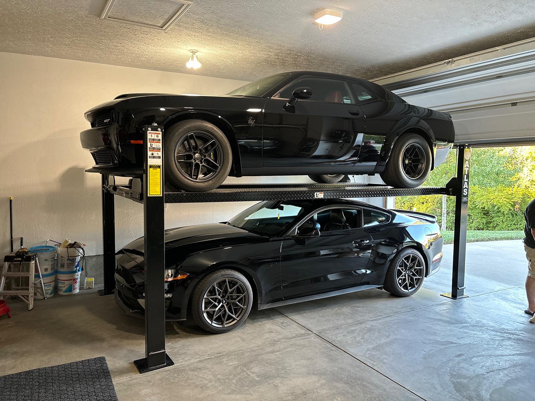

What is your ceiling height in there? Trying to figure out if I can fit one in my garage...
My garage is 9’ 6” and I can stack two Mustangs with a few inches up top and between each car. Have had it for about 5 years and love it.
BTW: I also went with the 220v option.

Congratulations on the lift; you’re really gonna enjoy it!

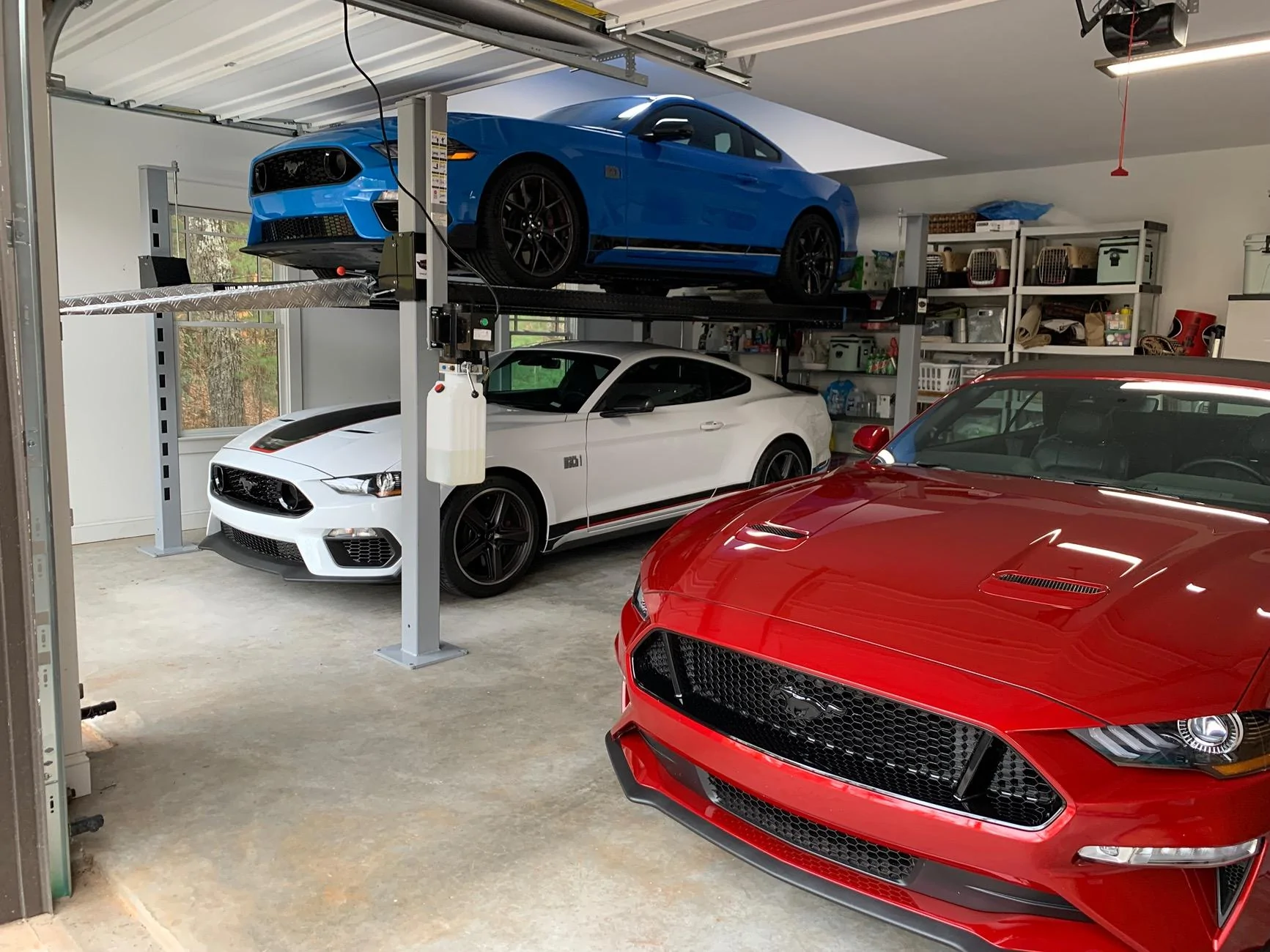

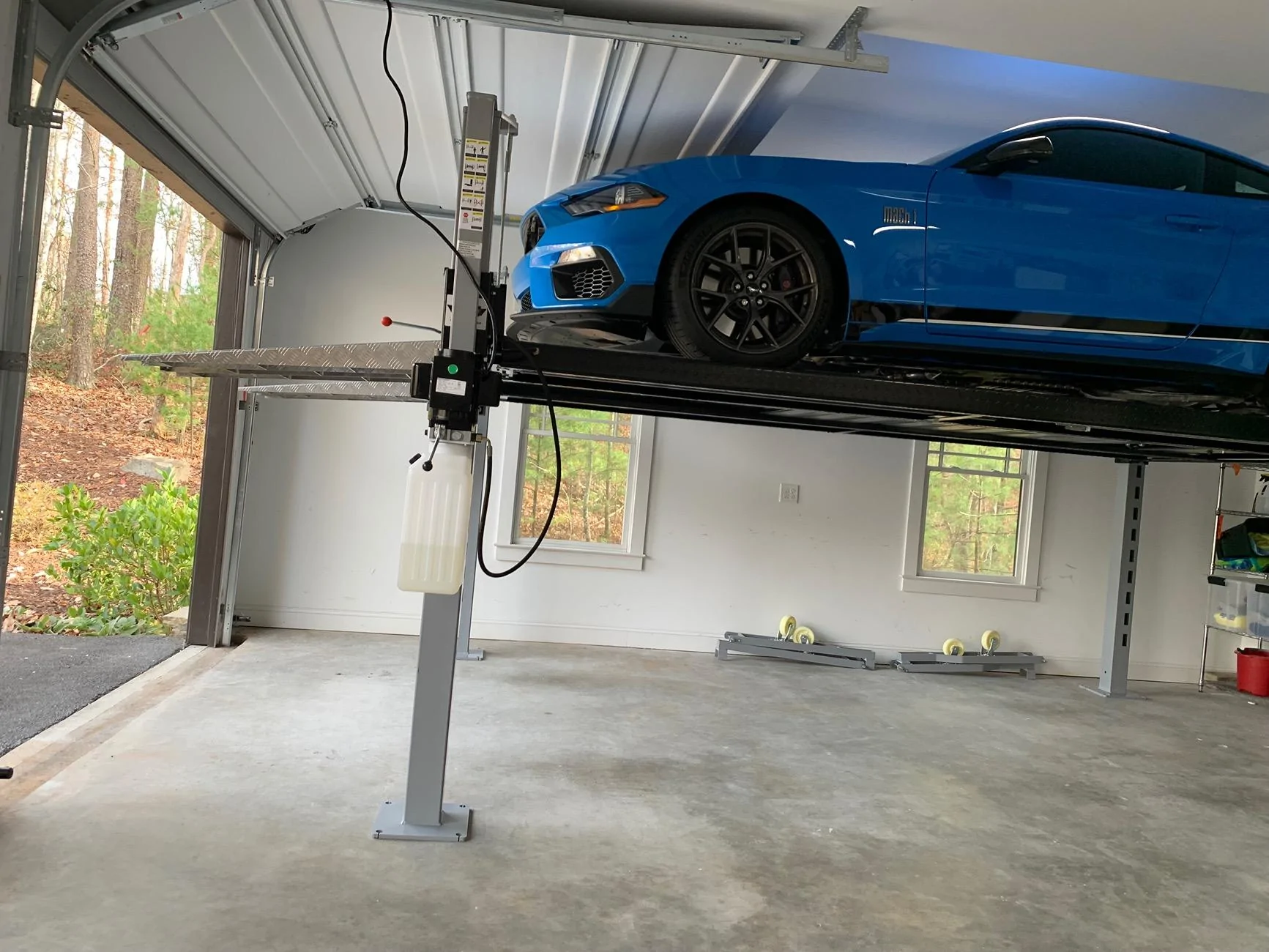

My garage ceiling was only 9’-3” but it was clear space between trusses overhead so I had a 32” tray built up so the top car had a place to go. Also had to install a high headroom door kit and a side mounted motor.
Mine is intentionally designed to not bolt down and be moveable. You just put the wheel dollies under the posts and roll it anywhere you want. It’s actually a selling feature of this lift. You can see the dollies up against the wall in one of my pics. If you’re worried about it toppling over you might as well worry about an earthquake taking your house down first because that’s what it would take. You couldn’t budge this thing with a Caterpillar. I’ve seen this particular one on a couple of TV car shows in daily commercial use so I figure it’s OK.
For me this has been life changing. I have a 3 car garage but I’m considering another lift already.

What spoiler is that on top mustang? Bottom picture, looks like HP wheels too?
It’s a knockoff GT350 spoiler, those are real Mach 1 HP wheels I bought from Levittown Ford a few years back.

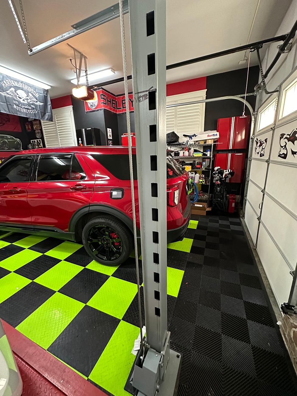

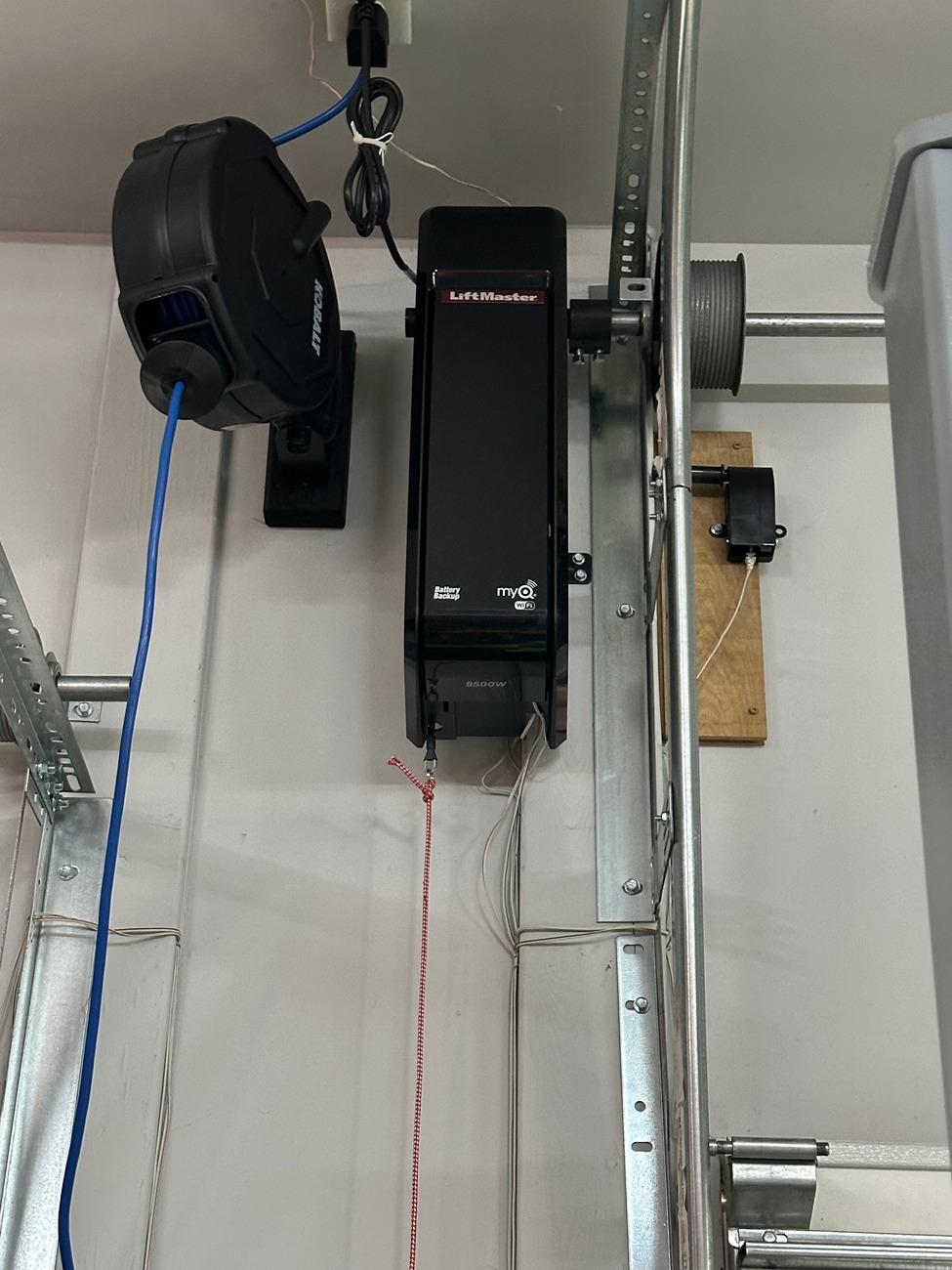

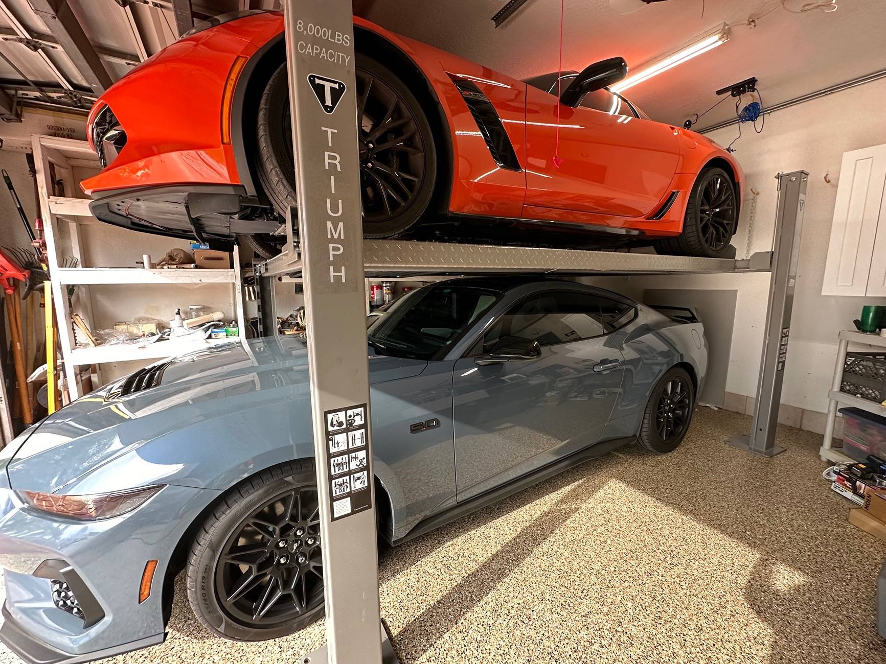

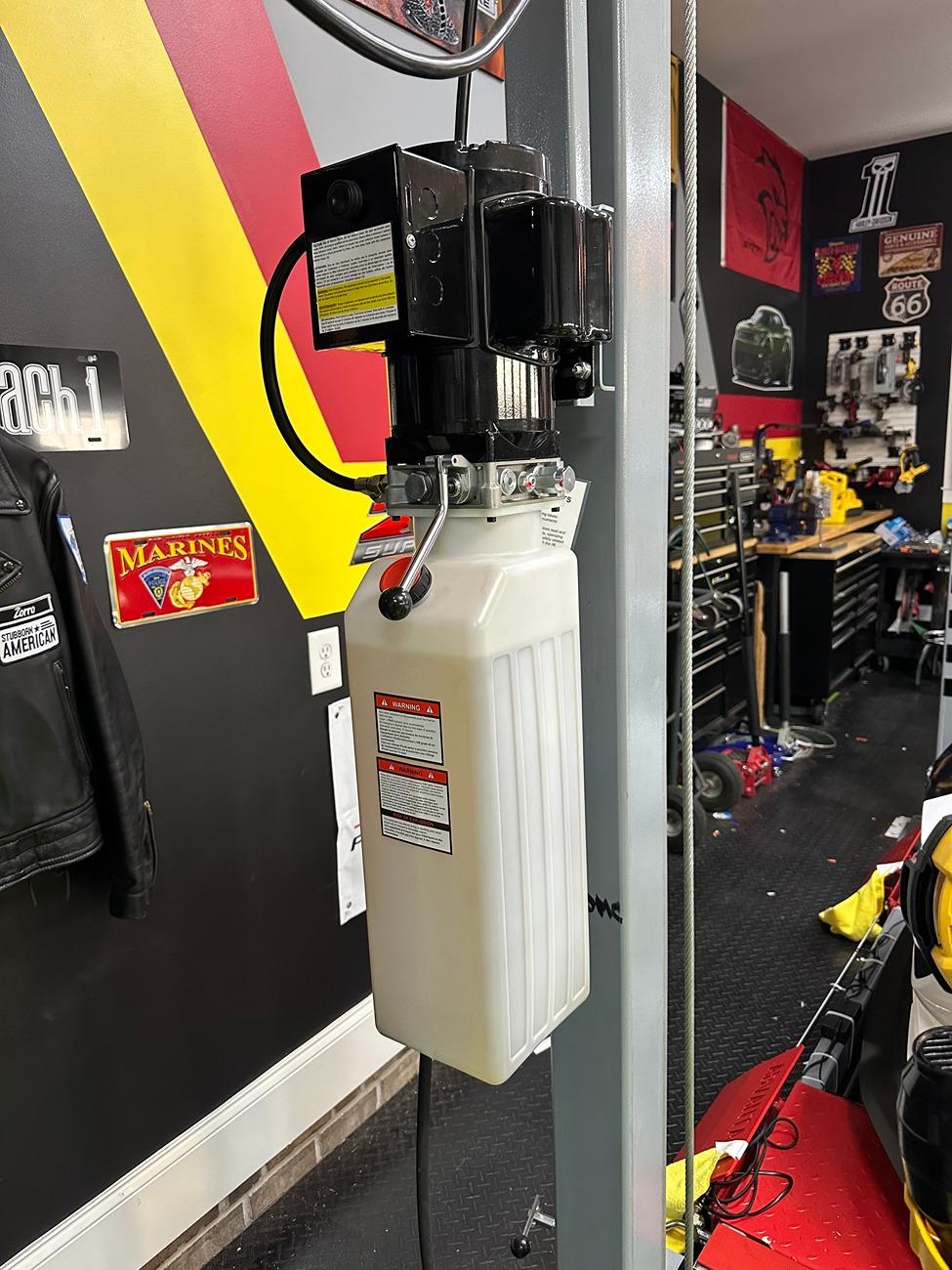

So (to help those considering a lift here are pics of my lift and set up) if you look you can see what I'm talking about the lift lock holes cut directly into the support poles (NO LOCKING LADDERS) also the 220V motor, and the side slung garage opener that you will need to install before installing the lift. Also, as you can see my lift runways - I had extra runway side plates made to make the runway extra wide to accommodate wider wheels and tires...
Anyone seriously considering a lift DM me I will help with any questions you may have - it's a big expense and you want to choose wisely as to not have any regrets after you wrote the check...
