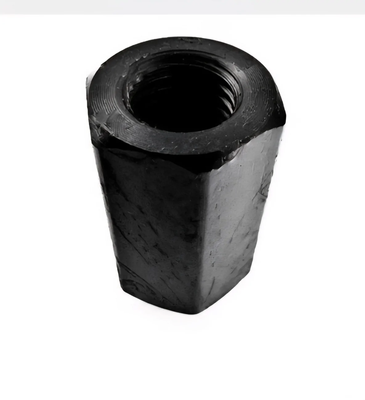

I looked at both designs at steeda. One has a hex head you can't grab but grips cause the sidewalls look 90 degree . The other has a rounded head you can't grab at looks like it will spin.
A taller nut. Coupler nut seems to be the better mousetrap. If that exists in the proper specs. The one pictured is 3/8 thread. 1" tall
I have had the clamps on my exhaust for two years now. I loosened to adjust the exhaust position just a couple months ago. They loosened and tightened with no problems. The “rounded” heads are held in place because they ride in a curved channel and the bottom of the heads are curved so they sit in the channel and do not turn. I use an torque wrench on mine and have never had a problem with leaks nor with the bolt heads spinning while loosening or tightening. Sorry to hear the OP had issues; I know how frustrating that can be.
Good info. I just look at it and the design doesn't look good. I think the extended nut would be usefull. Having that mechanical attachment point...
I know working on exhaust some of the spaces are very tight, so it makes it easier to work with when things are a compact as possible. I’ve never considered the clamps to be poorly designed because they’ve never given me any trouble. After doing suspension work, nothing seems more simple than loosing or tightening these exhaust clamps. 😂
