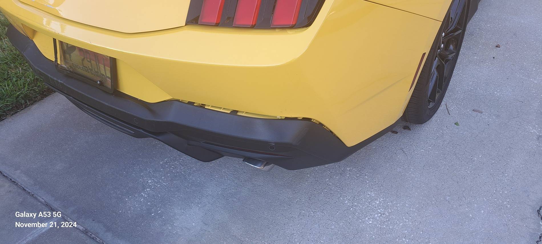

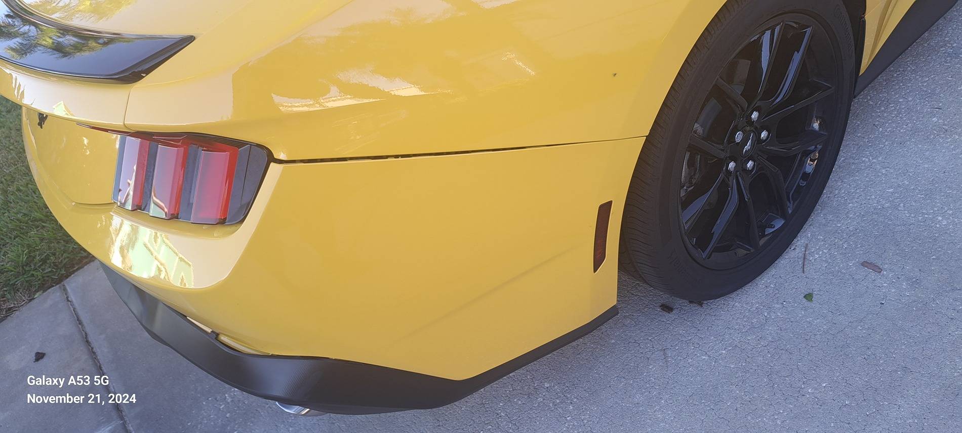

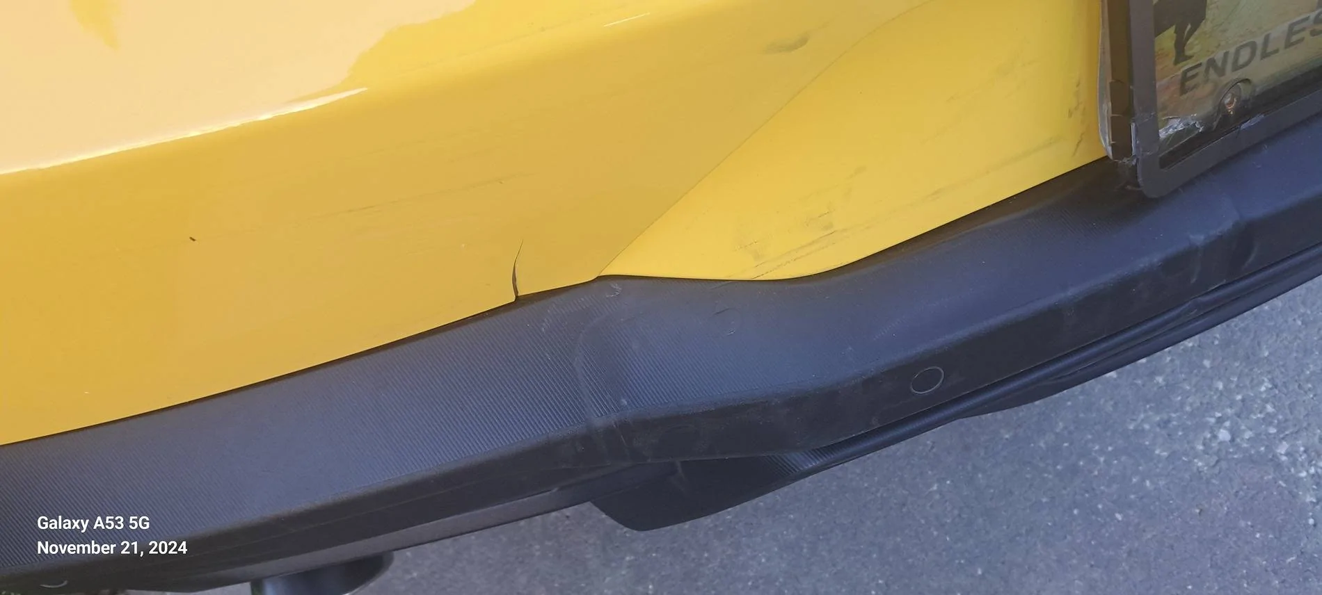

Got rear-ended yesterday in my 2024 EcoBoost yellow Splash 4000 miles on it I'm a little concerned with the paint match and how well it'll hold up trunk needs to be replaced rear bumper needs to be replaced side fenders look okay but maybe need to be realigned I'm wondering if aftermarket paint is going to hold up should I just eat the whole deal sell the car and buy another one any opinions I would say it's about $4,000 worth of damage I was stopped at a light and got hit and breaks my heart car is brand new and 4 months old and you can't even order that color in 2025

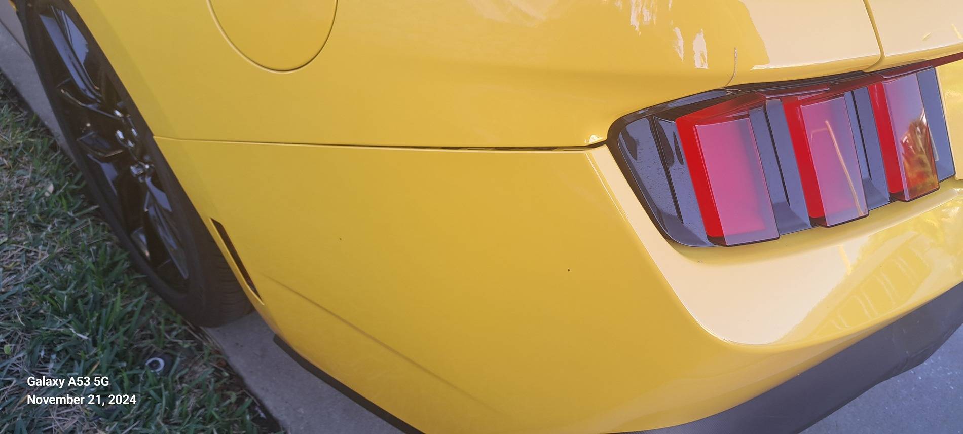

thanks guys bringing back to my dealer bill currie ford in tampa fl i heard good things about their work gonna call collison safety consultants work estimate happening tues need a rear bumper trunk lid and and rear fender need to be aligned it also seems like the convertible top is looser than before is that possible frame damage? Thanks for all the info im weird when it comes to new cars if it was 4 or 5 years old would bother me less but this car has only seen rain 3 or 4 times garage kept ect>>ill probably sell it and get a 2025 in grabber blue as yellow splash is now discontinued

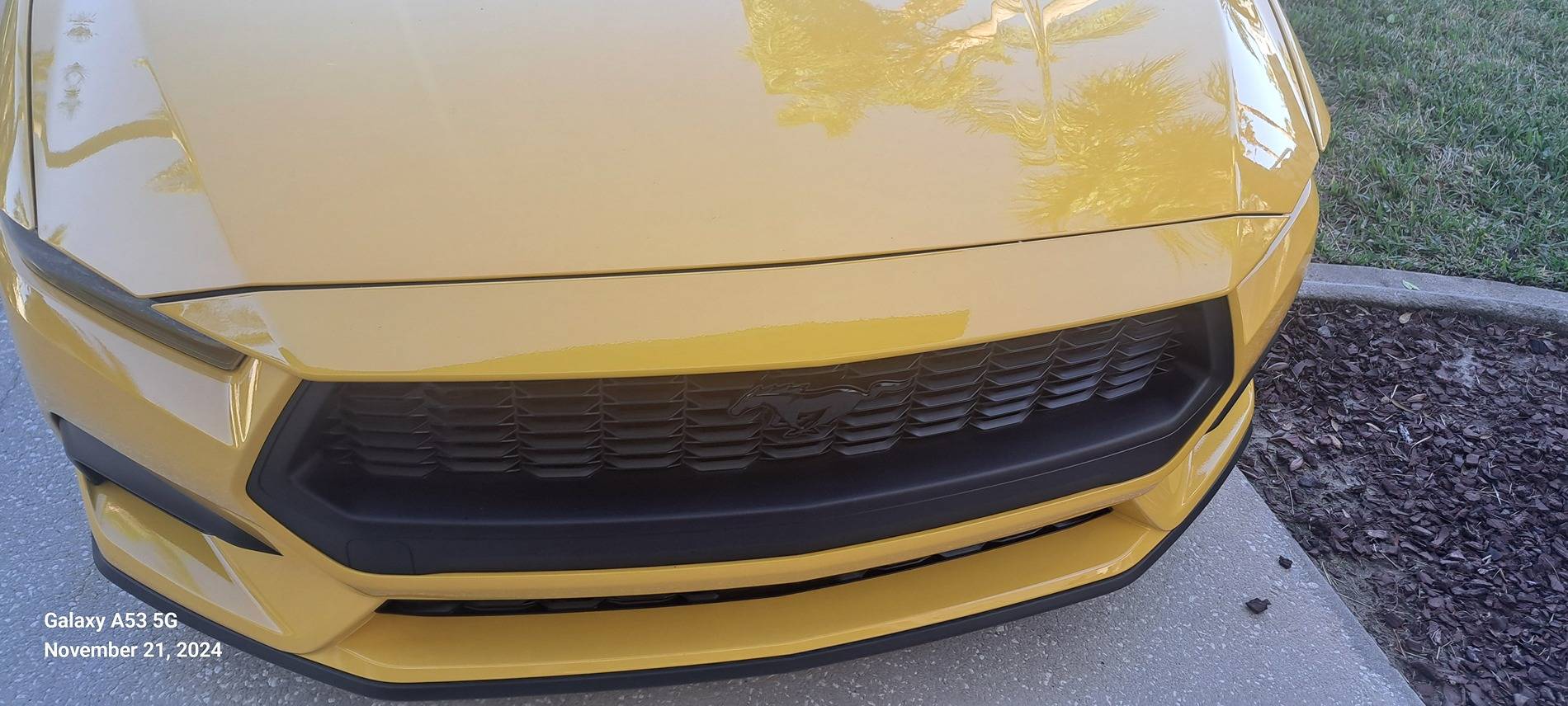

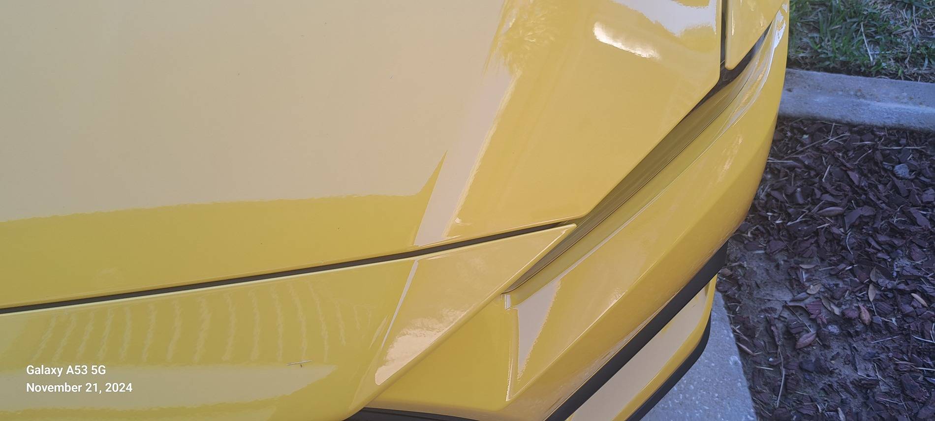

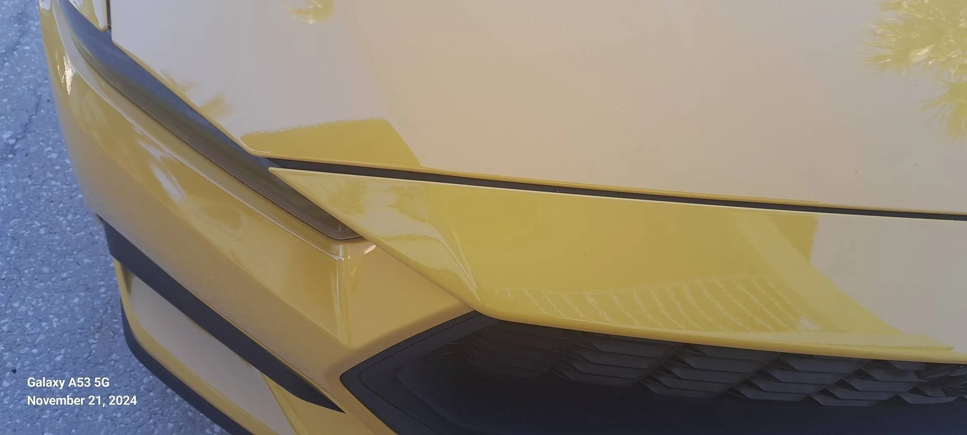

I also noticed that hood gaps and changed is that possible from a rear collision at redlight i didnt hit anything in front of me at all

its also seem that hood gap changed which is weird as i didnt strike anything with the front of the car
Gotta get that bumper off and have a body shop dig, but if the hood didn't hit anything it can be realigned with a wrench.

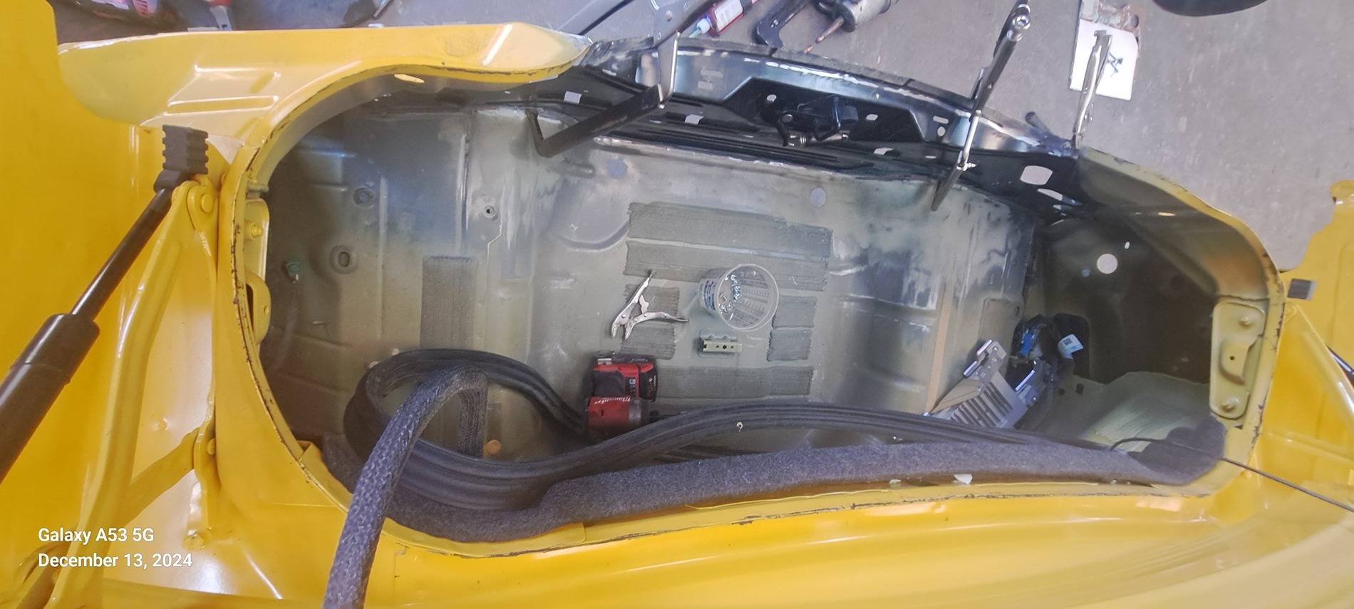

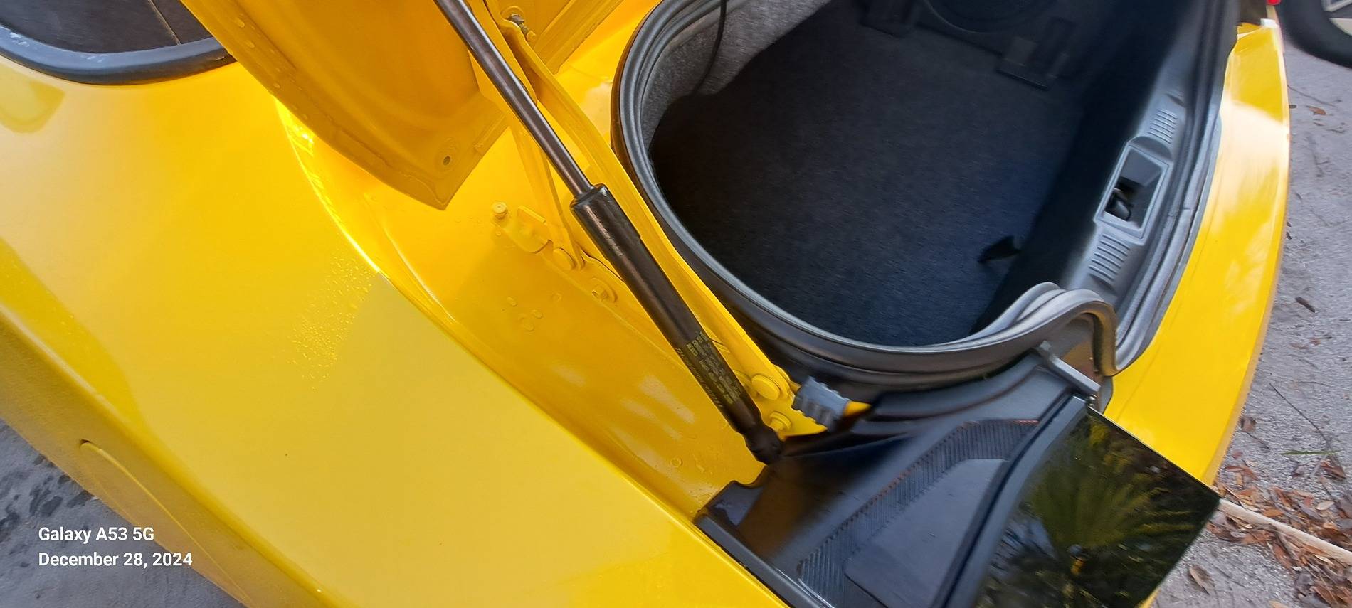

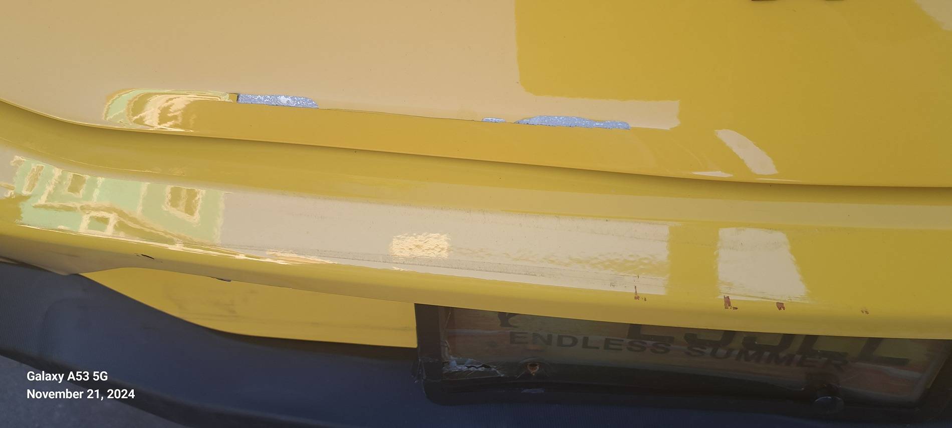

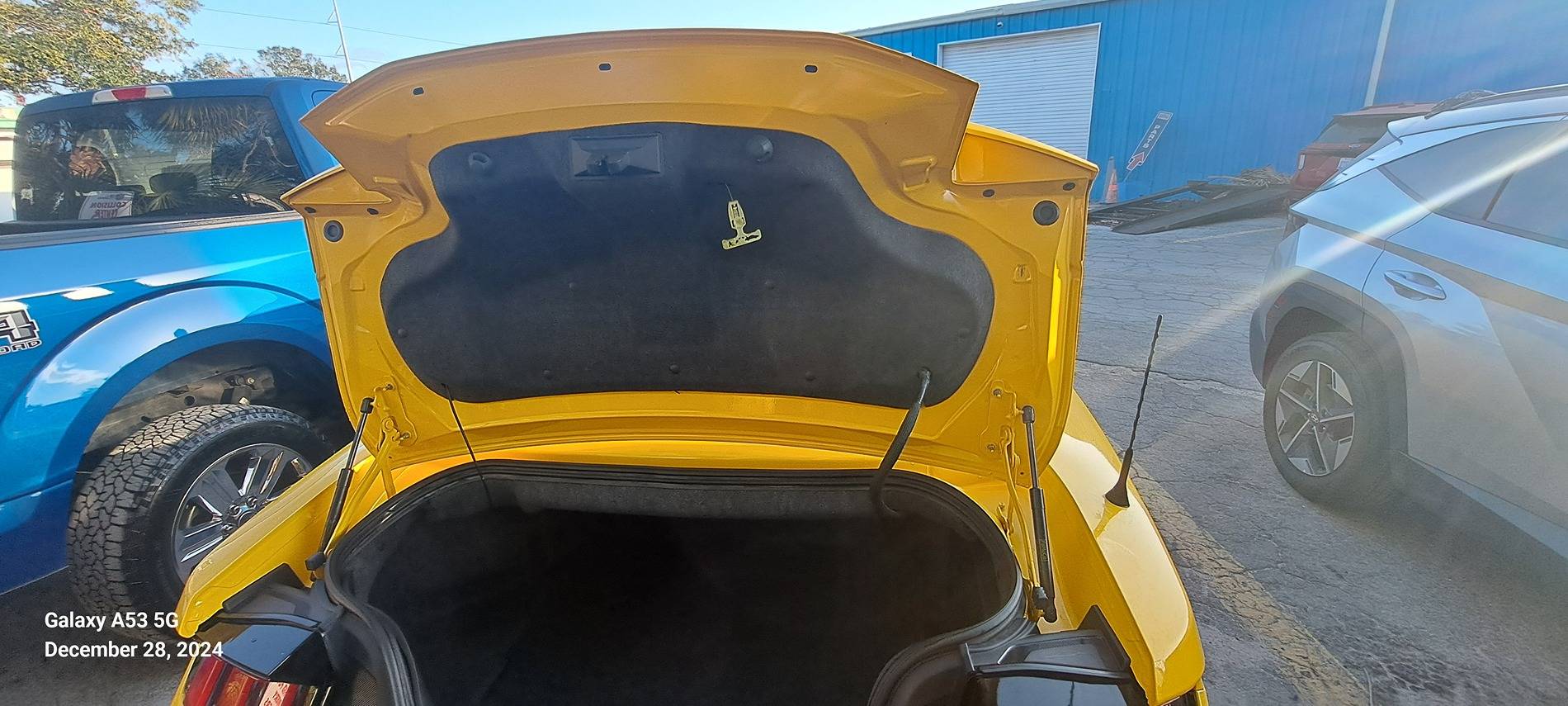

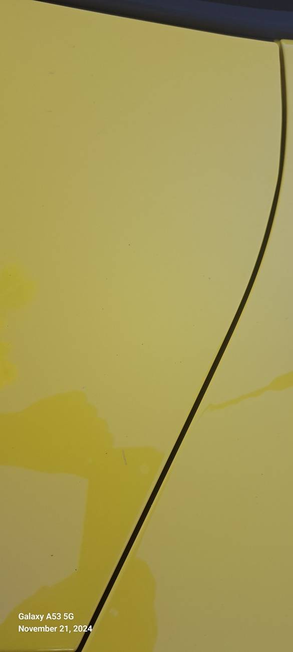

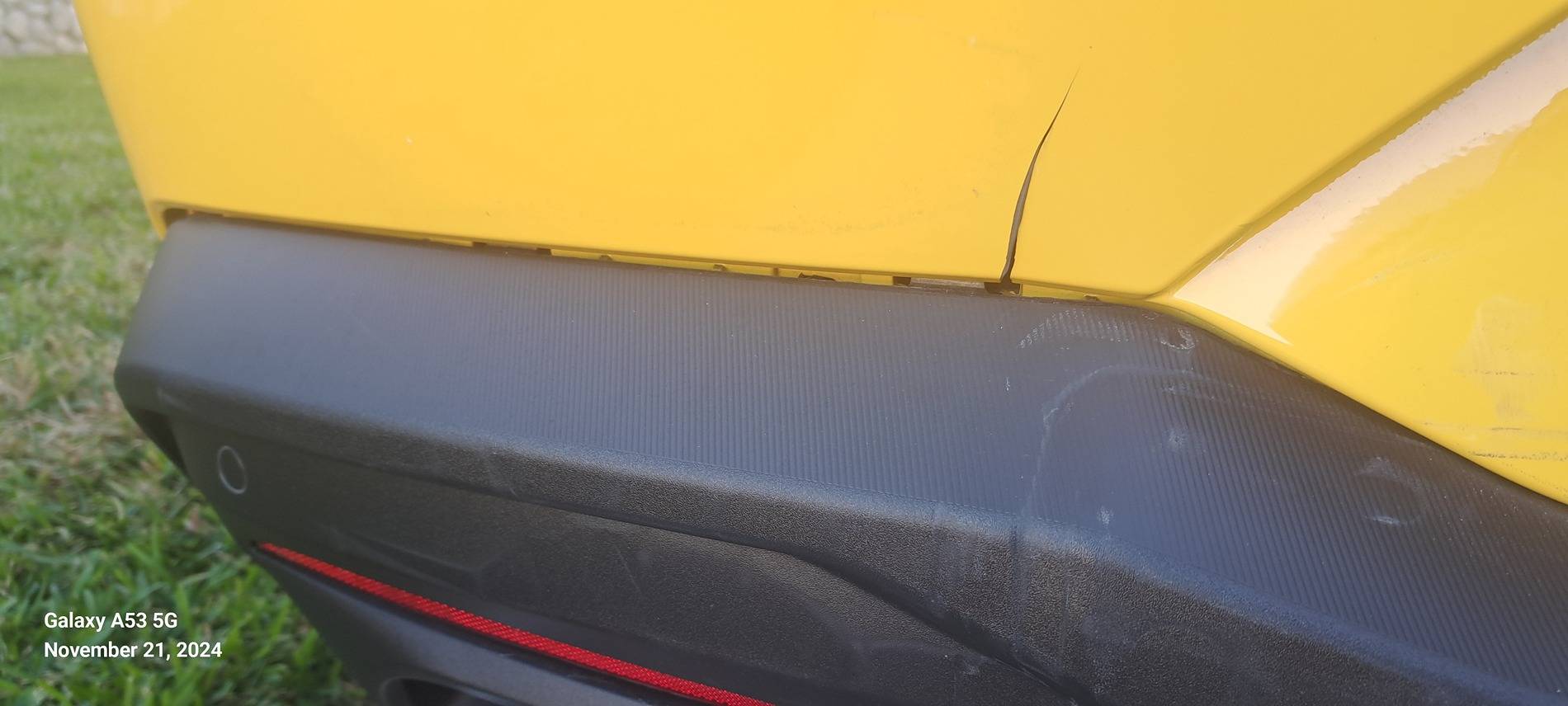

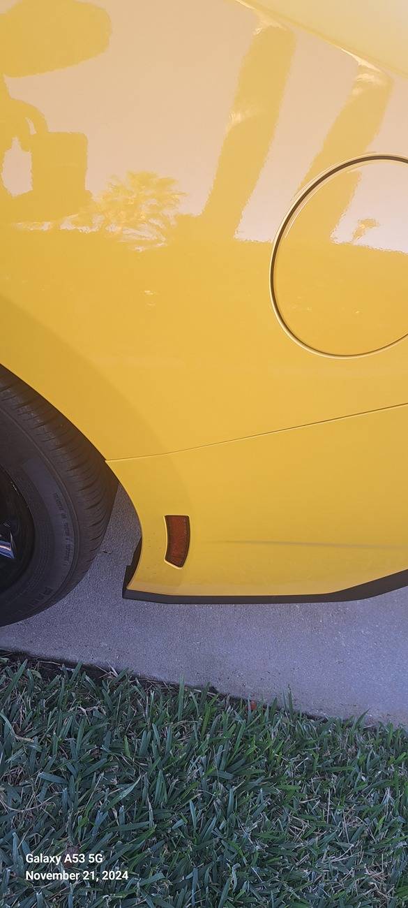

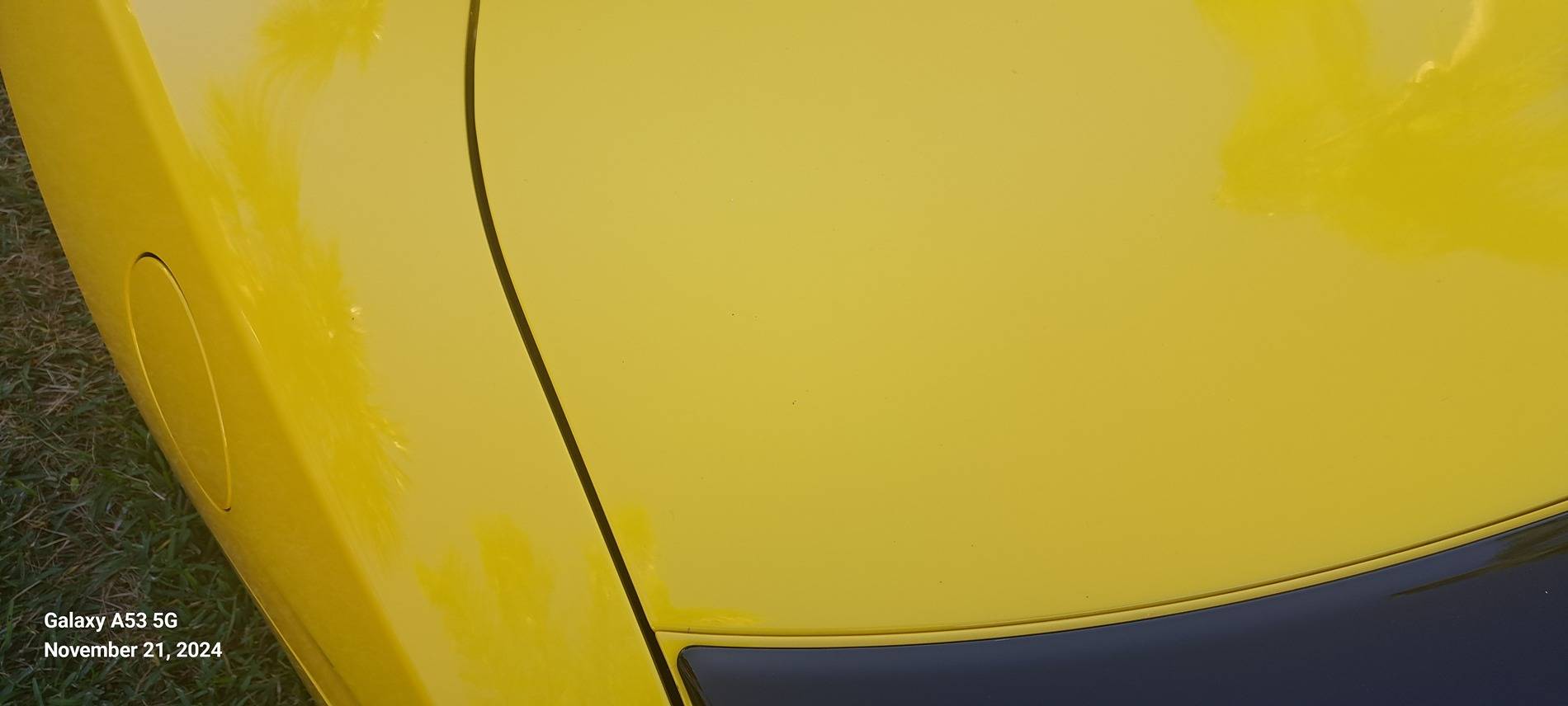

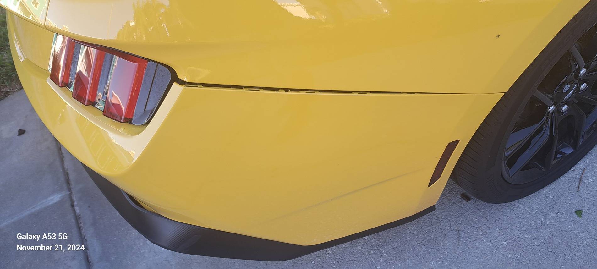

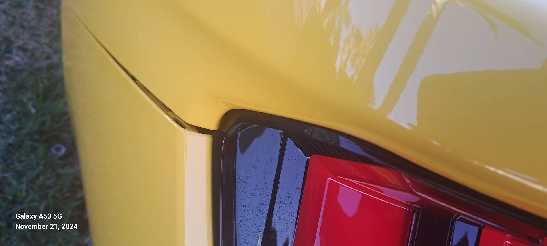

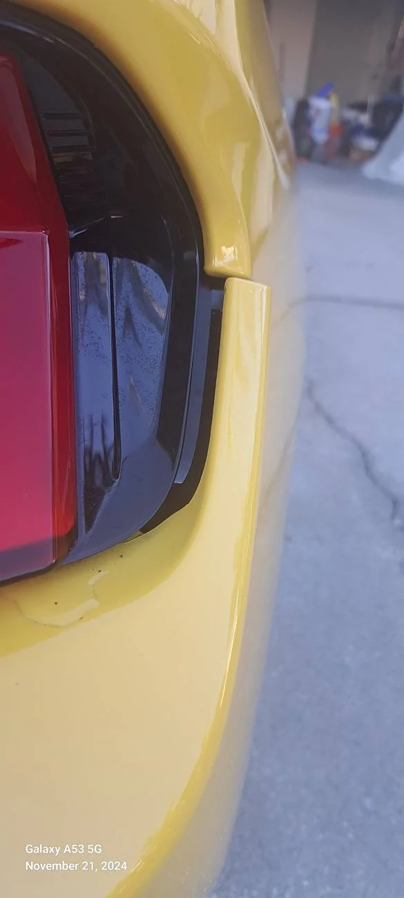

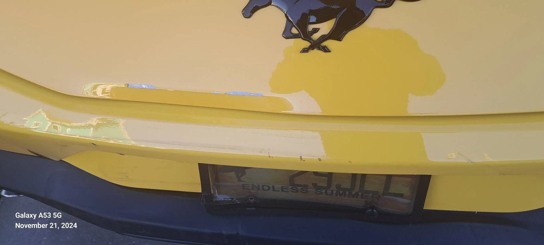

car has been repaired but they didnt tri coat the interior of the trunk lid just yellow no flake is that normal?? obvious when u open the trunk it doesn't match the car not sure i should sell or keep taking a 20 k hit if i sell it with bad car fax after 11 months 4800 miles hasnt had it 1st oil change yet!!
