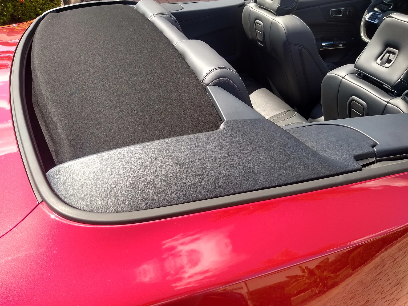

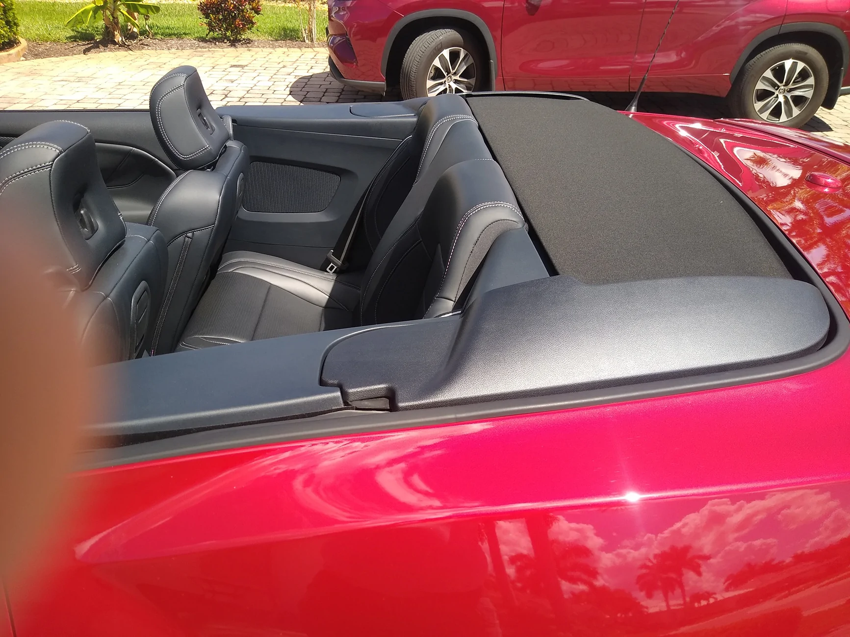

Someone posted once that the sensors for the fill in panels are still there even though Ford does not ship them with the car or even list them as a PN for the 7G cars, although the 6th gen car inserts fit and even then Ford stopped supplying them with the car due to concerns about the inserts rubbing against the canvas and damaging it.
But on my car, which is a 401A car, trying to raise or lower the roof causes all windows to go down before the roof will move.
