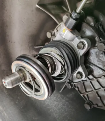

How does holding the clutch pedal down at red lights contribute to wear? I had a vehicle many years ago that I bought brand new, and sold with over 300,000 km on it and never replace the clutch. Over 200K km on the front brake pads. Car in gear, clutch engaged at every red light.
It leads to excessive wear on the throwout bearing.
I've seen throwout bearings overheat and wear out within 50K miles with the clutch still being fine. Bad habit that can expose flaws in an item that otherwise wouldn't have an issue.
Certainly not to say it will be a problem in every throwout bearing, but its common enough to be a consideration

Interesting! I have no idea what a throwout bearing even is LOL. I'm going to research it. So what your saying is best practice after downshifting to a red light is to sit in neutral, clutch out?
Theoretically, yes.
Its really just a probability game that you're playing, as with anything.
What are the odds that your throwout is predisposed for failure, or the design is -to a degree- already not ideal? What if the bearing already has some grit in it from the X amount of working hours it has seen? By sitting on the clutch and keeping it spinning for a longer period of time, allowing it to get hotter and hotter, and keeping that force pressed up to it, you're just increasing the odds that it goes bad sooner rather than later. I have personally seen it a few times myself in customer cars. Customer complains that the clutch isn't engaging correctly, or that theres a loud groaning when they put the clutch in, so you take the tranny out and see the throwout is completely toast.
In most of those cases, the customer does, in fact, sit on the clutch. Its just how it goes.
Its just like smoking cigarettes. Smoking ciggies doesn't automatically cement your fate of having lung cancer, though it greatly increases your odds.
