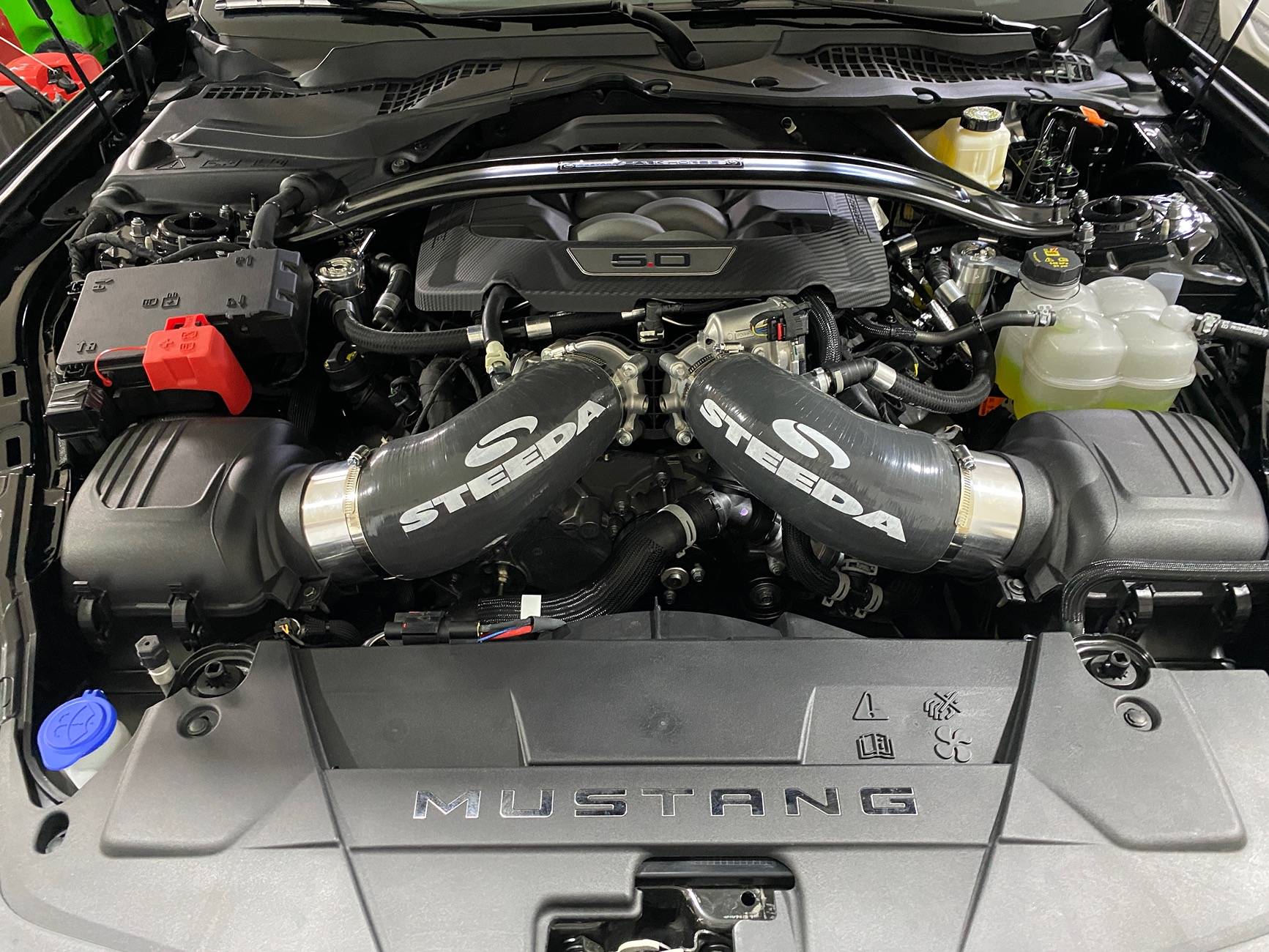

Your induction tubes gives you rough breathing and has restrictions and would recommend smooth tube Steeda induction like mine without anything in it below:

Seeing these S650's trap 121+, I think the dual intakes mitigates that issue, His bigger issue is those 315 gears with a 28.5" tall tire.
A shorter and lighter DR/wheel and that would likely have netted a 11.6xx.

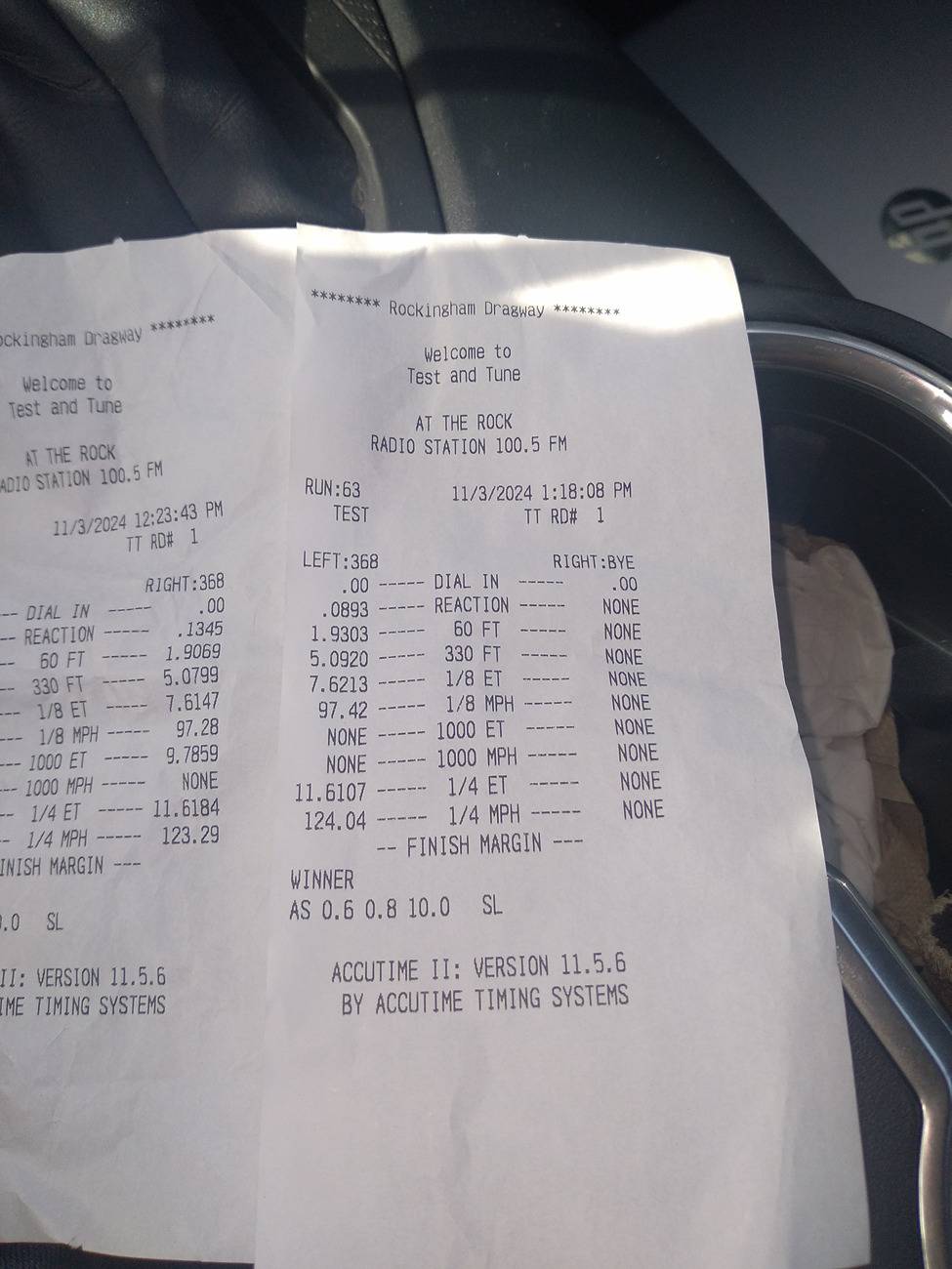

No LT's would not be the 1st choice for going fast down the strip...
Pulling a couple hundred pounds off the car is cheap and easy and will net real gains.
I ran 11.61 @124 on a 275/40-17 Hoosier DR2 on a light weight 17x9 wheel, and 160lbs removed from the car.
Still rolling the stock fronts.

Impressive with only a 1.93 60 foot time- that is some good MPH on a stock car ....given just a little weight reduction. and tires......

Those Hoosiers are only 25.5in so they kill the 60ft, but they take advantage the Yote's high rpm powerband with the 3.15 gear.
I cut 1.81xx 60's on a taller Nitto DR.
I can still pull another 120lbs off the car, 180 dumping the exhaust.
