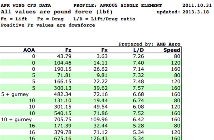

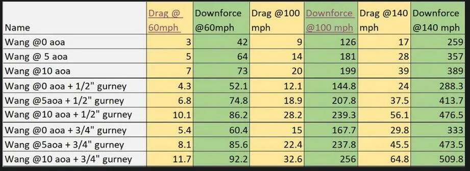

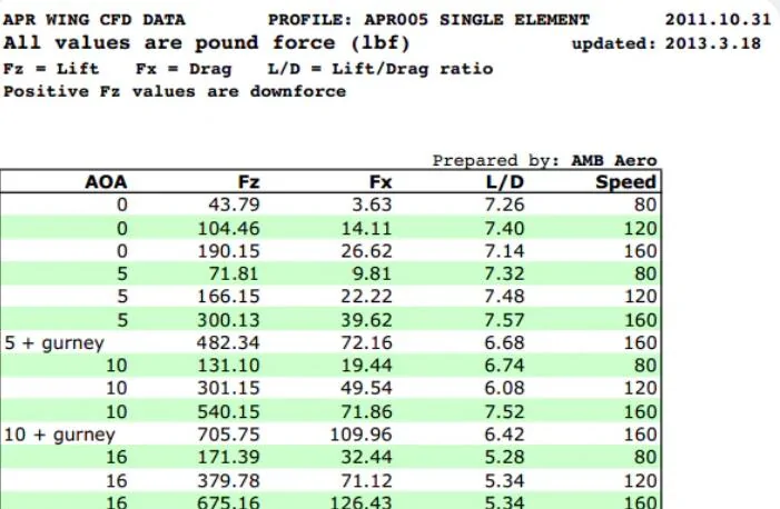

Ok. I am home now. All the data I have seen in wind tunnels is on wings so the spoiler will have a reduced affect but the principle is the same. I legit could not find any studies (other than the college kid I linked below) on mustang spoilers and gurney flaps with hard numbers.
Let's see if I do this right. This is data from Nine Lives on the big wang -
Here is APR with their 71" GTC-250 wing -

FYI, the flap in that link generated downforce not of 60kg but 110kg, or 242 pounds, almost twice what you posted.
Your points are otherwise clearly understood, though, and it makes me wonder whether a really good driver could post better, same, or worse times on a high speed road course with v. without the gurney flap installed.
Did it not say the standard wing was 60kg hence the 120kg with the gurney is an additional 60kg as I said?

The 60kg was without the Gurney Flap. It is 110kg (or 242 pounds) with the Gurney Flap.
There are tracks where cars are close to that speed in some high speed turns, and there is still significant downforce at speeds approaching that level (lots of tracks have 90 mph turns).
Yes, it comes at an expense of increased drag, but there is a reason racing teams use this stuff - just look at the post linking the story of why this is called a "Gurney Flap." It is linked in this thread.
