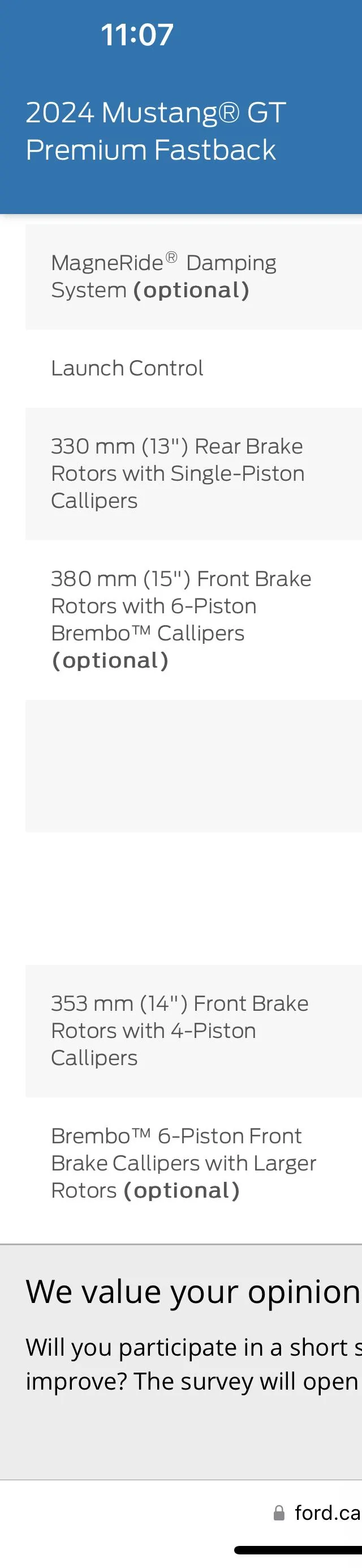

Here are the tech specs for the 2024 lineup. Seems to me like the standard brakes must be Brembo considering the logo is right there. It's interesting that Brembo is explicitly called out for the front brakes but not the rear as optional.

This is what I saw that they were optional and standard was a 4 piston break in the front I also don’t have slotted or vented rotors.

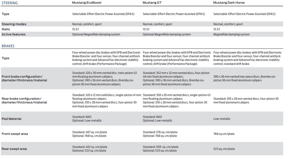

3. The $1600 option takes you from 4 piston fronts to 6 piston fronts and single piston rears to 4 piston rears. The brake disc diameter, caliper size, and brake pad material are all enlarged/different than the standard brakes, both front and rear. Option also includes braided brake lines.
4. Now reading the specs, the front discs are 33% larger and rears only marginally larger. The brake force should be quite different though thanks to caliper force.

Yes four piston brembos are standard on the GT. Six piston red are the optional.

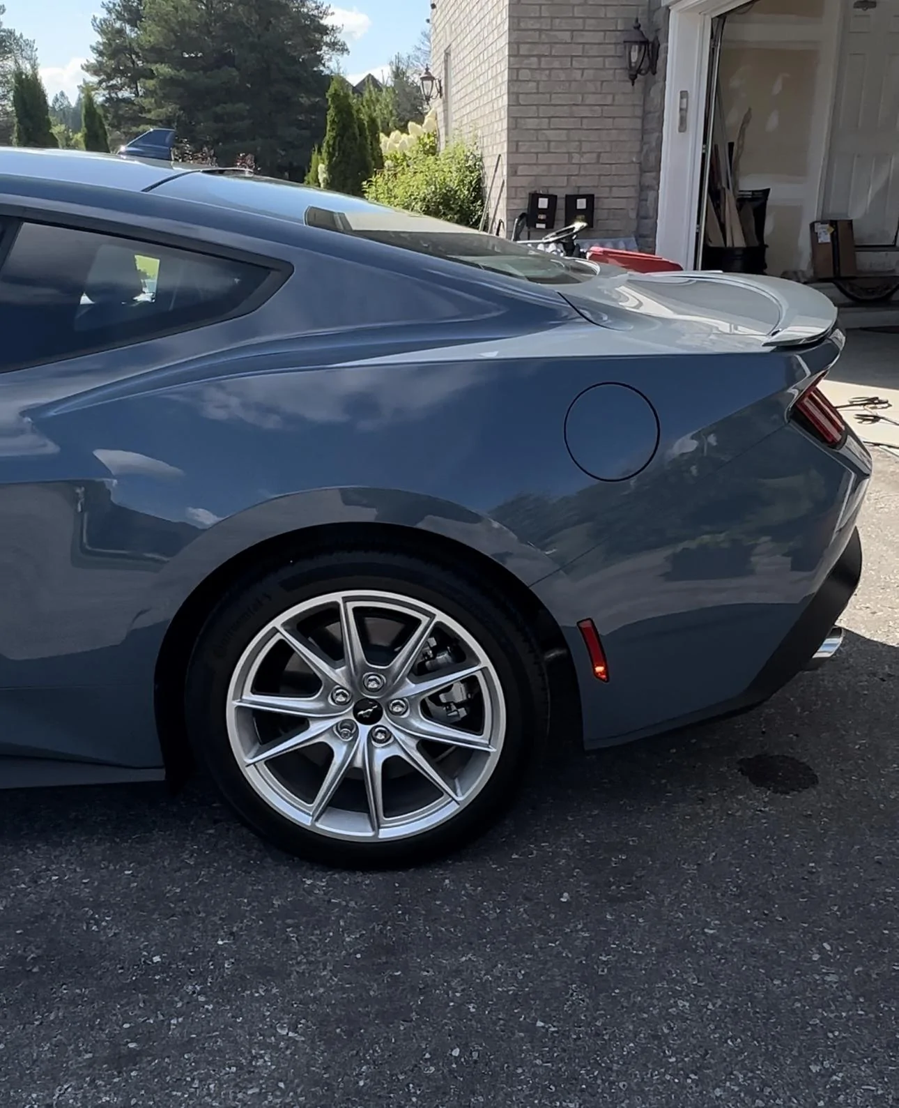

Any chance you could post pictures of your front and rear wheels, a little further back so the whole wheel and tire are in the image? I'm really curious to see how the standard brakes look with those wheels. Thank you.

Yea definitely I’ll post a pic with I get back today.

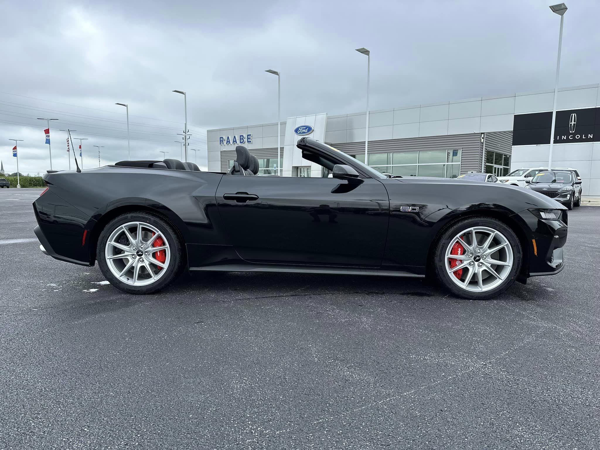

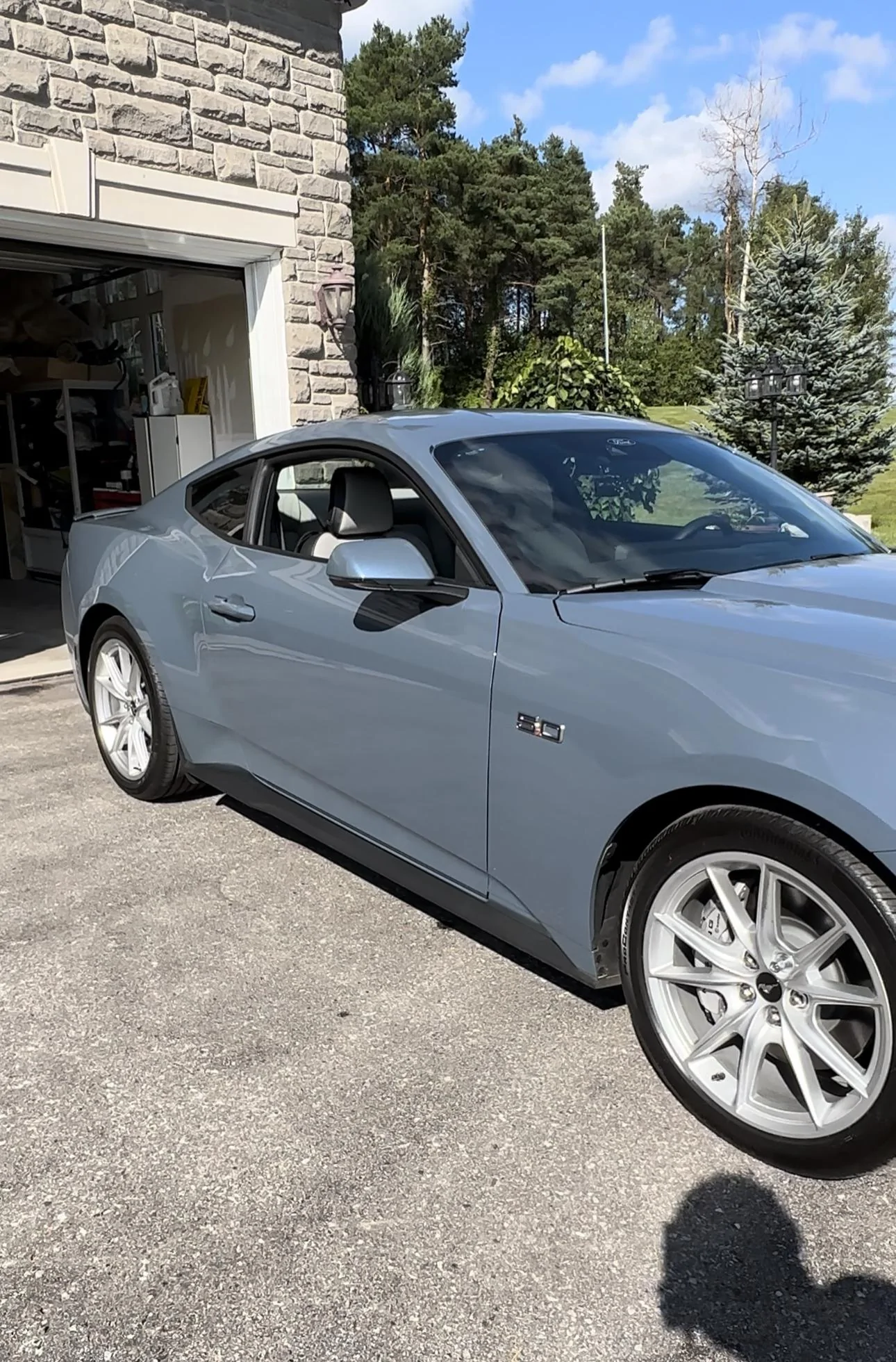

That looks really good, thanks for posting. Beautiful car. Can you do me one more favor and post a straight on pic of the front wheel and tire so I can get a good idea of how the brake caliper sits in there? (I'm needy LOL)
One weird thing I noticed from your photos is that the rear caliper is towards the back of the wheel. On the ones with the red brembo calipers it's placed towards the front. Can't figure out why they would be different?

Yea I’ll take one today and post it. And I think the one you posted is the Preformance pack cause I think I see the small drift brake on the rear. Maybe that’s why they have the Brembos towards the front ?
