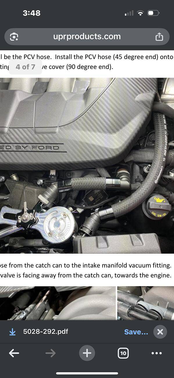

if you dont mind me asking, thats the passanger side one right? do i need to get the driver side one as well? or would the passanger one suffice?
Passenger side is all you need for spirited street driving.
if you regularly track or auto cross the car get the driver side too.

sweet thanks for the info. i normally do spirited driving so the passanger one will work for as of now. but i want to get into autox and tracking it. im guessing i can just but the driver side one at a later time and have no problem installing it
Yep, that’s a good plan. I may do the same

one more quick question. do u think it is worth it to do the CSCC add on as well, it says it does the driver side as well. if it does that might as well get it already

What’s a CSCC add on?
UPR CSCC: Clean Side Catch Can for the Driver side of the PCV system to make sure you are fully protected at both ends of the PCV system. (Great protection and ideal for all driving situations). The Clean Side Catch Can allows fresh, filtered air from the air filter box or inlet tube to enter the crank case as the factory intended, but will separate oil vapor and keep it from exiting the clean side when crankcase pressure is high.
that is the description on the website. it is a $150 option

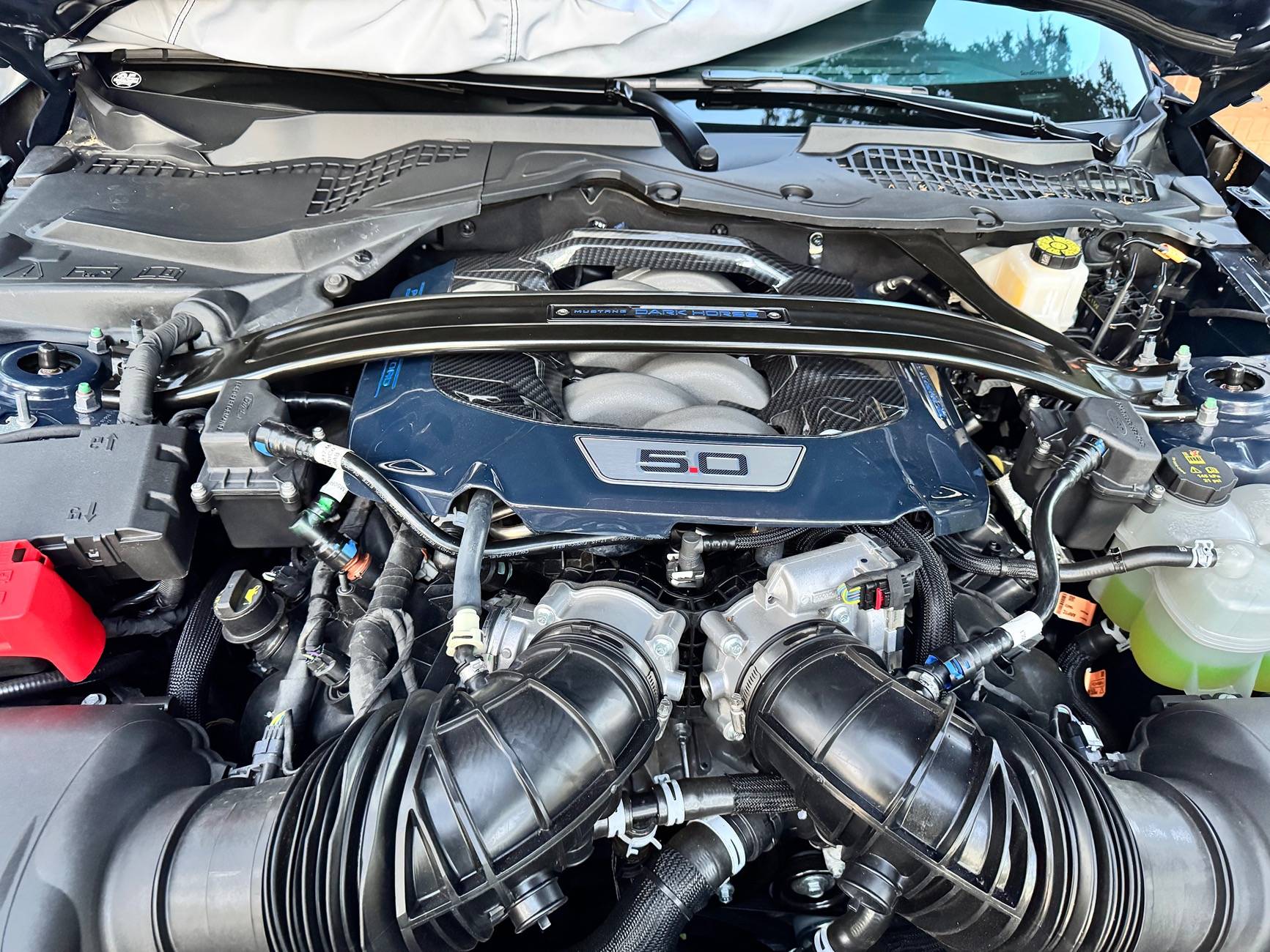

I have both the passenger and the driver side.
After about 800km since the Whipple install I checked both.
PASSENGER = maybe a tea spoon of oil
DRIVER = completely empty
I would say that you don't NEED both :)

We just discussed this , driver side catch can not needed .. lol
