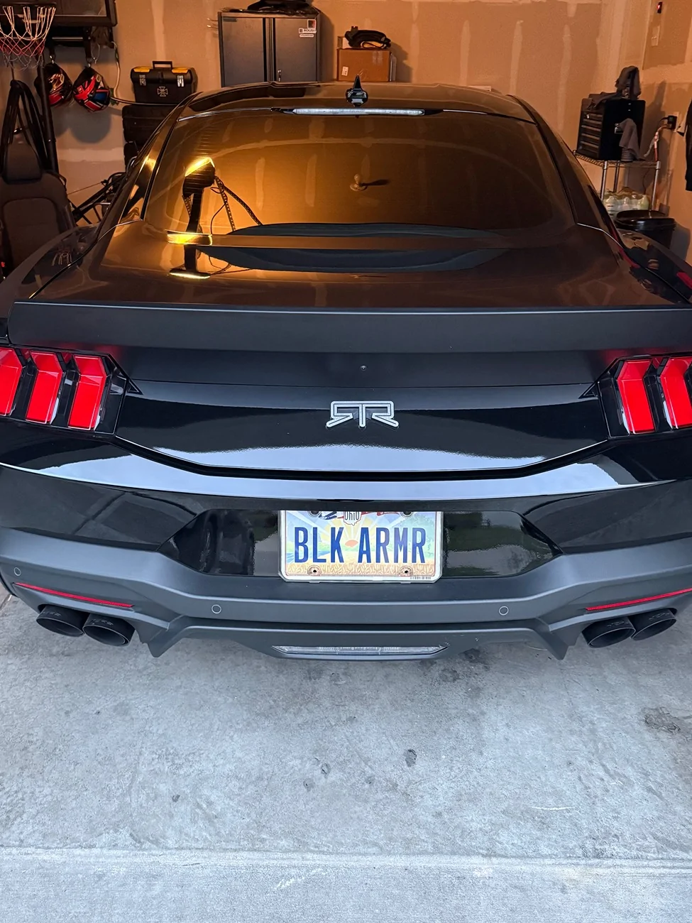

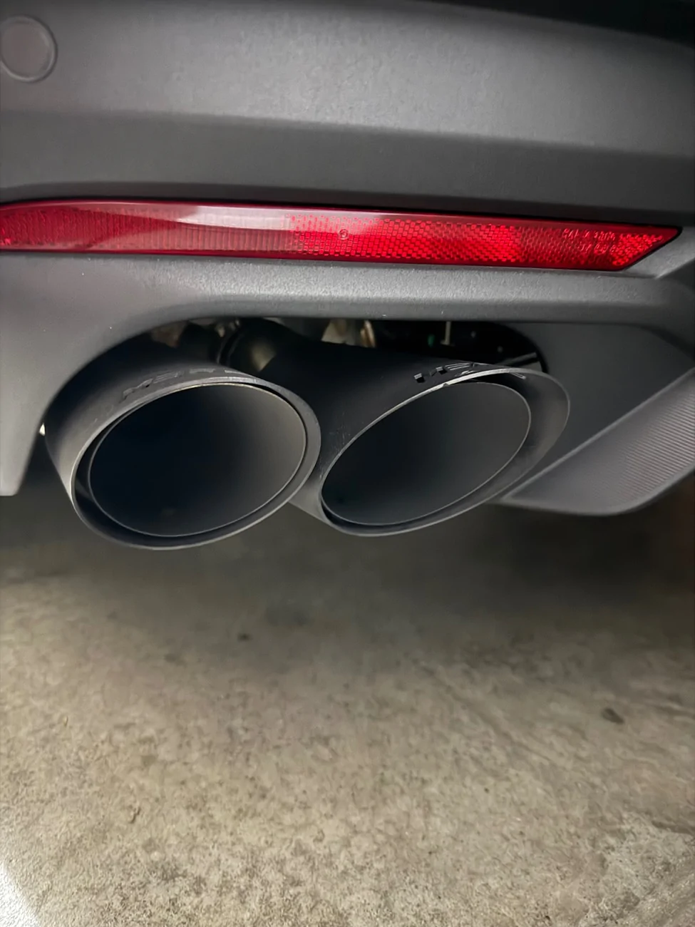

I bought MBRP black tips that bolt on over the factory tips. I then used high temp flat black grill paint on the inside of the pipes. It works for now.

It’s not perfect but better than the factory tips imo and for me it’s temporary.
They are bigger. I like it. Sell em to me if you get rid of em lol. I doubt I’m changing anything else so for me it wouldn’t really be temporary.
Interesting they do look pretty good honestly. How did they bolt on? Not sure how that works.
they have a template. You drill one hole in the bottom and 2 bolts hold it in place. It uses the factory drain hole as one of the holes for each tip.
You drill into the MBRP or they want you to drill into the factory exhaust tip? Because if it’s the factory tip then fuckkk that
