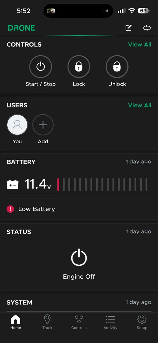

It was showing low low voltages, car wouldn’t even start at some point but yeah maybe ur right I just like the ease of not worrying for a few years
How are you showing the battery voltage like that? Is that an aftermarket app or something? I dont think it have anything like that.

My 24/7 dash camera’s app, dronemobile
It’s hardwired so it can start, turn off, lock and unlock my car along with tell me if someone door dings if my car shakes or vibrates. Not sure exactly how, I think it connects to some sensors in the car
