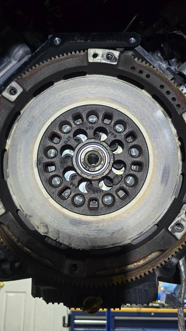

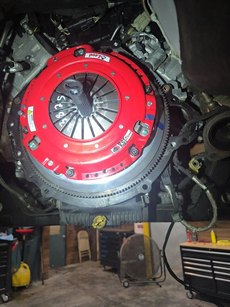

Anyone finally upgraded yet
Installing a mcleod rst right now, also doing mcleods braided steel clutch line, a new throwout/slave and an MGW short throw. Should be done within a few days (Im doing this all in my free time) will hopefully remember to post how it goes. Also only doing this because factory dual mass flywheel failed.
