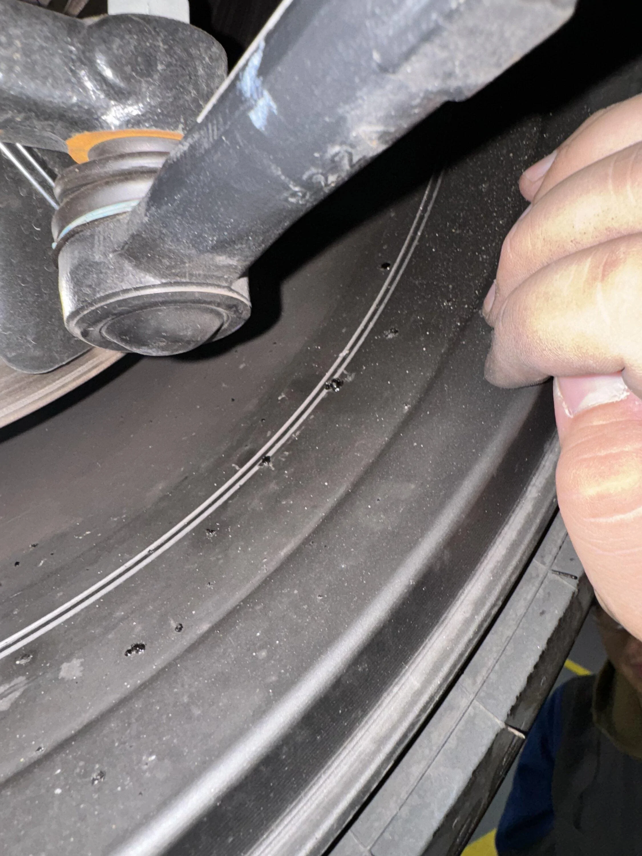

Good Morning Everyone, I've been hearing this sort of clunking noise coming from my dark horse handling package for about the last week or so, it only seems to do it on light braking. I had a ford tech look over it and they couldn't find anything but when I put it on a lift my lower control arms seem to have a lot of play which i'm not sure if that's normal because this is my first mustang, i also noticed scrape marks going around the entire inner wheel so something has to be wrong, any advice or feedback would be appreciated!

LOL no that is not normal. WELL maybe it is now considered normal with Ford's junk quality they keep rolling out of the factory but for any new car it is not normal at all.
As a general rule, if there is a 12 o'clock / 6 o'clock wiggle it is probably a ball joint. If there is a 9 o'clock / 3 o'clock wiggle it is probably a tie rod. If it is wiggling all over, it is probably the wheel bearing.
Get another opinion from a different tech/dealer. Tell them that you jacked the car up in the air and are noticing the wheel wiggling. Take a short video of it too and show them if needed. Sometimes it can be a lot of work to get a dealer to fix things that should not have already broke. They are especially not motivated to help you since it would be a warranty fix... let me translate: no money for them to make.
Without fixing this, the clunking will continue and eventually get worse as it gets more worn out.

I am in service at a Ford dealer, and I assure you that we get paid for warranty work, and pretty well. I don't know where the myth started that we have to do it for free, I have never worked for a manufacturer where that was the case.
You said you had a Ford tech look at it, was it at the dealership, or someone you knew looking at it as a favor? I'd agree that it does not sound normal, but what we often end up doing, especially with a new model, is comparing it to another car to see if there are any differences.

Took it to a dealer, he test drove it and didn’t hear it, so I took him for a ride and got it to make the noise, he said he looked and “everything looked good”

You said "no money for them to make". I'll take warranty work all day long, just fix it and move on, no one to argue with or have to sell something to.
Regardless, that does not look right to me. I don't know how someone can ignore witness marks though. You should not have to, but you might take it to another dealer. In our area, we are the "second opinion" dealer because some of the others don't seem to care and will broom something that looks like it might be a problem.
