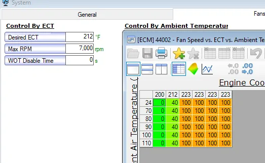

With my tunes, I set the grille shutters open 100% all the time and set the fan to come on at 180 and not 212 like stock. It helps a ton. I wouldnt do this on cars that will be driven in winter locations. But in summer in FL, its been great.

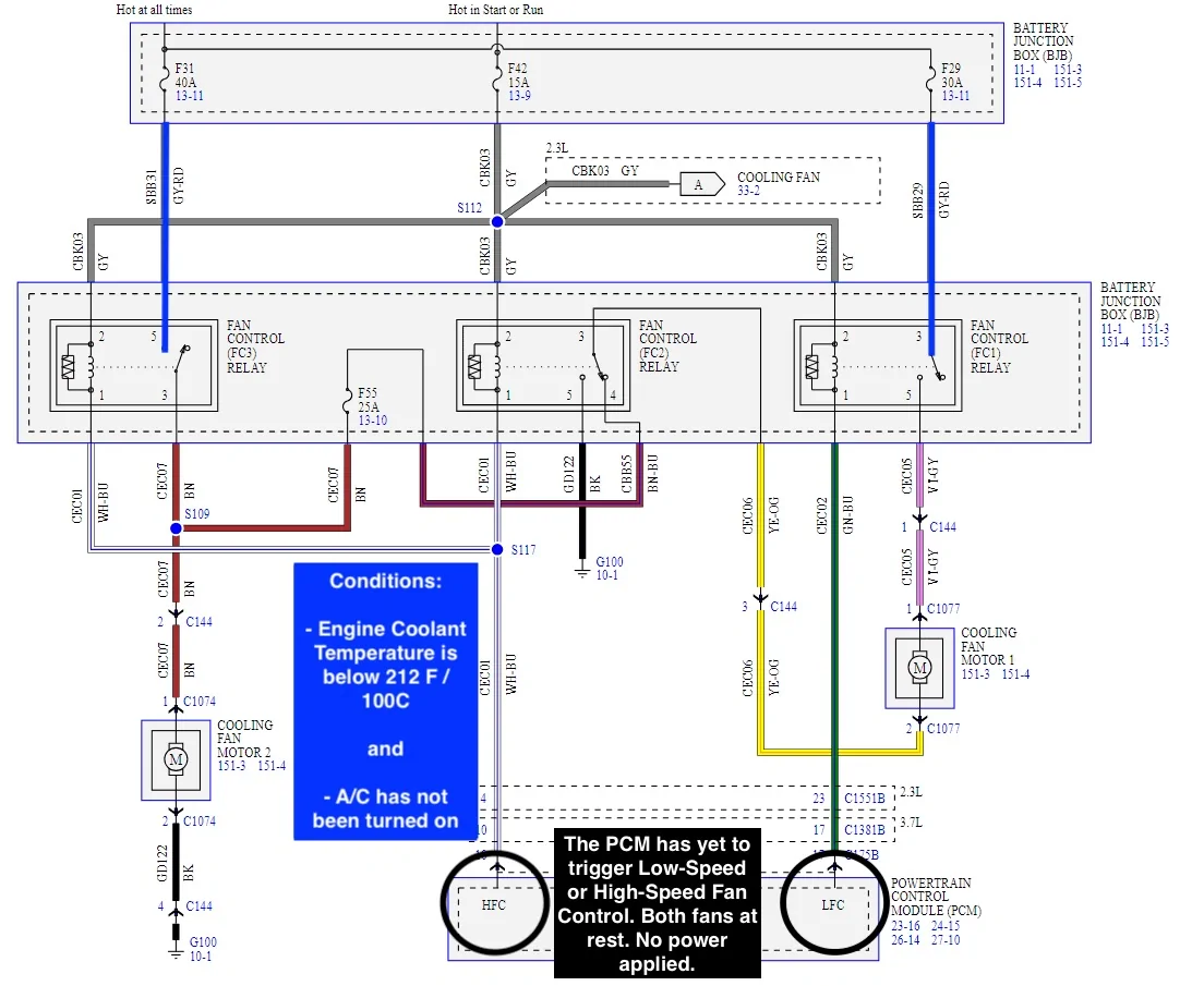

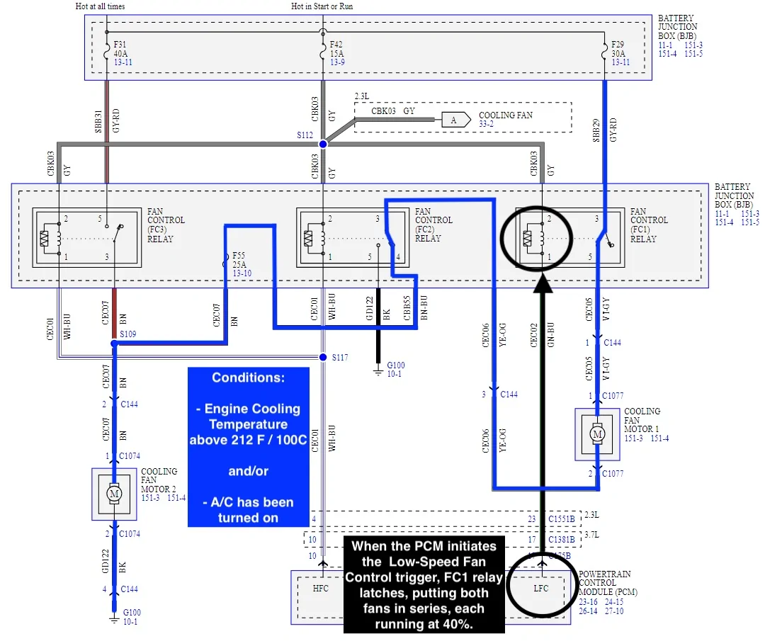

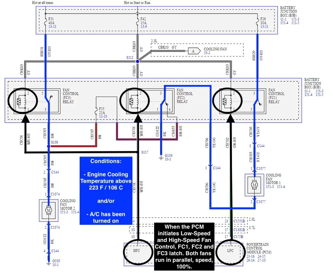

Attached are schematics, highlighting fan logic and operation in a 6G.
Before delving into switches for the fan assembly, I'd consider two other factors:
- Airflow across the front of the car, into and out of the engine bay. There are several track cooling threads and sites, all with tips on how to maximize cooling with modest to extensive changes
- Process. The motorsports I follow, drivers will have a warm-up, hot laps and later cool down period. On the street you cannot always choose when or how long you cool down, but you have an out for that: the A/C unit; turning the system on will engage the fans when the car is slow or idling.
As to specifically cooling the intercooler while driving, IDK if the fans being on would be much help. I think maximizing airflow into and out of that area would be more beneficial. [Edit: to include relocating the intercooler or buying a larger one. ] For example, you're already moving forward at a given rate. Having that, then a fan, šŸ¤·ā€ā™€ļøšŸ¤·ā€ā™‚ļø. How much more air is a fan going to move? But if you've adjusted the area, making it more free-flowing and possibly concentrated, that could have a more positive effect.
YMMV.
S650 Mustang Cheap HP, full time fan? cooling fan schema high speed
S650 Mustang Cheap HP, full time fan? cooling fan schema low speed
S650 Mustang Cheap HP, full time fan? cooling fan schema no speed

Do you know if changing fan operations can be altered via forscan…
I'd like to think so. In post #10 above, that graphic of the temps and fan load, that's a capture of someone's tuning software. But also in post 10, I wonder how effective a fan would be, at speed. If I'm already jammin' around the track, the fan spinning might not help all that much. Fans at 100% during cooldown laps and before or when returning to pits, that could be useful.
