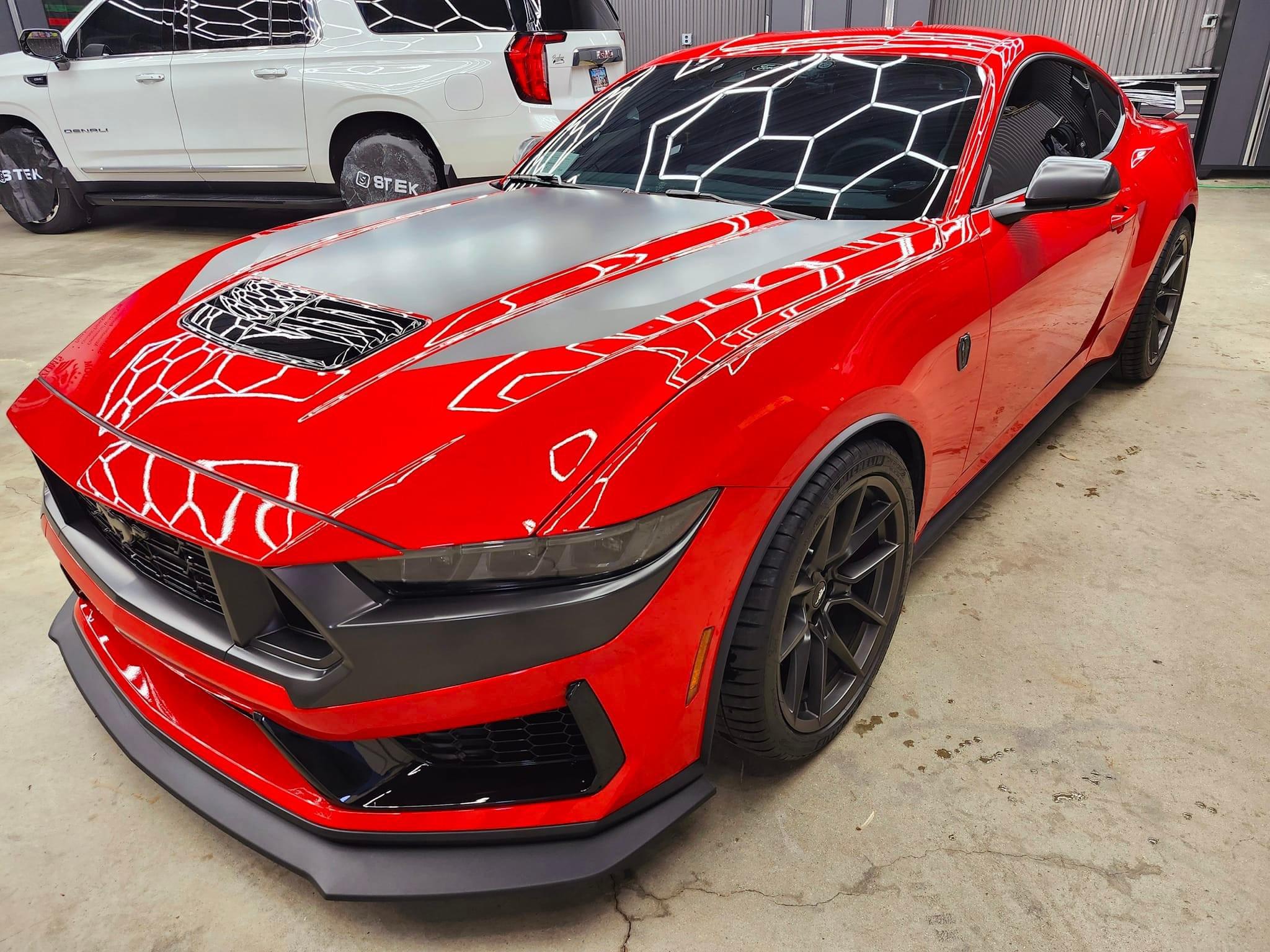

S650 Mustang Ceramic Coat on the Dark Horse Install Complete! IMG_2493

Damn!!!! That looks GREAT! 🔥

I had a Stage 1 Paint Correction done first then the Ceramic done by a professional installer.
Whole process took about 5 days.

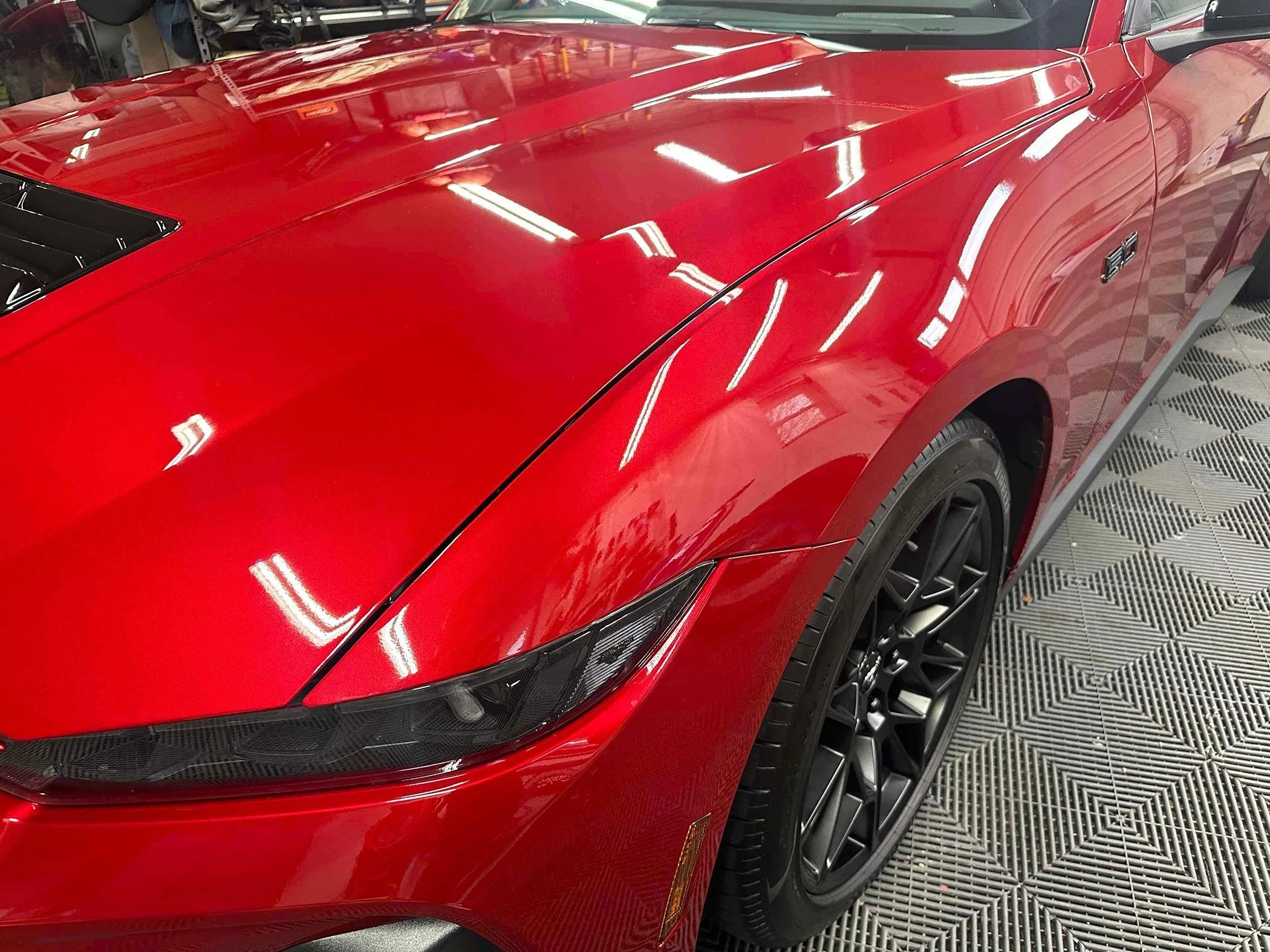

Our local detailer uses the product System X Max Ceramic Coating. There's lots of ceramic coating brands out there and I'm sure all are pretty equal. What sold me, outside of the bio on the product, is the lifetime warranty and that the detailer has been doing this since 2015. Picking it up later today and then it sits in the garage for 4 days to allow the coating to fully cure.
Process is very complete:
  • Thorough exterior wash
  • Tires, rims, and wheel wells cleaned and decontaminated
  • Chemical paint decontamination via iron remover
  • Mechanical paint decontamination via clay bar
  • Paint correction (extent will be determined after inspection of your vehicle’s paint)
  • System X Max Ceramic Coating (available in G+ Hyper Gloss or MF Matte Friendly)
  • Installation of a ceramic coating paint protectant
  • Reported to Carfax
  • Lifetime warranty
