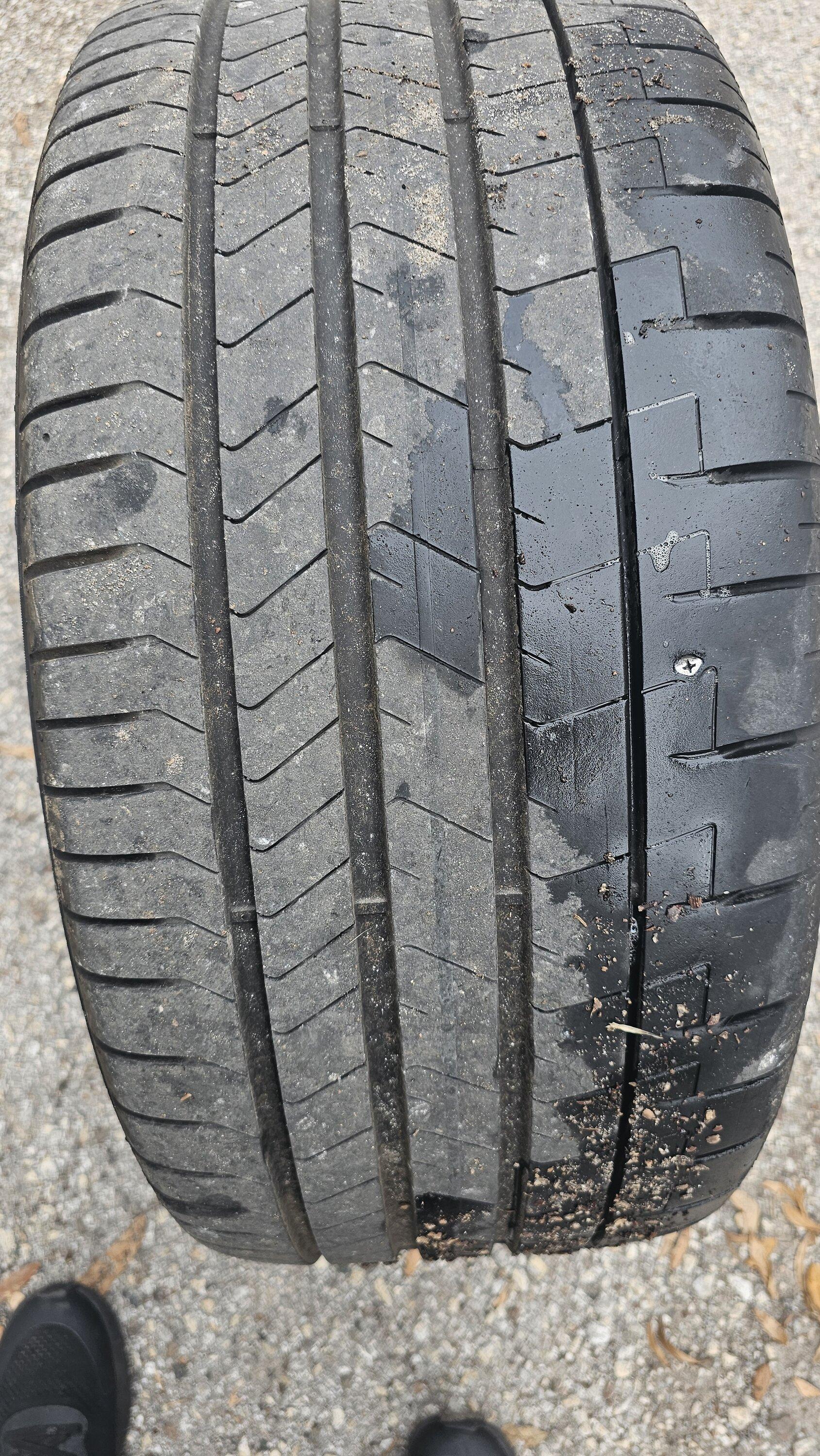

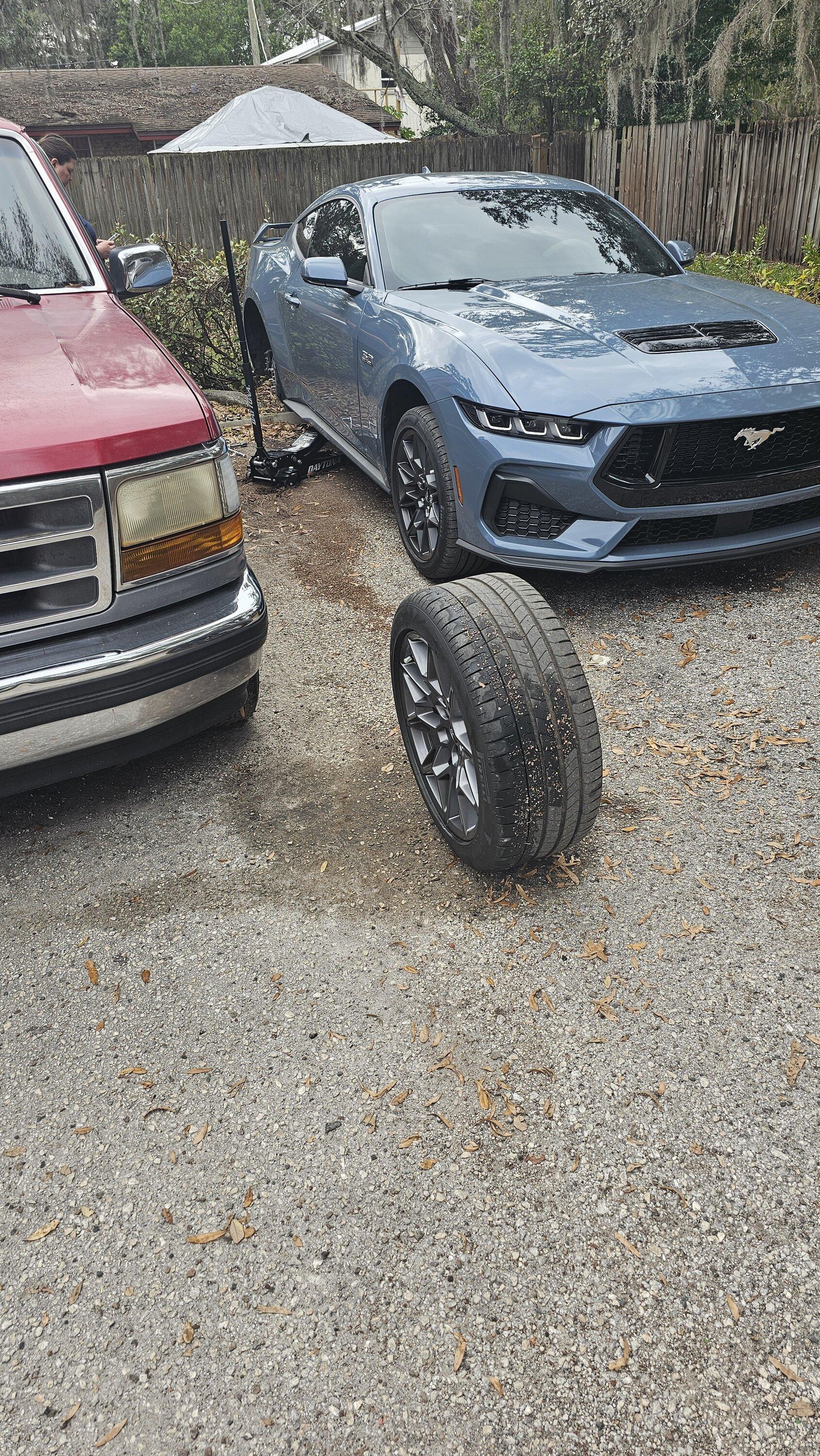

Caught a screw before my first week. Didn't start leaking until today
S650 Mustang Caught my first screw before my first payment 20240118_111652
S650 Mustang Caught my first screw before my first payment 20240118_111353
S650 Mustang Caught my first screw before my first payment 20240118_111500
Not too happy with where the screw is, I usually just plug them but in a car that regularly sees high speeds.. idk
My last mustang had one directly in the sidewall and it held up fine until it smashed into a camry

Tire shops won't touch it because the screw is ever so slightly angeled towards the outside of the tire

Yeah they said it was far enough over to patch but because it was angeled a little outward it wasn't able to be fixed. I'll just run it, it holds air as long as Temps don't go below 45 which rarely happens in Florida

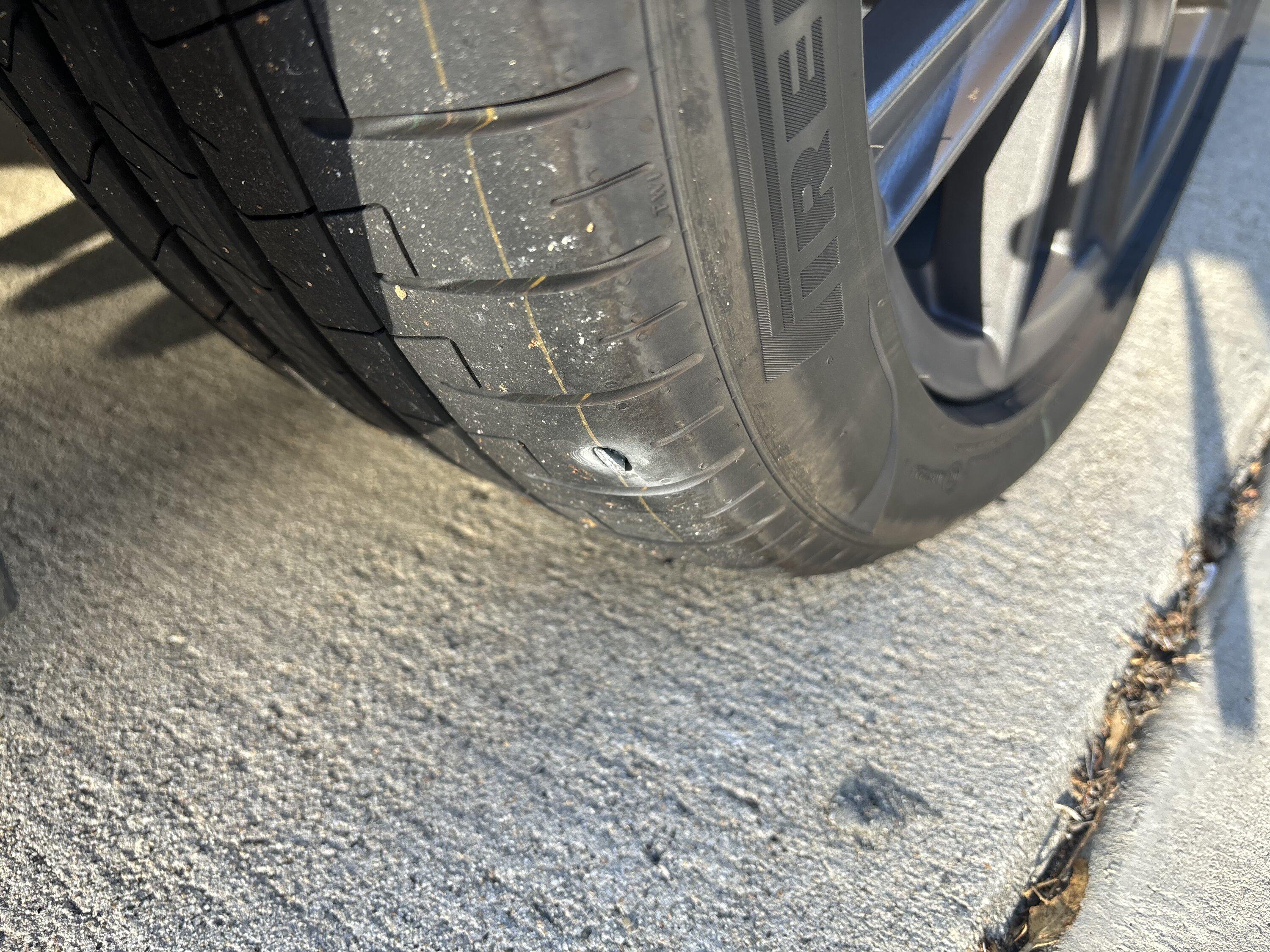

Welcome to the club!
First time out heading to work, backed out of the garage, and noticed the 8psi warning on the dash.
Discount Tires fixed it for free. Bought a warranty on the tires from them, too. You can do that, even though the tires are from the dealer. Great investment. Love them!
