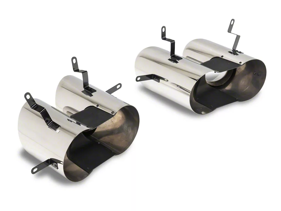

There is nothing on the car for these brackets to attach to. Im pretty sure these are designed to bolt to that specific MP concepts valance.
Gotcha that would make sense. I figured you could probably screw it in the plastic on the stock valence but didn’t look much into it since it wasn’t black.
My thoughts exactly..... They would have to be specific to MP Concepts valance. Also appears the exhaust would not mechanically attach to these tips. Having a fixed exhaust attached to any valance would not allow the slightest exhaust system movement........ until something eventually breaks like one of the thin attachment brackets on these tips.

LMAOOO yeah. Dark horse tips are fantastic man. Sucks they aren’t bolted. They’re part of the resonator, so the only realistic way to get them is to either replace a GT’s entire resonator (axle back) with a dark horse’s, or, cut a dark horses tips off, and weld it onto the gt resonator.
Why do people refer to mufflers as resonator? I seem to have missed that memo? The suitcase looking thing behind the transmission is what is referred to as a resonator. Is this like how the pound sign became a hashtag?

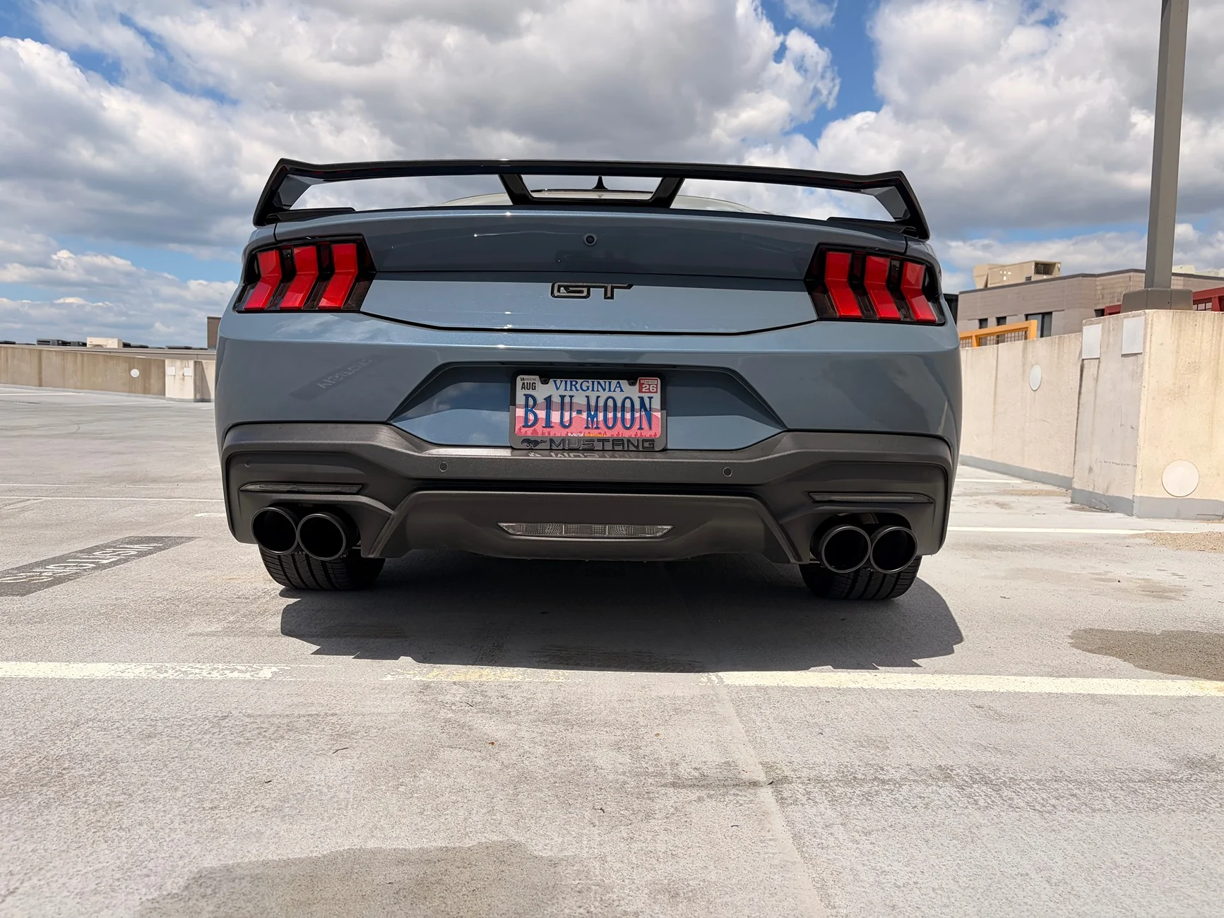

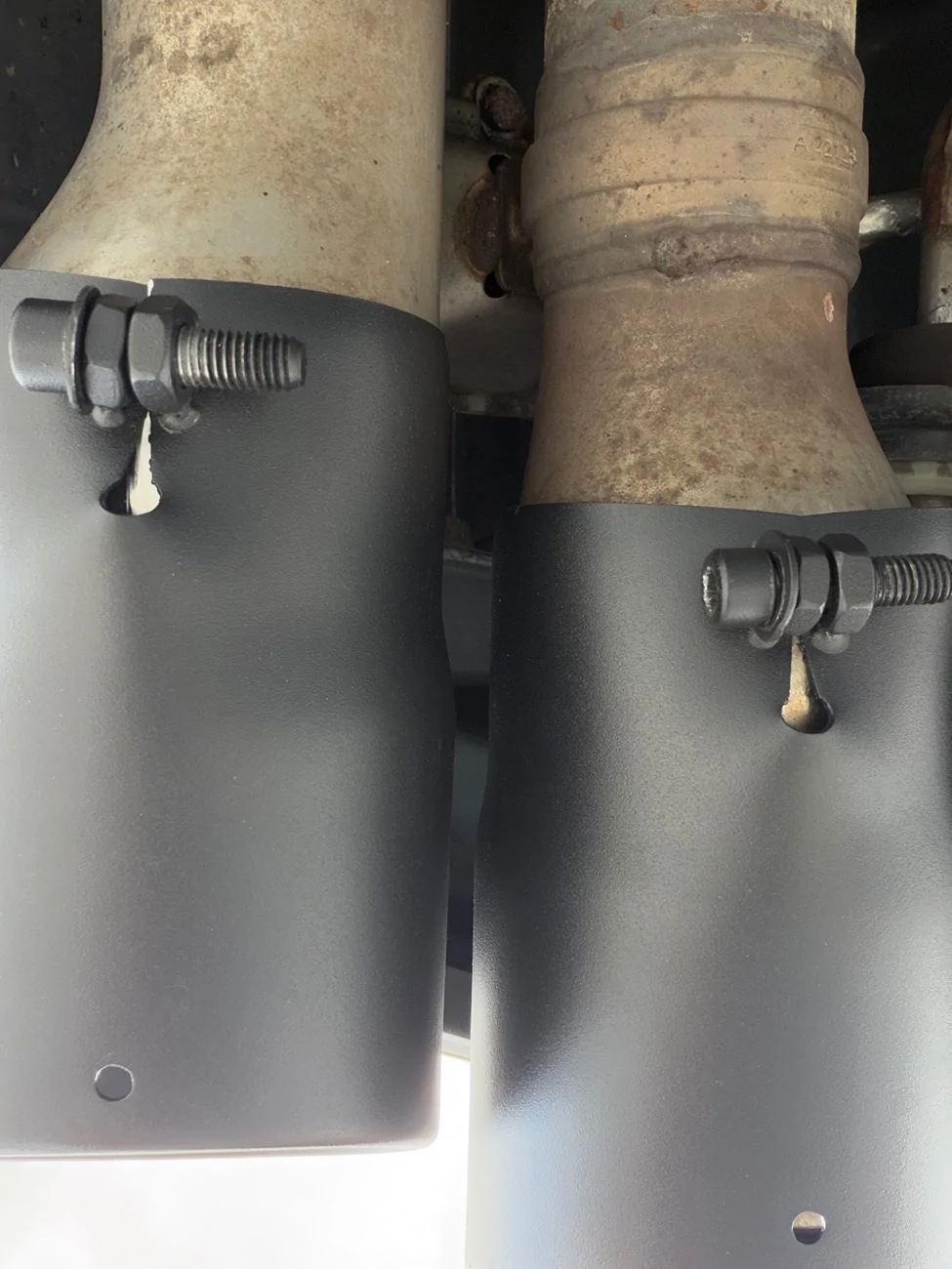

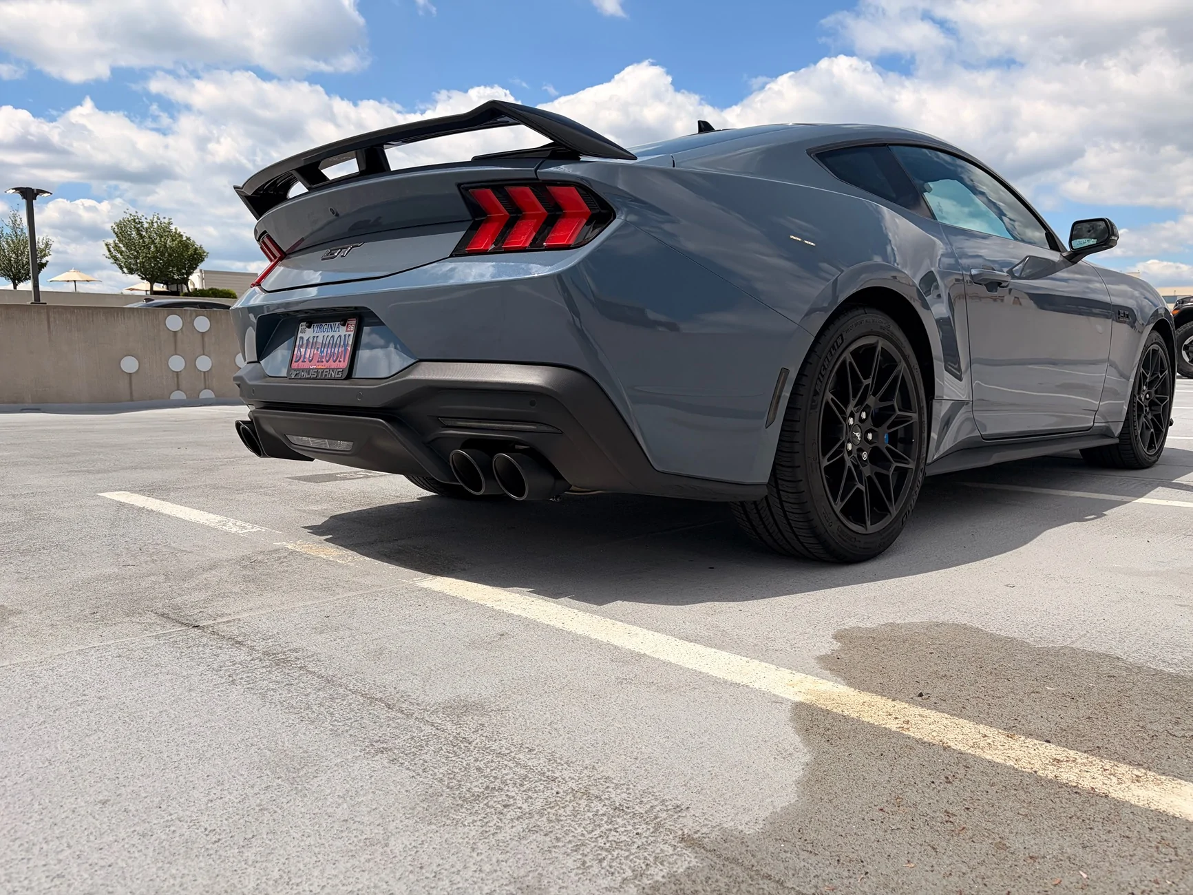

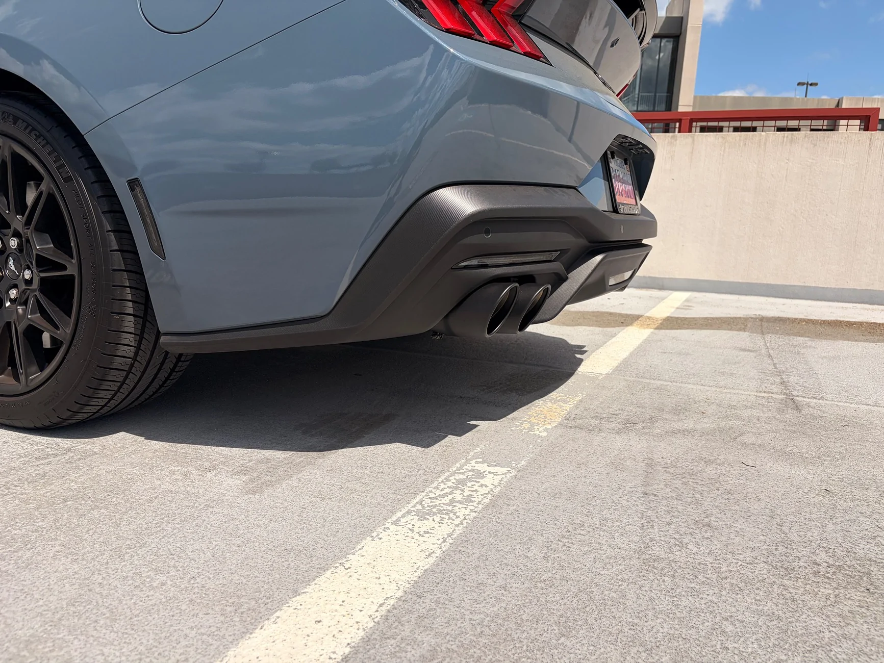

Update:
Using the exhaust wrap definitely isn't going to work, I wasn't able to fit it in between the stock tip and the new ones. I tried stuffing it in the back to fill in the gaps and that didn't really do anything either. But after tightening them down as much as possible they are rock solid to be honest. I tugged, pushed, and tried my hardest to get them to move and they are definitely on there. Removing them originally wasn't super easy either and took a good bit of effort even after the screw was completely loosened so I am definitely not worried about them flying off even if the screw comes loose overtime.
I did run in to an issue with the right most tip where that one isn't as solid as the other 3 and as you can see from the pictures the tips aren't level and the stock tips on the right side stick out further than the left so get both side equal I have to push in the new right side tips more and therefore the clamp doesn't have as much to grab on to. The right most tip is pretty much pushed as far back as it will go and I would say it is still sticking a smidge farther out than the left most side.
S650 Mustang Black Tips (Bolt-on Covers) for Active Exhaust Mustang IMG_2134
When my car goes in the shop hopefully next week to get the h-pipe installed I'll have them do their best to level the tips and also give their opinion on if the tips are secure. I might have them throw some welds on but we will see.
For those of you who were asking about the screws were visible, as you can see from the photos that they definitely are but only if you are far back enough and are looking for them I don't think you will see them day to day. Even with these few caveats I still love the look and for price can't think of anything better. For those on the fence I would definitely grab them and maybe have an exhaust shop chop off the bolts and weld them on for the cleanest/most secure install.
