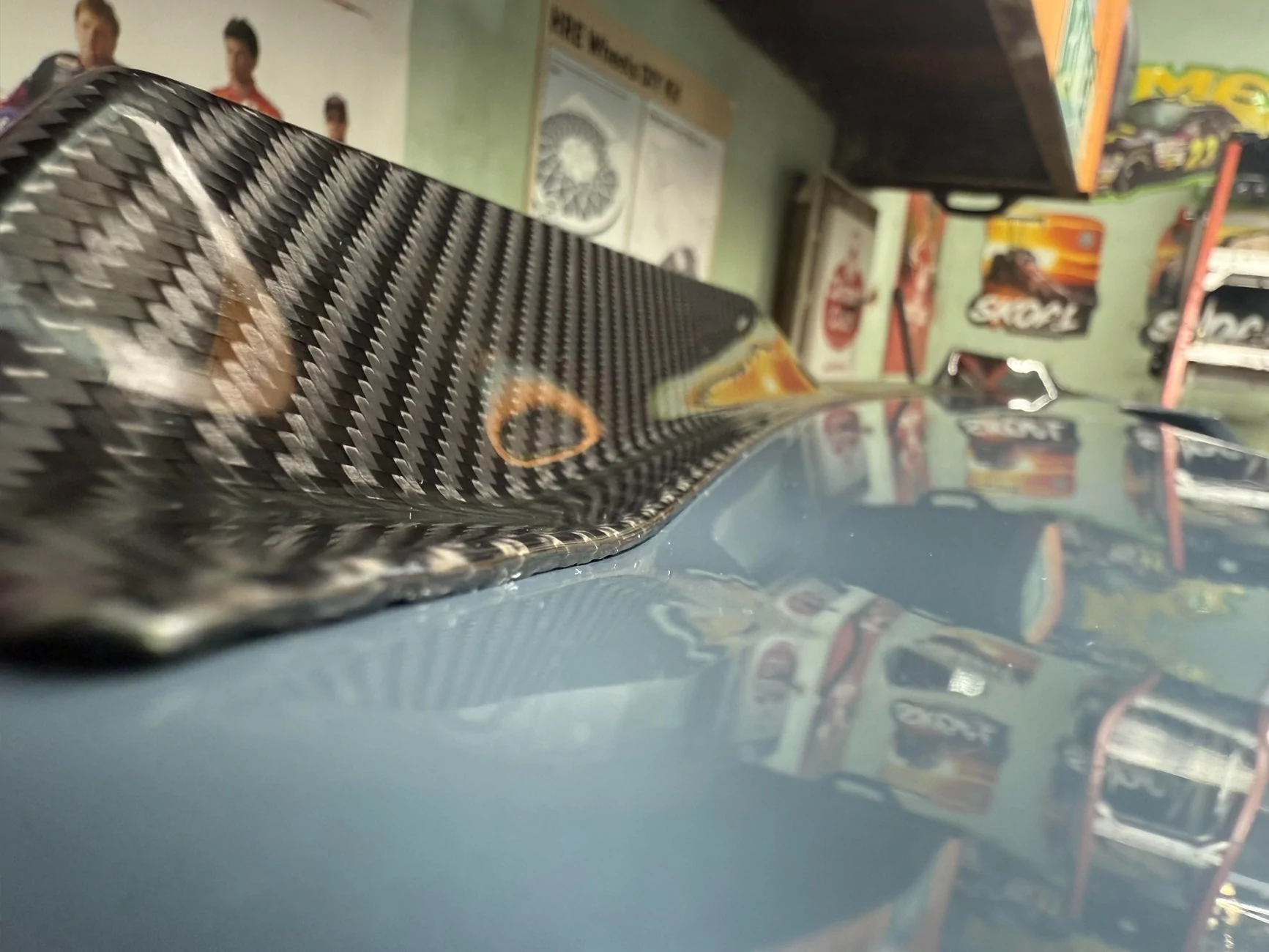

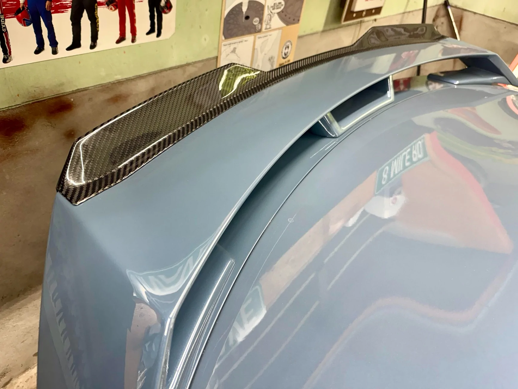

I'm reaching out to see if anyone can provide some insight on what all-weather adhesive would be best to secure a carbon fiber gurney flap to my S650 PP spoiler. I'm looking for an adhesive that is more permanent than 3M strips but not strong enough that it will damage the clearcoat/paint if taken off. I've had the NYTOP CF gurney flap installed on my S650 for the last 2 years, the gurney flap is still in great condition after daily driving my car in Michigan, however the 3M strips that hold the gurney flap to the spoiler are starting to deteriorate, and because of this the gurney flap is currently mounted on the car pretty loosely, enough to where it will definitely come off if I take the car on the highway. Since the Woodward Cruise is coming up, the last thing i want is for the gurney flap to fly off on the way there, so I am reaching out to better understand what type of adhesive would be best to secure the gurney flap that will withstand Michigan's temperature fluctuations, weather variables, and also strong enough that the gurney flap will be secure but not permanent enough that the adhesive will damage the paint if i decide to remove it. After a little research it seems like Permatex 81158 (general purpose silicone adhesive) would be my best bet for an adhesive, however i am no expert in adhesives and would rather seek insight on different adhesives and applications before applying the Permatex 81158 and potentially ruining the spoiler. Thanks in advance for your input!

I would not have guessed any adhesive strip could hold on for 18 years, that's impressive! When installing i did prep the surface with both diluted isopropyl and the adhesion prep. The issue with the gurney flap's design and their use of adhesive strips was over time grime would get in between that flanged part of the flap that meets the spoiler, and the thickness of the adhesive strips left enough room for dirt and moisture to get into the flanged part, so over time the strips lost their stick since they were exposed to the elements. Suggesting to apply a bead of Permatex around the perimeter as a weather barrier is a great idea but since i am by no means an expert i was worried about how good the bead would look with my skill set. So I went ahead and removed the 3M strips completely, applied a bead of Permatex across the entire inside of the gurney flap, and not only is the gurney flap rock solid but it now fits near-flush onto the spoiler where there is a much smaller chance of grime to get in between there over time. Yes, there is still a chance of grime getting in there since i did not apply an external bead but the gap in between the flap and spoiler is near minimal now. I did not think the Permatex would bond as well as it did, but it's ideal for the fact that I know the gurney flap won't come off while driving, but at the same time if i ever choose to sell my car the next owner better like the gurney flap because it doesn't seem to want to come off anytime soon. Time will tell on its adhesive capabilities but for now I'm actually quite satisfied with how the Permatex turned out. I wish i had a before photo showing the gap but the photo attached shows how it now fits when using a bead of Permatex on the inside only.
