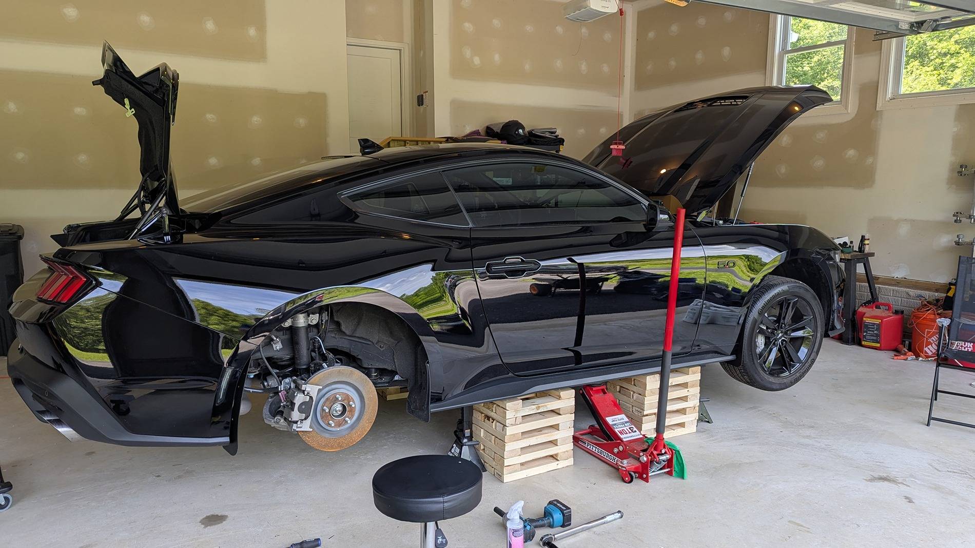

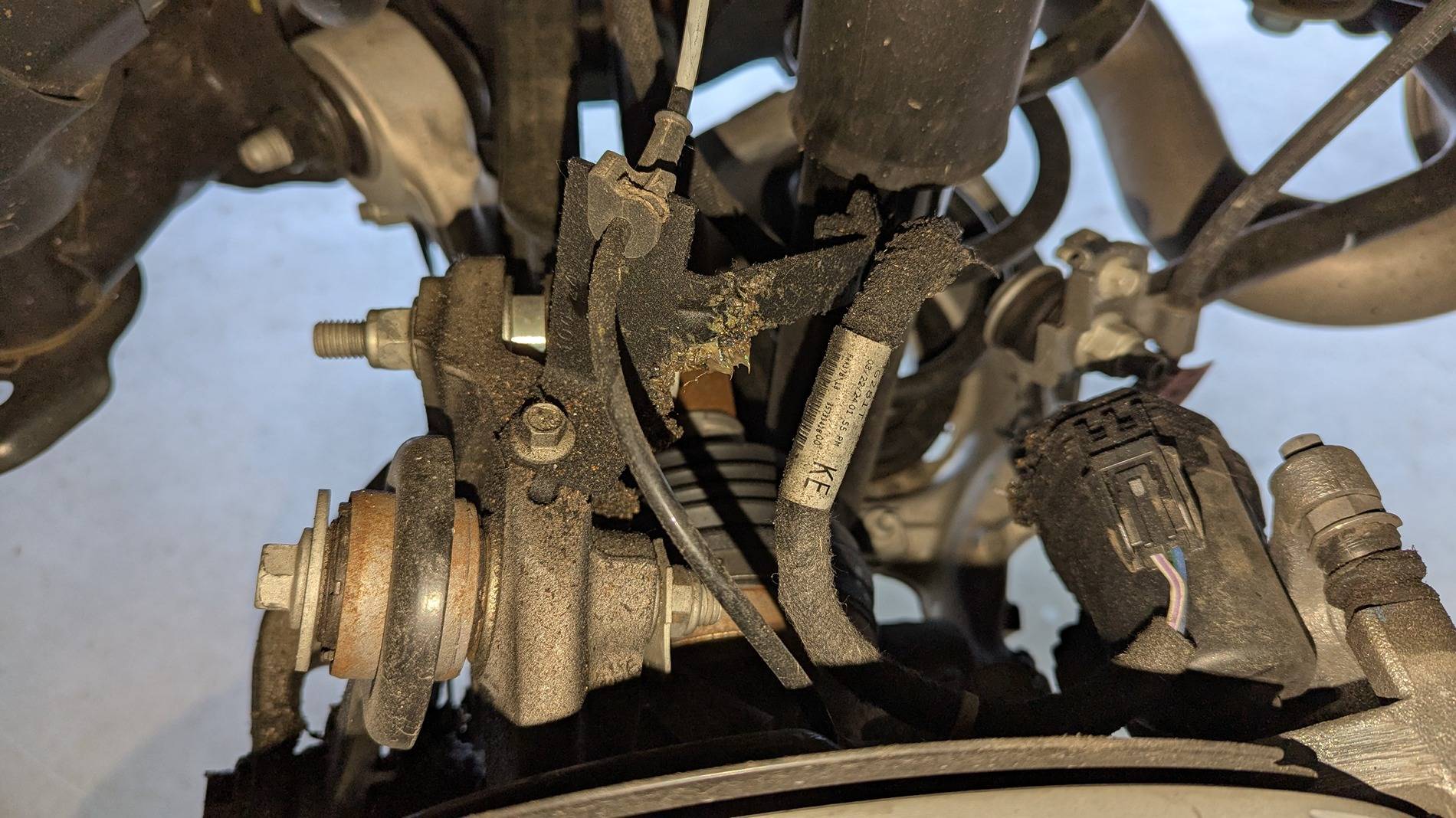

Put the car up on blocks to do the suspension mods and when I took off the driver's side rear wheel I noticed a lot of grease flung around. Now have to put it back on the ground and drop it off at the dealer, hopefully a quick fix. 5500 miles on the clock, don't do burn outs or track time.

Mine had similar, issue was rear outer drive shaft boot was damaged.. they replaced whole driveshaft 4 week wait for part

Literally same thing here. Mustve been a blind kid doing the assembly process at the plant. I found doing the stop the hop kit and already did the passenger side before I found out about the grease so I just finished the install. Praying the dealer is cool

Happend to me too. Grease on the control arm and flung everywhere. Drift brake harness was chaffed bad too. So dealer thinks it was from something rocking them both and getting stuck. Not sure. But they warrantied the axle and harness.

Probably a CV boot leaking. A simple repair. I've never had to replace axles when doing it.
