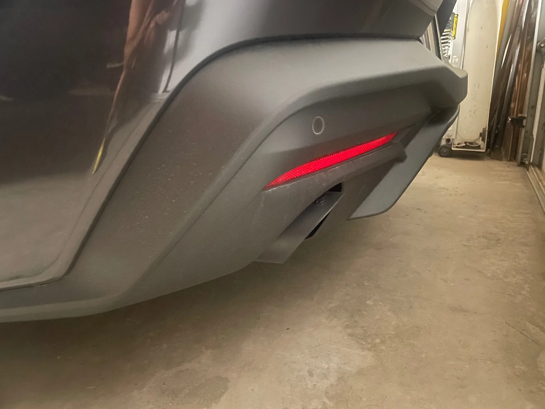

I have an S550 Roush black dual tip axle back on my S650. It’s more of a straight through resonator style. Not overly loud except cold start up in my garage. Compared to other mustangs, including active exhaust vehicles like my son’s S500 without a resonator delete (x or h pipe) it’s relatively quiet. So you definitely won’t be the loudest mustang around. I bought it as new old stock (never installed) a couple years ago for under $500.
If you want quad tip, Roush makes them now, and you can get a template to cut the existing rear valence in case you don’t want to buy a new one.

How’s the interior noise drone etc? I found a set for a S550 pretty cheap that’s in like new condition. How’s the fitment? Somebody else commented that the tips didn’t stick out far enough since it’s designed for the S550.
Interior noise isn’t that bad. They’re really not that loud. My son’s stock s550 with active exhaust is louder. I’ve been tempted to get an H pipe and feel there’s room in the volume of sound, except for cold starts in the garage. I live in a nice neighborhood and don’t want to draw the ire of my neighbors.
Fitment isn’t bad they stick out just fine for me. They seem to be stock length, but I could see someone wanting them longer, but not me. I like the fact I was able to get the black tip ones and with the way they fit, they look stealthy as my car is dark gray.
