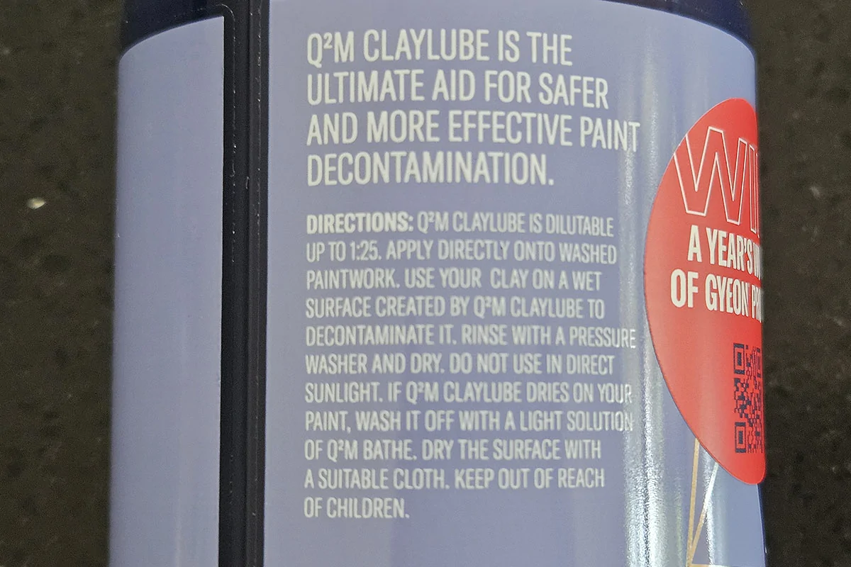

Thanks guys.
It also helps if you look at the actual bottle for directions. :facepalm:
S650 Mustang Aussie S650 Paint protection and detailing thread 20251024_153958_1200
... as I did the following day.
Mixed it up 1:10 into a Dilute spray bottle.
It came up well after my 1st gingerly attempt.
No photos - too busy with the job at hand.
Mostly went middle of the road using F6.01 and a yellow pad.
Supermarket car park scuff mark along the door came off with H9.02 and yellow pad.
Quite happy with the result.
I think some Collinite 845 wax is next.
I now also fully appreciate why one might lay an old bath sheet towel down along the scuttle panel and over the wipers!

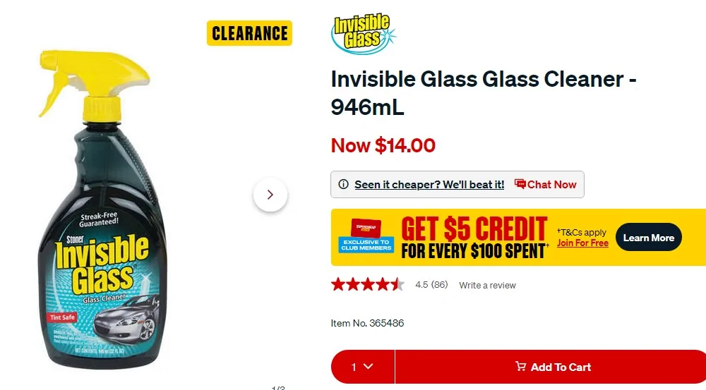

Clearance?
S650 Mustang Aussie S650 Paint protection and detailing thread Screenshot 2025-10-27 185938
I'm getting low on this and was checking my local SCA stores for stock, but this is the situation:

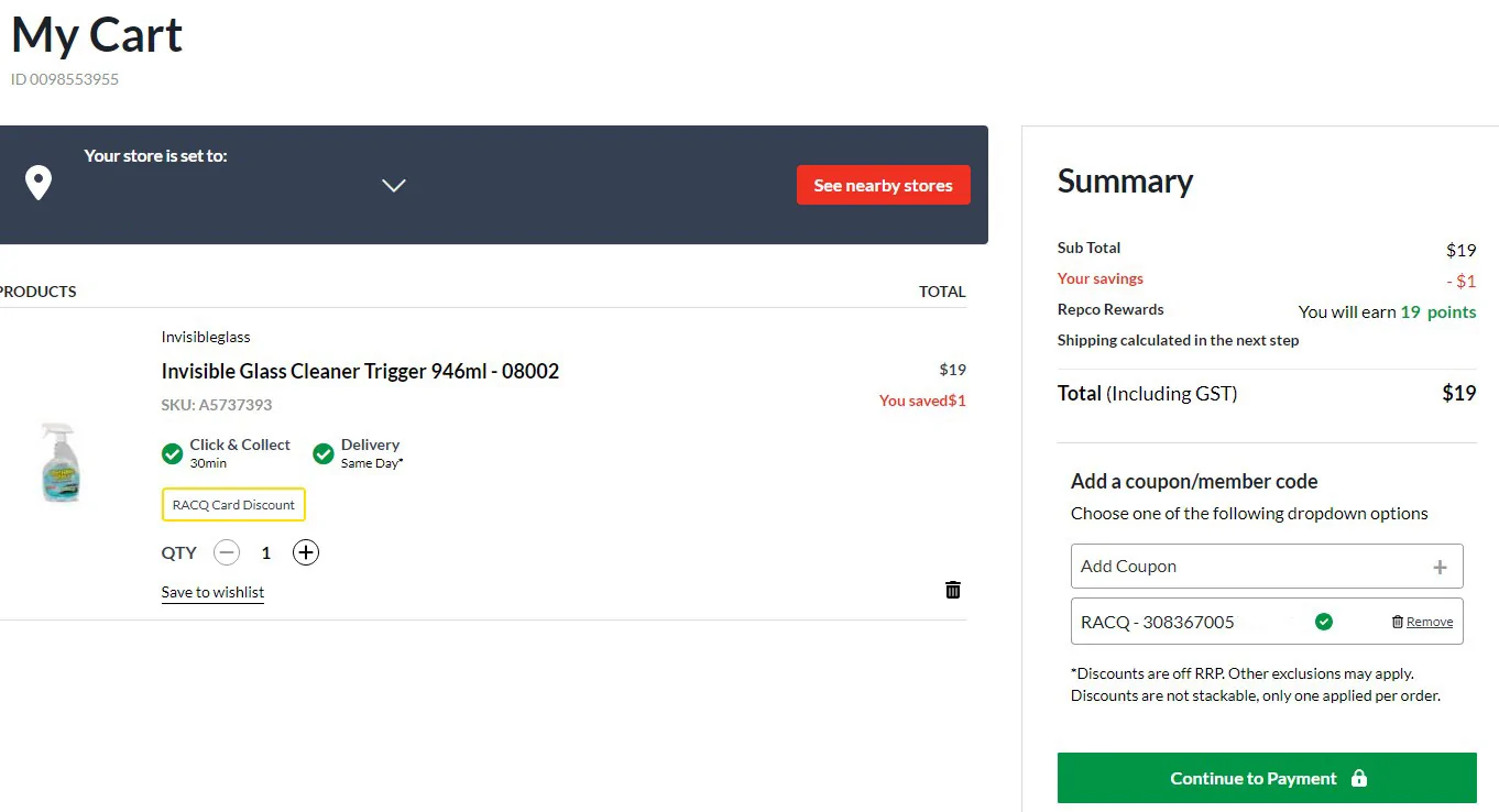

At least it comes down to $19 with your RACQ etc membership.
S650 Mustang Aussie S650 Paint protection and detailing thread Screenshot 2025-10-27 192444
:whew:

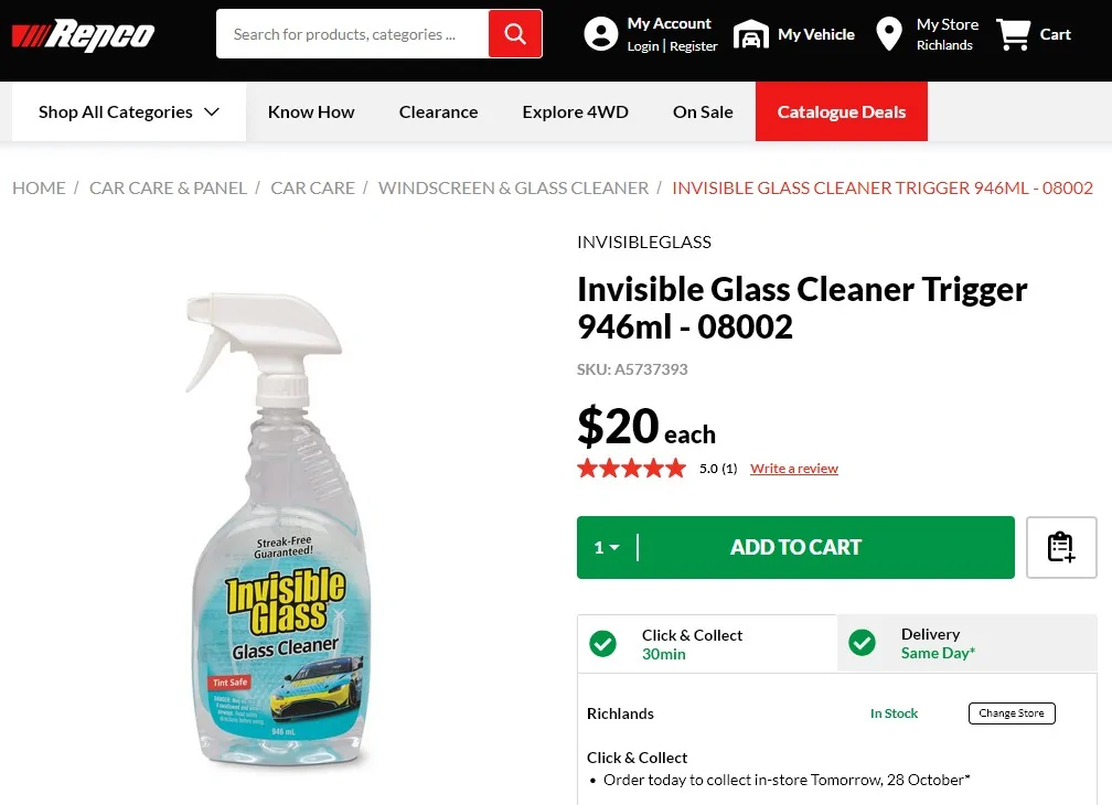

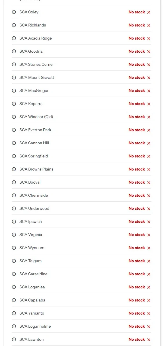

Clearance?
Autobarn stores have nil stock at the higher price point of $17.99.
Most of my local Repco have it in stock but at $20. :curse:
Aware of the stock situation and gouging?
Detailing shed - out of stock.
Car Care Products - in stock
Time for a panic restock!
:whew:
Why would SCA be clearing out such a good product?
Does not make sense.

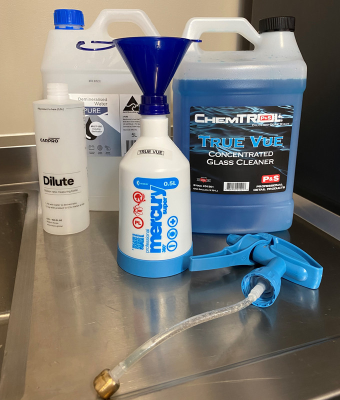

Suitable replacements? The closest I've found is P&S True Vue, which can be bought RTU or as a concentrate in gallon form. Problem here is, the RTU is similar money, but comes in a smaller bottle. The gallon will mix up many, many litres of product though.
P&S True Vue Glass Cleaner Tint Safe Professional - Detailing Shed

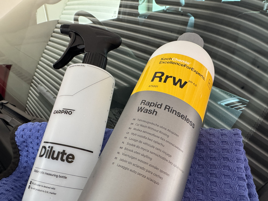

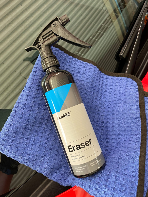

You could also use something like Carpro Eraser, which works well and smells amazing................. but is also more expensive.
S650 Mustang Aussie S650 Paint protection and detailing thread IMG-1705
S650 Mustang Aussie S650 Paint protection and detailing thread jun75
At the moment, I'm not actually using a specific glass cleaner. Instead, I've been loving Koch Chemie RRW (at 128:1), ADS Hero (at 128:1) and Carpro ECH20 (at 100:1). These have been working so much better than any of the dedicated glass cleaners, from Invisible Glass and True Vue, to virtually useless BH Trace-less snake oil. When mixed with demineralized water, those products average out at $0.60c to $0.70c per 500ml dilution! RRW is my favorite.
Koch Chemie (RRW) Rapid Rinseless Wash | Rinseless Car Wash – Waxit Car Care
ARMOUR Detail Supply HERO Rinseless Wash - Detailing Shed
CARPRO ECH2O | Waterless Car Wash and Rinseless Wash with SiO₂ Gloss – Waxit Car Care

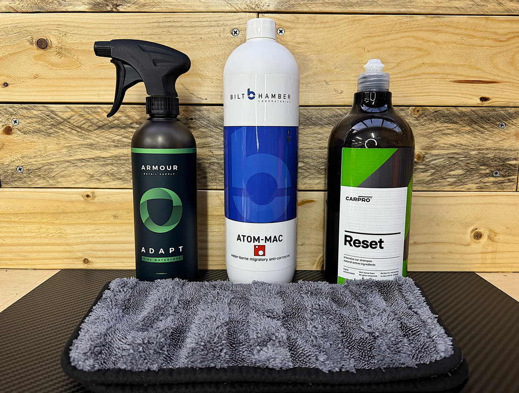

An eclectic mix used on the Mustang today......................
S650 Mustang Aussie S650 Paint protection and detailing thread IMG_8116
Working left to right -
ADS Adapt - Used as a light drying aid to mop up remaining drips of water after blow drying. Great on glass and door jambs too.
Bilt Hamber Atom Mac - Applied to the brake rotors after cleaning the wheels, then again after the final rinse/before blow drying. This stops flash rust forming on the rotors, turning the freshly cleaned black wheels orange.
Carpro Reset - The best soap on the market! Used as a wheel cleaner as well.

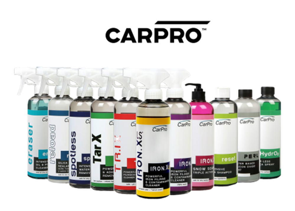

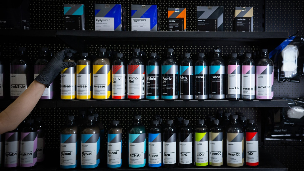

Yeah yeah, new labels, so what? Actually, back when Carpro hit the market 2010, the detailing market was vastly different. Firstly, there was less competition, especially at the premium end of the market. As more and more ceramic coating-based brands came to market, Carpro needed to ensure they stood out. The products spoke for themselves, but the way Carpro presented their brand was a breath of fresh air.
S650 Mustang Aussie S650 Paint protection and detailing thread carpro-products2
To start, they stepped away from the traditional bottle designs and the overly crowded, messing looking labels. In the early days, that meant clear plastic bottles teamed with a clean, simple and colour coded label layout. A few years later, they transitioned to a smoked semi-translucent bottle in 500ml and 1-litre sizes, as well as a unique 4-litre bottle. This coincided with a new label design that has been on the market until now.
S650 Mustang Aussie S650 Paint protection and detailing thread cpc1
S650 Mustang Aussie S650 Paint protection and detailing thread cp3
Those outgoing labels were what drew me to the Carpro brand. It looked fresh, clean, easy to read and recognise. The form factor was high, backing up the functional excellence of the product itself. Brand presentation then became a priority within the industry, especially for companies aiming for the same pro-sumer customer. I'd also say with the introduction of these new brands, the fresh look won over younger detailing enthusiasts who wanted something more modern than what the high-sock Corvette crowd were using.

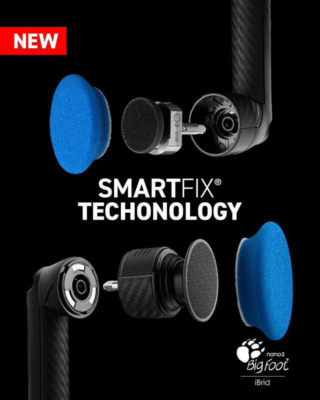

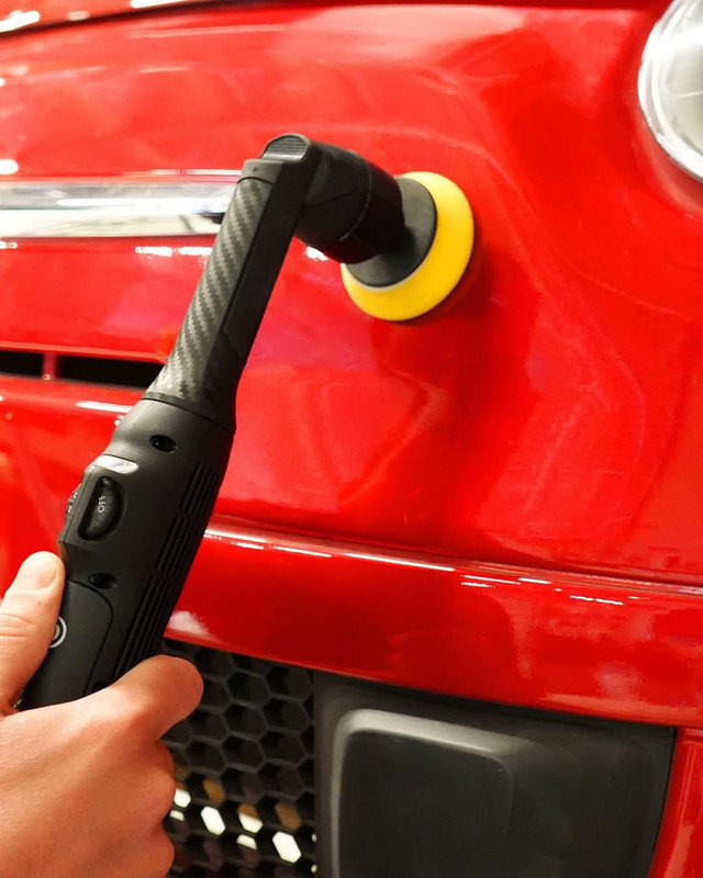

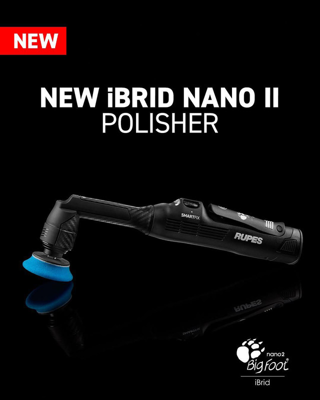

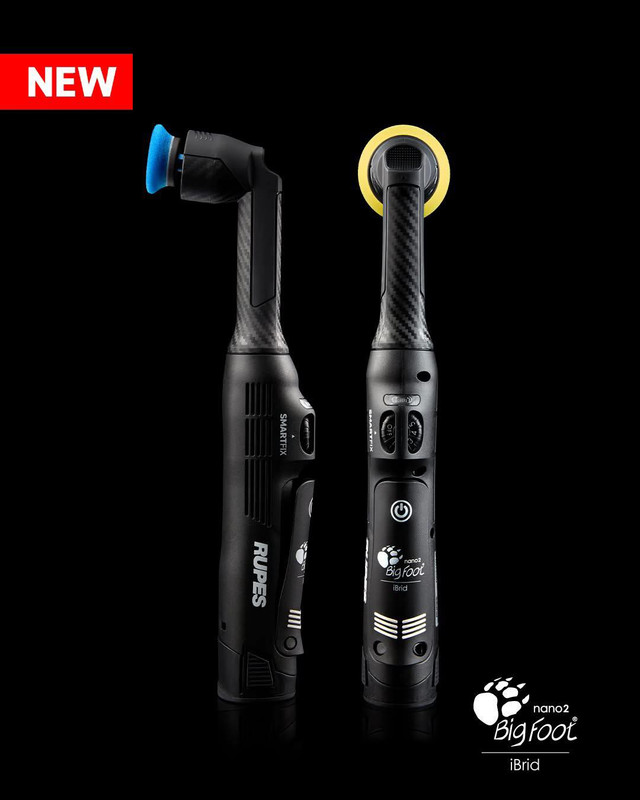

The second generation iBrid Nano was well overdue. The original was a pioneer in this sector, but its fallen behind as new interpretations have come along. I think the original was perfectly proportioned, especially the long neck type. The latest new Nano sees a significant improvement in a few key areas -
- Increased power and torque, to the point where it can handle significant downward pressure, which was a drawback of the original.
- The ability to fit the larger backing plate in rotary mode, the previous one was restricted to the small backing plate. There will also be a 3-inch adaptor in the future.
- Increased battery capacity. You can also use the previous generation batteries, just at reduced machine output. The original a/c power cord will work too.
- The quick-change head system is seriously impressive. The original was a pain to change the movement adaptors, a fiddly process that required using a special tool and a lock button on the head. These ones lock in place with a magnet.
