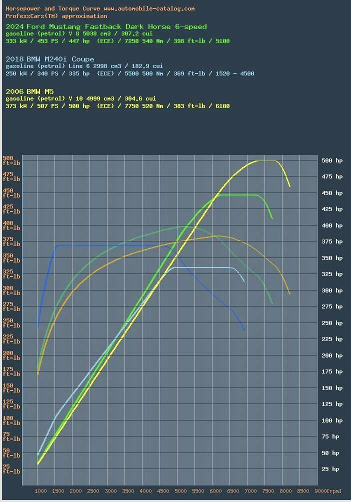

I'll keep my reply to the point ...
When i joined this forum (after ordering my car) there was quite a few comments / complaints about the throttle response and how it was sluggish and lazy.
With people recommending 'throttle commanders' that alter the throttle response curve.
This was not my first impression when in normal and sport mode but in slippery mode it was and thats what you want.
When the weather finally warmed up and dried out i thought i'd try track mode to see if that was the spark that had been missing only to find it lazy and lack luster. I certainly did not expect a car to slow down when you put it into a more aggressive mode.
Being an automotive powertrain engineer i ran a few quick experiments and shared what i did on here so others could do similar and contribute.
There was a chance that my car had the wrong throttle map but seems others are having the same experience.
There are many nuances to throttle control on a drive by wire system that is significantly different to mechanical linkage throttles.
There is the throttle curve (including range) where pedal position translates to torque demand.
Sportier modes tend to start lower (more engine braking) and have a steeper ramp initial ramp upto around 90% torque demand and then a gentle tail off for the final section.
This means if someone only half presses the throttle it feels fast, and there is fine control in the last half of the pedal to balance the car.
The other part is the response to step input changes.
Sudden changes in throttle demand are damped in normal modes to make it less jerky, sportier modes reduce this damping and a track mode i'd expect there to be none but it felt more damped not less.
As previously mentioned i used to have a V10 M5, the power / torque curves are actually surprisingly similar it just rev's even higher. I'm not sure if that car had shorter gearing or not but it had far more initial punch to the point you had to brace yourself going full throttle in second else it would throw you back in your seat hard enough that you lift off a little bit of throttle.
That's the sort of adrenaline rush i was hoping for, guess i'll have to supercharge it to find out.
As for M2 no thanks not a fan of the looks but for ref my colleagues M240i that pulls harder / faster than the DH and it has over 100bhp less.
Edit - added the power and torque curves for the 3 cars mentioned, note you really feel that extra 100fb-lb's at 1500rpm

A couple of comments
I think I read that Ford make the track mode throttle map linear for more control so not as aggressive as sport mode. This is deliberate for modulation on the track rather than a 'sporty aggressive' feel.
The power curve you see there is for the European model I assume - it flat lines at 450bhp. For those moaning about European DH cars having less power the only difference is that US cars don't have the flat line and go on up further - but this is only important over 6000rpm, so track use really.
