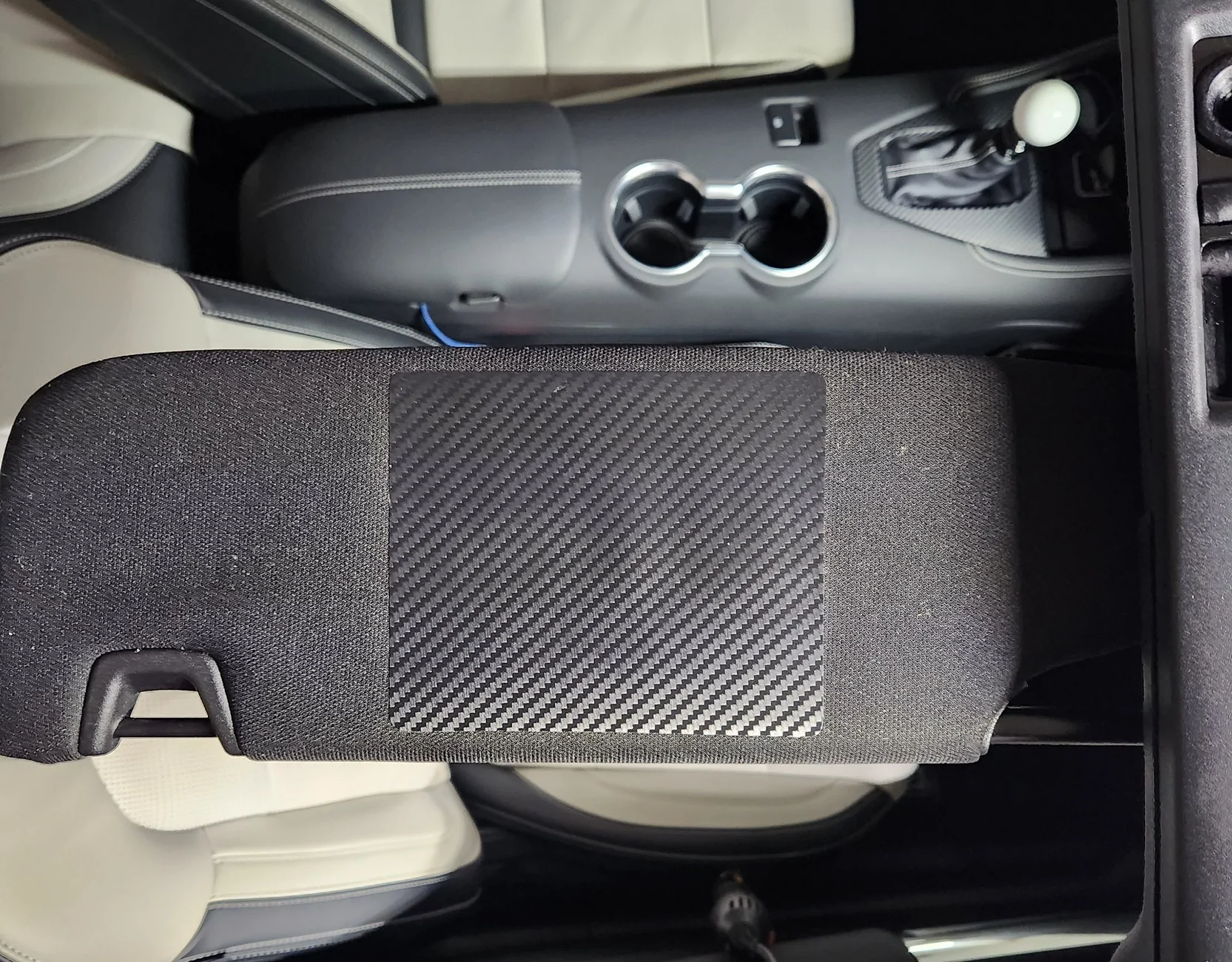

I used a heat gun to remove the warning label - naptha to remove the glue residue
I cut a piece of carbon fiber vinyl wrap - 4"x5" - for the cover.....
cost - "free", as I already had the wrap from another project

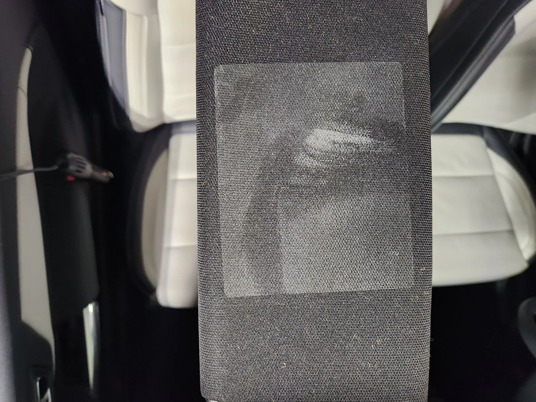

I gave it a try and ended succesfull. I used heat gun, alcohol, gu gone, iron (with cotton cloth in between). At the end, after Gu Gone, I was successful using a last heat gun shot as it burned the adhesive residue.
I do believe the heat gun is very very risky as it's easy to burn the sunvisor cloth, do it at your own risk. I was open to have to buy a replacement in case of emergency.
